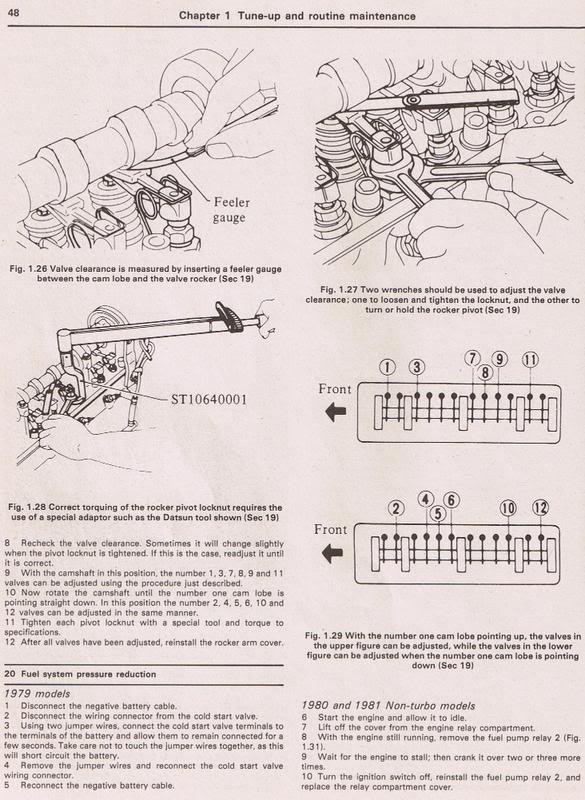

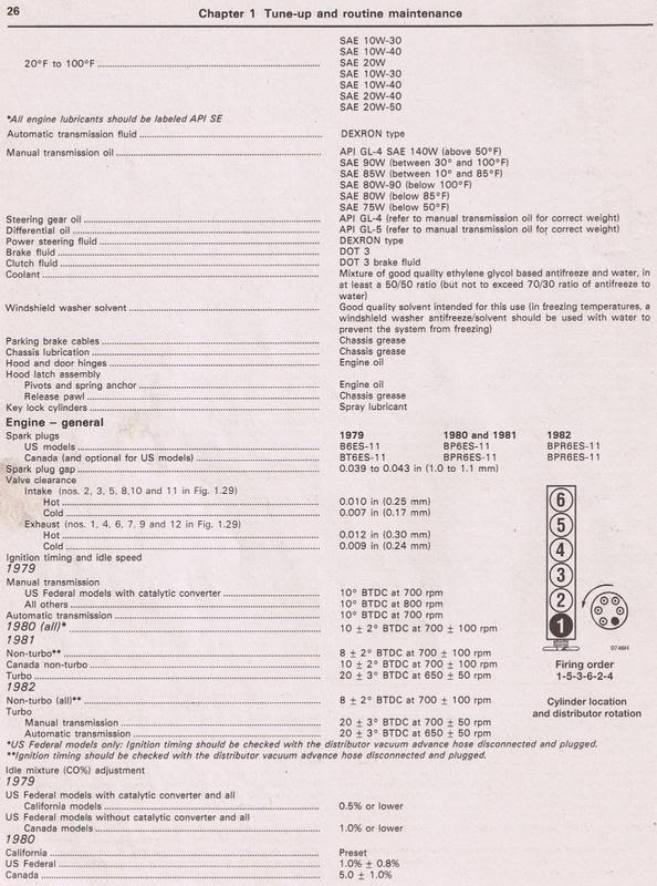

I need to know valve adjustment spec on a 1979 280zx ???? can anyone help me ????

Turns out that if you buy a Haynes Manual or download the FSM from www.xenons130.com/reference then you will have tons of very valuable information right at your fingertips. Cool aye?
