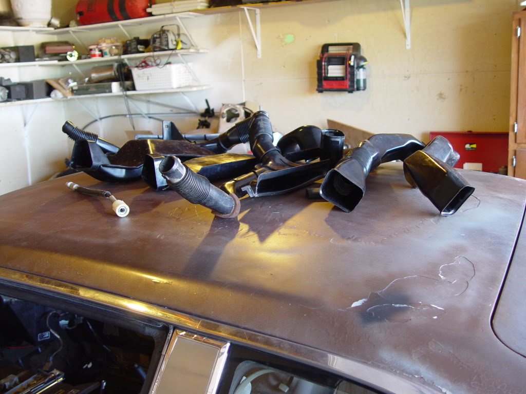

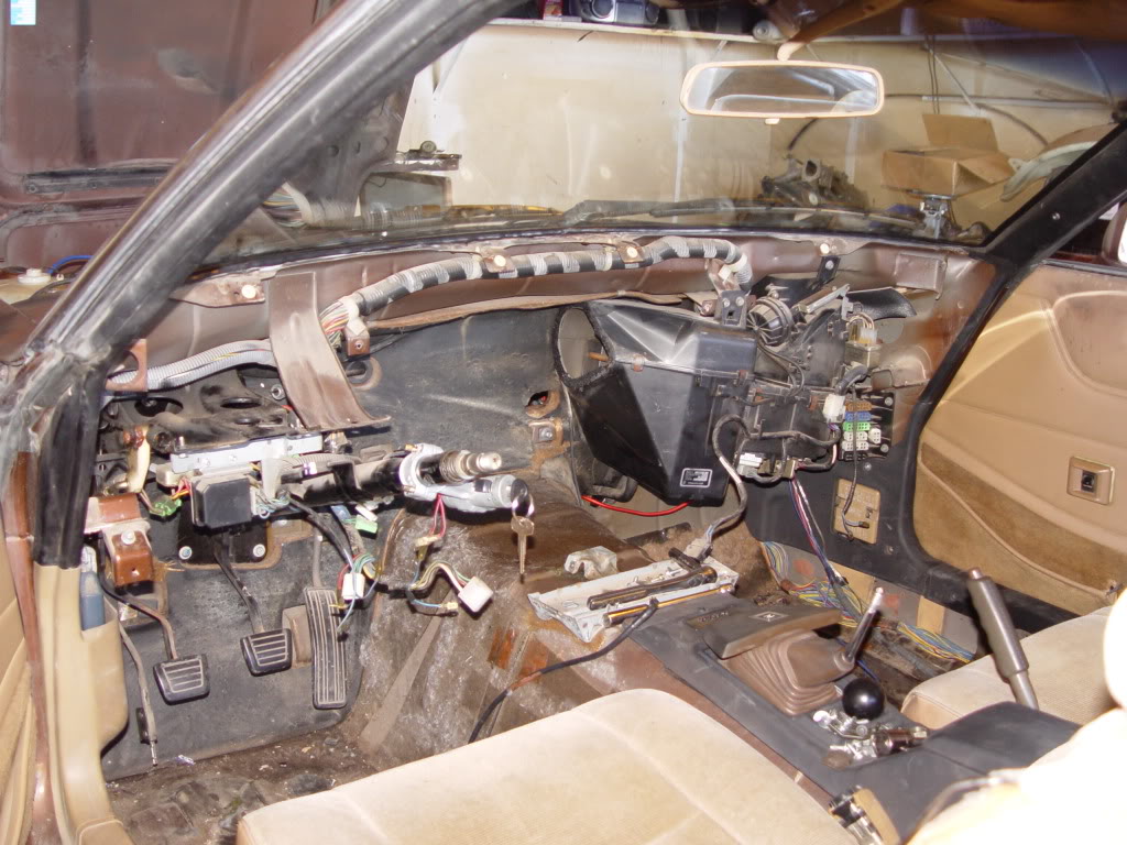

lol ya it was a pain. Whats worse is the mess of vacuum lines under there! I have them all marked but geez is there enough? I almost thought of bypassing the heater core and not putting it back in for now so I can still have my Z back!
And 30 years of dust is nasty. but their cleaner now

^ You might regret doing that. I did, when I decided not to put all my duct work back underneath the dash. When it got to winter, I was freezing in my Z, with no heat. lol I was used to the summers without a/c. But the winter is kind of tough. And yes, it does get cold here in the desert of Arizona. lol
