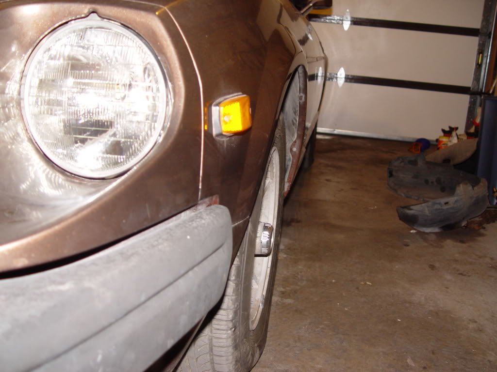

I feel like showing off my Z again lol Tho its nothing pretty to look at

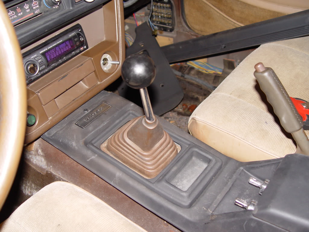

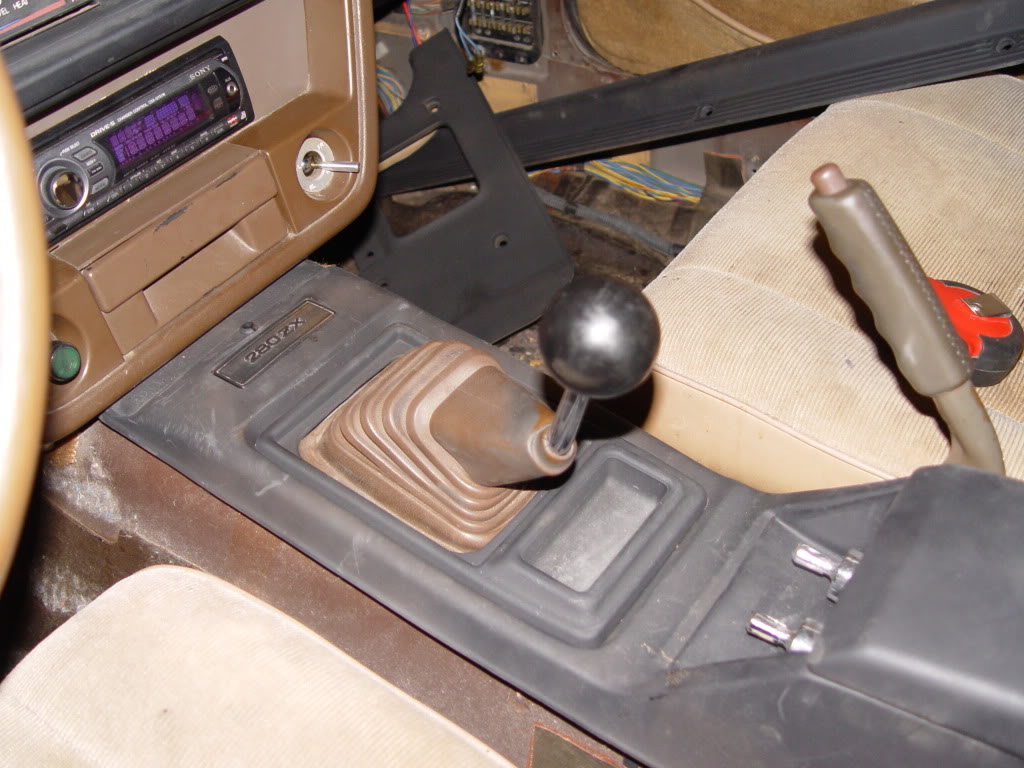

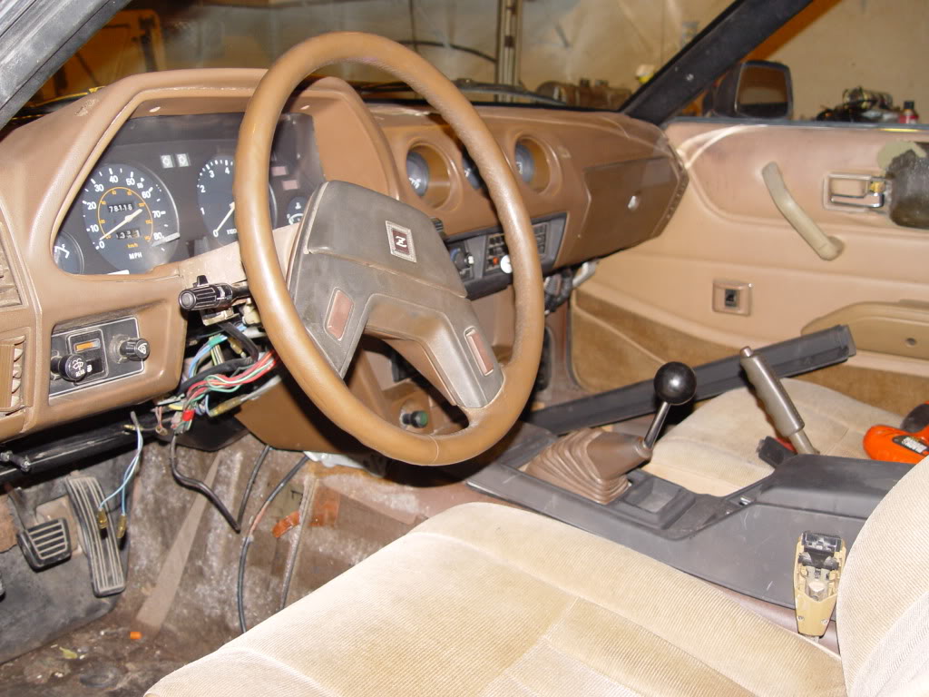

I'm not to sure I like the shifter I got
1st

N
2nd

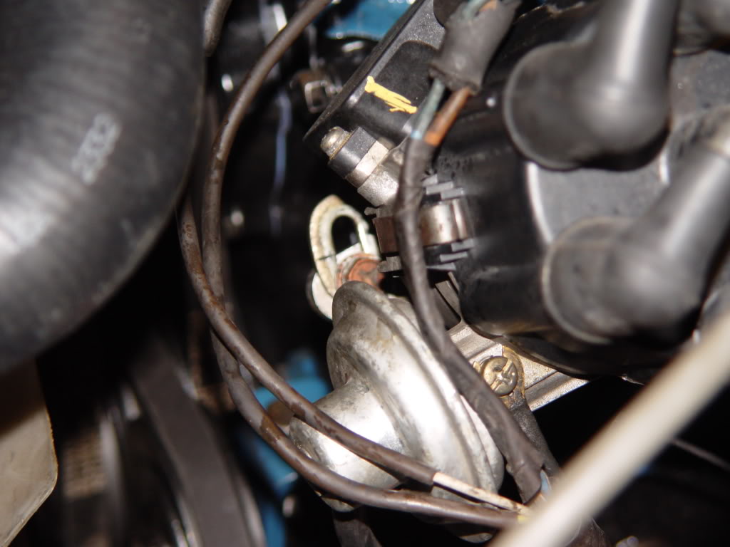

Oh and see I notched the dizzy! it works great too!

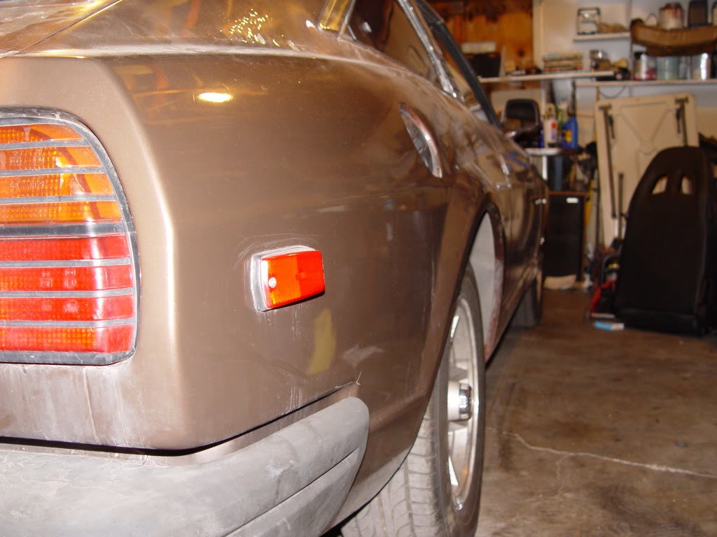

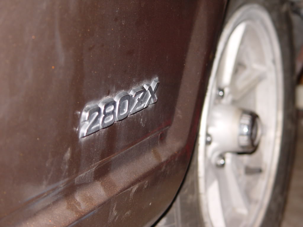

Heh I was trying to do some cool body shots but I'm not so good with my camera anymore...

Yes my Z needs a bath lol

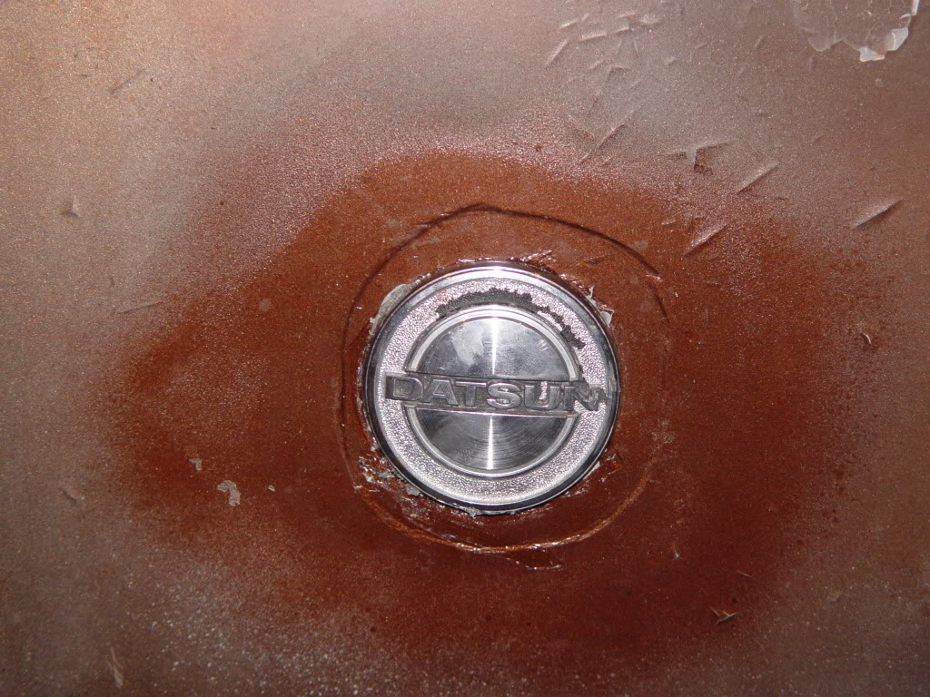

Datsun!

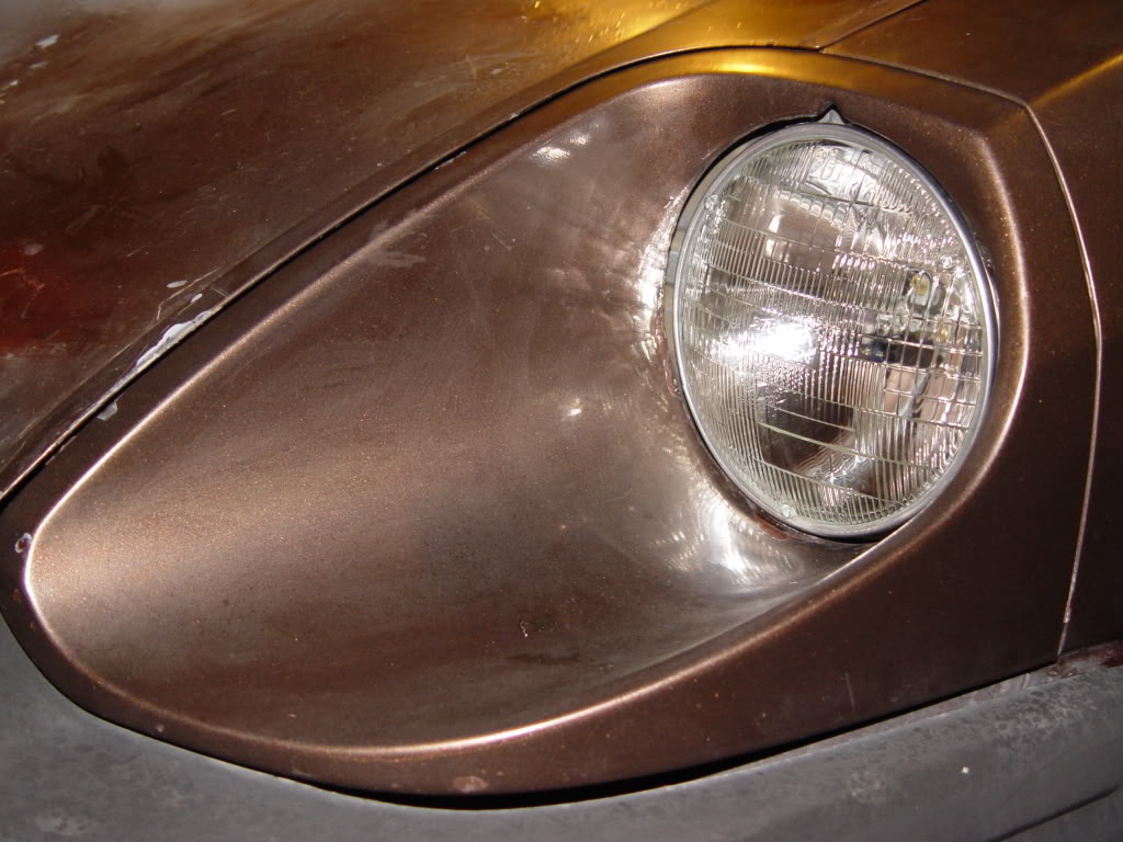

I love the headlights on the early Zs

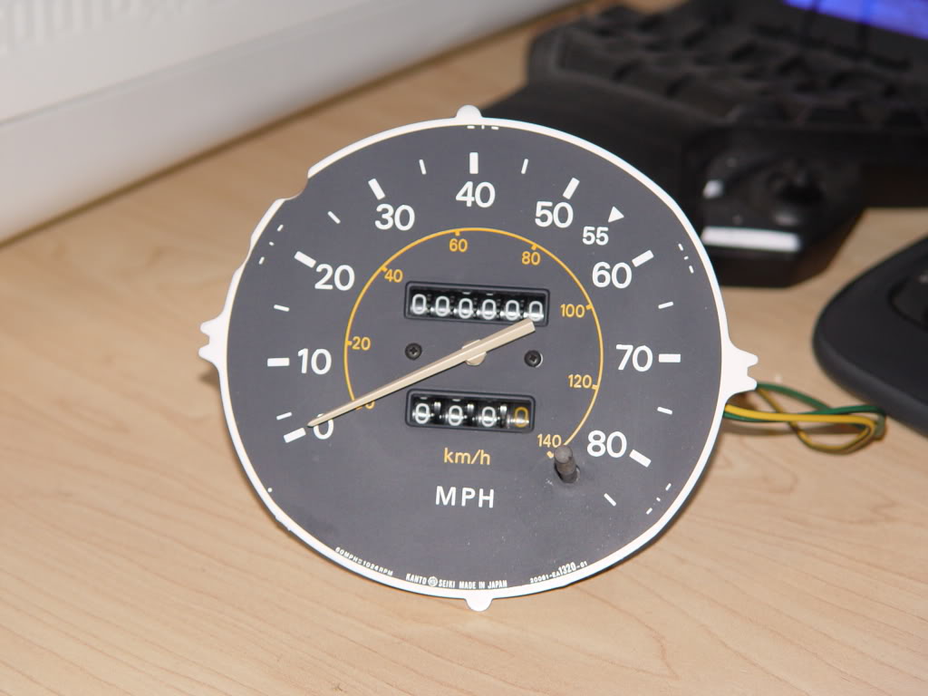

And it should be known that I now know how to rebuild 280ZX speedometers!
I think I'll do a write up on this if no one else has yet. Its actually not that hard lol
From my tinkering w/ the 280zx speedo's, you just pull a retaining pin, lift a bar, and spin the dials back, right? I never installed one back in a car after spinning it to zero, mainly because I didn't want to take the chance at getting busted for altering the odometer. Though it should be fine if you plan to keep the car forever.

Well pulling the pin out and spinning the gears is only half of it, you need to make sure the gears are still timed right else the thing jams up and started breaking stuff lol that and to use the right oil on the rod and gears and make sure the pin stop is in the right place and lotta little things
And If your car is exempt from odometer requirements it doesn't matter lol
