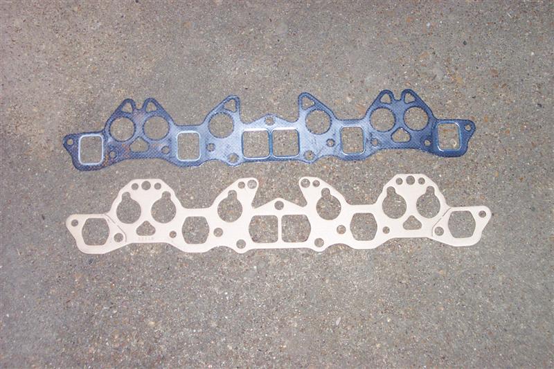

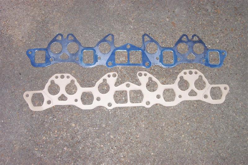

well I did buy one at Autozone. And it cost 12.00 and something. Look at the bargan price item, Fel-Pro against the one from Nissan for my 260Z n/a.
The Nissan one is higher quality for a naturally aspirated engine, I want the same quality for the turbo car.
The Fel-Pro is mostly cardboard and thin
Nissan is asbestos and metal and thick
Fel-Pro has diamond shaped exhaust
Nissan has square shaped exhaust. Just want the best one for when I finally come on boost. That cardboard gasket looks cheap.

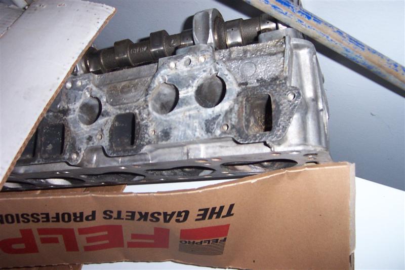

The turbo car has square exhaust ports. My spare P-90a. The gasket should be for a square port cylinder, not diamond shaped.
Picture shows diamond shaped gasket was used before, on this head that I bought off ebay, the guy said it had been reworked??
I will post pics of turbo gasket, hopefully with square ports.

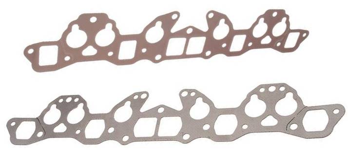

You're right on that same part number. I looked up an aftermarket gasket from importedcarparts.com
they list the 1982 280ZX turbo and non-turbo as the same gasket part number. They even have a picture. The bottom gasket with the diamond shape would be for all 1981-83 turbo and NA. (at least those years, maybe more)
The top gasket is for the square port heads from 1974-76. I can get those with steel liners... should I try one on my turbo engine? it almost seems like the gasket material doesn't matter if the same part is used on the NA

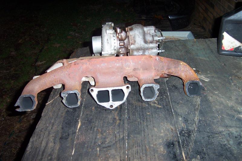

The gasket will not fit. I took the exhaust maniflold off yesterday and while the head has square ports, the exhaust manifold had DIAMOND ports!
The one on the bottom is the only one that will fit properly.
look at this picture, it is of the turbo exhaust maniflold ports. diamond shape, square will not fit.
