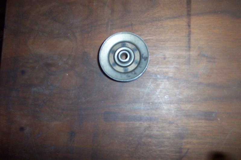

Gah... Long story short I think I lost a piece. I was forced to do it at night, since I can only borrow tools when the friends of my family are home. Since it gets real dark real soon... I had to do it in the dark, alone, with a tiny flashlight. I dropped this spacer inside, but with a little magnet on a stick...I got it back.. But I think I'm missing a dust cover. You tell me. I got all the pics of the stuff. Sorry to bother you guys again, but could you tell me if I got the right stuff? lol.

I think the dust cover is actually part of the bearing, which looks missing to me. My bearing was sealed, showing no bearing ***** (I said "*****", so lets all yuck it up ). Anyways, the new bearing should be completely covered on both sides. You need to take the holding clip out (thin needle-nose pliers usually work well for this, but be extra careful not to let it slip off the pliers, or it will shoot for miles and you'll never find it). Tap out the old bearing, tap in the new bearing, using a piece of wood against the new bearing, and install in reverse order of removal...
Old Jan 26, 2007 | 07:10 AM
actually it looks like his old bearing pix, the ***** are gone in that pic. it looks like you got all the pieces. i hope that isnt the new bearing! and yes the new one will be sealed.

Yep it's the old one. going for a new bearing today =)
