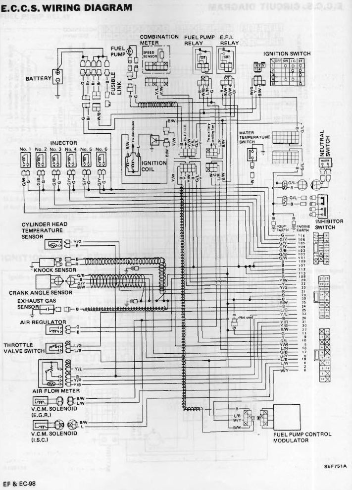

OK everyone is overcomplicating this. Replacing the cold start valve wouldn't do anything but keep it from running rough. Well that would be the case IF THIS EVEN HAD A COLD START VALVE! It's a turbo - they don't use the cold start valve.
First you need to figure out your fuel pump issue. There may be other issues to follow but lets get the fuel pump working first. You need to know how this thing works. There are some issues with the schematics but if you look at the Wiring Diagram for the turbo you'll see the truth - the ground for the fuel pump is supplied by the Fuel Pump Control Module whereas the other drawings don't show that the FPCM is grounding the fuel pump.
This is what I would do to trouble shoot it. Fish some wires through the fire wall to your battery and back to the fuel pump and hook it up directly. You can put a switch or relay in there but this is for testing purposes so you might not want to get that involved. If the car runs fine hooking up to the battery directly then you need to figure out if it's the positive side of the circuit or the negative side giving you grief. Jumper in one side of the circuit either by giving it 12V from the battery or grounding the other side. The positive side will be your fuel pump relay (and possibly the fuel pump control module as it turns on the positive side of the relay as well) and the negative side will be your fuel pump control module and/or the associated connections. If you can't figure it out from there report the results back and we'll help you along.
The fuel pump control module takes info from your optical encoder wheel, etc and does some more complicated control of the fuel pump to reduce audio noise, etc.

I will do that tomorrow. I had surgery so I haven't been on. Ill let you know what happens. Would I need a certain size of wire? Thank you for the help so far......Sometimes I feel like a brick wall.....

Im not getting pissed. I ran the wires from the battery to the fuel pump and it turned on. If I put the wrong key in and I turn it to on I can pull it straight out. I did that on accident a few times. I thhnk I might just wire in a relay or something and call it good if that is safe?

Well you're part way there. Hook the fuel pump up but on the ground side run a ground wire to the battery. Find out if that works and we'll go from there. You're half way there
