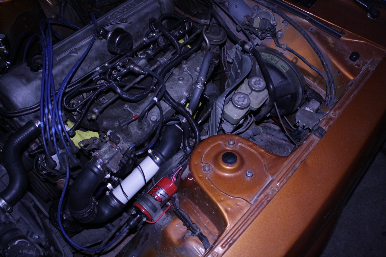

Hey guys, my name is Ross and I drive a 1981 Datsun 280ZX
The dash claims she has 194,xxx miles but the motor has been freshened up by one of the P/O's. My friend said he knew the guy before the guy I bought it from lol
Bought the car originally for 400$ because he couldn't make it run. (wanted 1300 for it)
Since then the car has seen plenty of little things here and there. I first bought the car with the OEM intake, I slapped a cone filter on (ricer status) and welded a straight pipe on the car. Eventually got annoyed of it being too loud so I got a muffler.
The car came with 2 broken exhaust studs, the first ones from the center of hte motor and I got those fixed at some point. IIRC I blew my welded differential which made me think about just throwing money into a turbo swap. Sure enough got everything, I spent 300+/- 50$ for everything lol
stock manifold, failpro e/i gasket, T3/T4 turbo from a friend and some shittastic home-depot piping that blew up on me not too long ago. I already have the new stuff sitting on my floor as of right now.. Vibrant oil lines (240sx kits fit perfectly fine) Stock fuel pump, I have a walbro 255 sitting around, stock FPR, Turbo injectors, uhhhh N47 intake mani iirc or something like that, still has EGR but has a plate put into it.
Recent pictures, I have some in the daytime but hte camera is in my car.. :facepalm:
everyone is extremely skeptical because the car is running on the STOCK N/A MAF + N/A tune.
but hte car runs extremely well, little rich when cruising but better then lean for me.
Boosting about 10 PSI and never leans out at 5.5K (which is where I set my rev limiter)
Also have a full MSD ignition system, 6AL box, 8910 tach adapter, and SS coil.
Rear tein lowering springs and kyb's from a S13 with the s130 top hat. Little things I'm missing but whatevers
Stock front springs, have KYB strut inserts in the garage.. got for free... muhahaha... not illegal lol
anyways, hey guys!

Welcome to the club. Like the down pipe - the intake piping scares me Have you though about running an intercooler? It's a good idea for the L series engines as they are prone to detonate and you'll make more power. If you want to make much more power you're going to need an after market ECU and bigger injectors.
This! haha

From what I've noticed the L28 motor flows too much for a generic .63 ar turbo with a internal wastegate. It'll boost spike all the way to 12-13 PSI and it scares me cause it's untuned so I'm not gonna push it until I get hte intercooler because it should drop the pressure just a tad

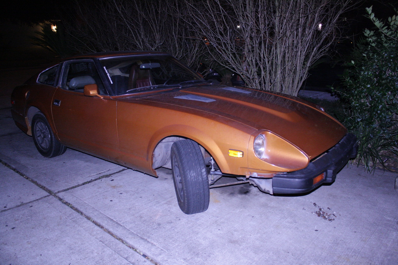

Recently my mom hit my door... :facepalm: she cannot drive for crap! She hit my brother's brand new FRS as well!
Overall the car looks better then when I bought it lol I blew up my daily set so I have these driftos on it

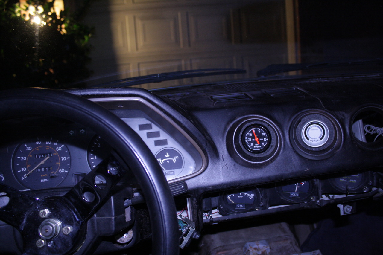

I have a free boost gauge, cheap A/F, and I need to buy a oil pressure gauge
then i'ma get 2 more and put them where the center air vents go, probably oil temperature and coolant temp
I need a radio too -_-
and I blew up a coupler so.. LOL

Don't run 15w40 - you're just making yourself feel better - not the engine. Run 5W30. You can use whatever oil you want - RP is good but there have been a few nightmare stories about RP and turbos but who knows. I've never met anyone who had a problem. Personally I like the Pennzoil Platinum. It has excellent VOA results (read up on Bobistheoilguy if you have countless hours and you can get it at Walmart in the USA for cheap cheap cheap! 95% of what matters about oil isn't the brand, etc it's changing it AND the oil filter regularly.
Spend some time hogging out the intake manifold runners - they are 53% the diameter of your intake valves. That's going to let your stock head breath better, turbo spool quicker, etc, etc.
BOV is a great idea - consider a BOV/Recirc valve instead - keeps your turbo spooled when shifting and essentially gives you more power.
Methanol injection works very well on these cars as well if you're looking for more power....
You can probably get a KA24 TB cheaper and they are 60mm - enough for all but the most extreme builds.
I know these two motors are not related by any means but my friend runs 10-40 in his KA and the same for an SR20, both are boosted and run extremely well.
I know the motor has tight tolerances which is why you told me not to run anything thicker then 5w-30, but during the summer I ran 5-30 and got the motor hot then popped the valve cover over to check valve clearances and they were perfect but the car still had valve tick I'm getting a BOV real soon not really worried about spool time to be honest, this turbo is small lol I need to port out the wastegate hole because it can't flow enough and causes boost spiking. If I do get a new TB i plan to port match the intake mani and tb opening so yes.
some of my friends have extra TB's laying around so if a KA one comes up i'll just jump on it
I was reading on this sub-forum about TB's and everyone was like you need this plate for this and that and I really don't like that. Then I came upon a thread where a SR20 one fits without any modifications besides the throttle piece.

Yes you'll need to port match the TB but it's the runners that are the restriction. Post some pictures of the SR20 TB once you get yours installed - I haven't seen that one before and it sounds like an easy swap
If the motor got hot figure out why it's getting hot. Running an oil cooler and a thermal plate is a good idea as well. The automatic turbos came stock with the oil cooler.

Is that...an injector...plugging the cold start line? Meh, whatever works, right?

Yes sirs that is indeed a fuel injector.. haha!
It was one of the NA ones that came out, I was a little puzzled on it but I'm guessing it's a aftermarket unit.
I read on a older thread that you can adjust the spring or something in the AFM?
Just wondering about the screw on the side of the AFM too lol.
I noticed that too... and a list of other "WTF?!" things. Well, it hasn't blown up yet.
So are you running turbo injectors?

Yessir, running turbo injectors on a stock fuel pump/fpr.
I have a walbro 255 sitting in my room and I am gonna save up for an aeromotive FPR
