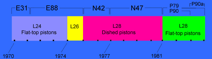

Originally Posted by 76 2+2
So there is no way to just run say 7 lbs of boost with stock internals? I understand outer accessories are needed i.e. exhaust manifold intake etc. Just out of curiosity, totally different make and model but I've had buddies who run low boost on 327's with stock internals is it the same?
No its not the same. Certian n/a L28's had dished pistons while others had flat tops. Meaning compression ratio. You could turbo a flat top & run low boost but its not worth the effort for the gain as you will be dealing with a low threshold detonation to boost curve. Your 76 if stock is a dish piston engine which also may require a head swap or thicker head gasket for comfortable compression ratio.
