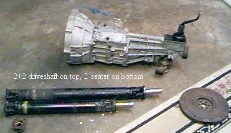

I did this on a Datsun truck with the 4-cyl L-series but here's basically what you do.
Remove Auto transmission and 'pressure plate' with ring gear and torque converter. Behind that is (whats it called?) some thing related to the automatic's ring gear. Remove it.
Install flywheel and clutch kit from a manual Z. Be sure to match the clutch to the type of flywheel you use. 2-seater non-turbo should be 225mm for both, and the 2+2 and all turbo models share the larger 240mm clutch.
Install 5-speed transmission with driveline. I've heard from some that the Nissan driveshaft for both matches; other sources say they don't. For me in the truck the auto driveshaft did not work. I got the driveshaft from a truck with a manual transmission. Keep in mind if your car is a 2-seater, you must use a transmission from a 2-seater. 2+2 must use same. If you swap in a T5 (turbo) then you need the same body length driveshaft from a TURBO car. Also, on a T5, the back end of the driveline is different. Unbolt the differential front driveline flange from the turbo car. This flange will work on both a 2-seat or 2+2 car since it is just a flange that the driveline bolts up to.
My truck's rear transmission mount worked fine from the auto to manual. I'm not sure what the Z has. As far as Nissan to T5 swaps, all you do is turn the mount around 180. When the Nissan unit is installed the mount sweeps forward. As you can see in the attached pictures, both mounts out of the car are the same. When installed, the T5 unit sweeps rearward.
On the interrior, the floor plate under the center console has a different opening size from auto to manual. Swap out the plate, same goes for the plastic surround around the shifter. (optional) a new shift boot is also optional, but to keep out heat, dirt, and noise you should use both a lower and upper boot.
Pedals: Remove brake pedal. I found it nessisary to remove the driver's seat and lay on my back in that area to look up under the dash. Even so, changing out the pedals is a big pain. Install cluch and smaller brake pedal from 5-speed car. Any body style or turbo/NA will do.
Remove 'plug' in firewall and install a clutch master cylinder. Hook this up to the clutch pedal. Remove clutch 'hydralic line' from 5-speed car and install along firewall of the auto. Same goes with the hose that hooks to the clutch slave cylinder on the side of the manual transmission.
Honestly, I've heard that the ECU and electroincs don't matter. Sure you'll still have the kickdown switch under the gas pedal. It won't do anything and you can remove it if you like.
As for my truck, the carburetor didn't care if it was an auto or manual.
Attached Thumbnails 280ZX Auto to Manual Swap Thread-trans1.jpg   280ZX Auto to Manual Swap Thread-t5_01.jpg   280ZX Auto to Manual Swap Thread-t5swap2.jpg   280ZX Auto to Manual Swap Thread-t5swap4.jpg   280ZX Auto to Manual Swap Thread-diff_flanges1.jpg

bleach, do you know if you still have that drive shaft? I am going to a grave yard here in a few day's. I like it. You have to make an oppoitment to get in, And your in alone beside's the owner. But he has quite a few Z's. I am gone see if I can find a 2+2 5 speed. But I think all his Z's are 2 seater's. And all have great body's. He has a turbo all it need's is the front suspension off another Z. It even fires right up. selling it for $200. My freind might get it and use the front suspension off my red 2 seater part's car. Only thing bad about the turbo is, It's an AUTO. no fun there. But Bleach, let me know if ya got it. I might be able to set something up.

I still have the 2+2 driveshaft but I'm planning to hang onto it for a while. That's something I don't want to have to pull in a wrecking yard if I need it. Those store in a small space too.
You jack the car way up. The transmission needs a lot of room to drop to the ground and slide out the side. I had the front higher than the rear by a little bit. I put the rear tires on wheel ramps for stability and the front on jacks.
Swapping the transmission is the hard part. You can do it in a day if everything goes quick and you have help to lift the transmission. I'm lazy and slow so it took me several evenings over 2 weeks to swap the T5 in the Z. The truck swap from auto to manual was not done all at once either. I took my time.
