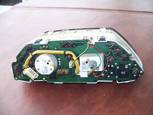

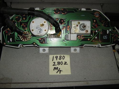

The cluster I pulled out of the 79 looks like this first picture with just the two plugs (one round, one Rectangle) for the stock wiring harnesses to plug into. But all of the ones I have seen for an 83 have the yellow pigtail like the second picture. What is the difference?

Anyone know what the yellow pigtail in post #4 is for?
I do know that it is very important. Because without it plugged in. Nothing much really works in the cluster. I just always made sure everything was plugged in. Probably could find out by looking up the wires in the schematics.

Then how can I use the 1979 130mph cluster when it does not have the yellow pigtail?
Old Jan 30, 2011 | 09:51 PM
You swap the speedometers, not the entire cluster. You gotta remove the clusters, disassemble, pull speedos, swap.
The 130 speedo plops right in place of your 85,
Old Jan 31, 2011 | 01:55 AM
Correct...I should have told him that. lol Yeah that is what I did with mine. I just swapped out the speedometers. It was a whole lot easier.

What are the 4 loose wires in your picture?
