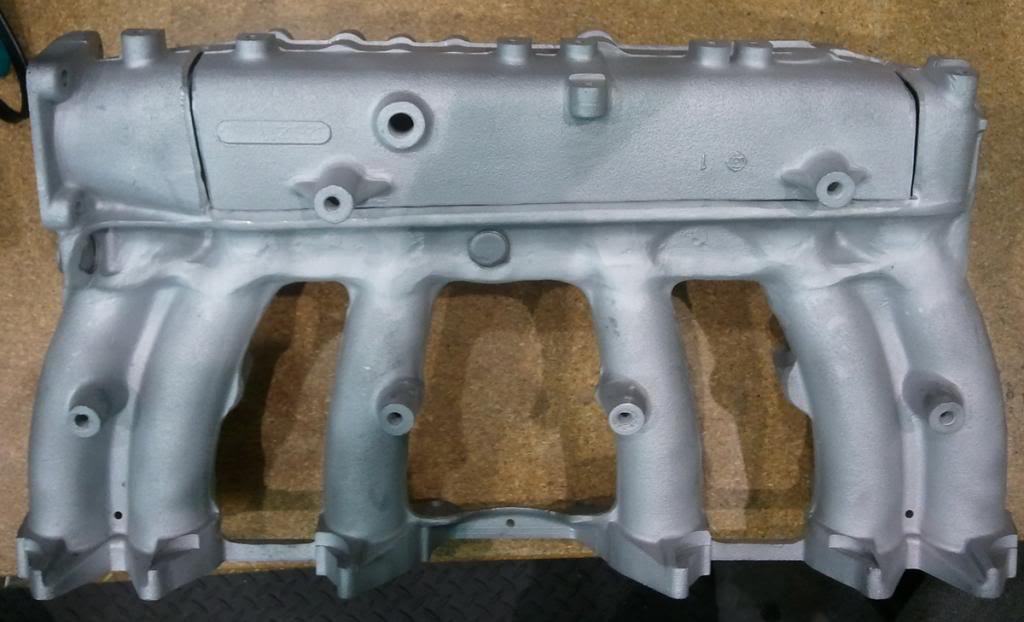

On the weekend i picked up a whole wack of FREE 280zx parts some of which include an r200 3.90 diff mint shape,n24 cyl head and valve cover,mint front fenders, a nice hood a back glass louver, rear control arms and a whole bunch of other things one of which is the W24 intake with custom fuel rail and the webbing removed, question is is the w24 intake good for a turbo application?

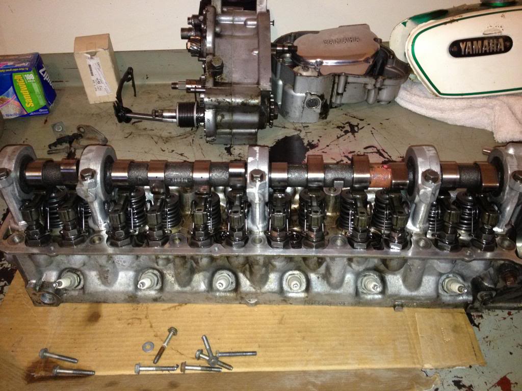

It's "good" for the engine it came off of.
HBZ had a massive discussion on intakes. IIRC, the turbo manifold & N42 are the best flowing, and are visibly bigger...

I didn't think the n42 was a good option for a turbo motor because i thought it has smaller chambers so more compression meaning less boost friendly? As for my intake, maybe i will chop it up and fab up some sort of custom manifold i have nothing to loose.

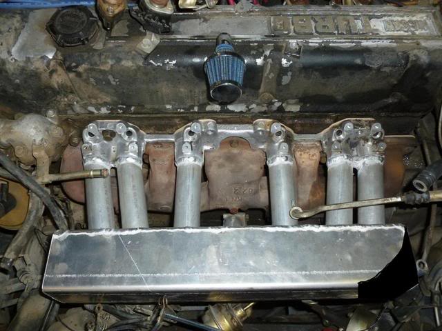

Old Apr 12, 2013 | 08:47 PM
^^^ Like Evan? https://www.zdriver.com/forums/280zx...t-33890/page3/
AUTO CAD to the max...
Old Apr 17, 2013 | 10:56 PM
From: Victoria, BC
Yup. Mine is a little different (big surprise there lol) but it's a ways from being finished so the cat is staying in the bag for now
