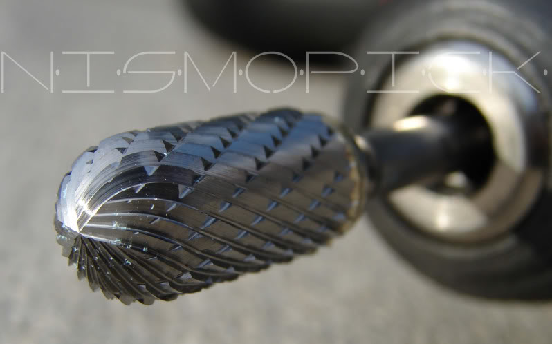

Not sure what exact tools tamug92 used, but:
https://www.zdriver.com/forums/280zx...uestion-34887/
When I de-webbed my turbo intake (search my posts for pics), I used a drill to put holes around the edge where the runners / webbing meet, then knocked out the webbing chunks with a hammer. Then rough finish the left over "nubbins" with a cylinder shaped carbide tooth drill bit, and smooth it off with a ball tooth bit. We've discussed dewebbing before... thus the reason for research before work.

^This is the process I used. Makes things -way- easy, though mine had more of a pointed tip. Same concept.
That looks like half way between a ferrous style burr and a helical cut aluminum bit. There is a straight helical cut that's designed more for aluminum. You'll find the burr load's up pretty easily and it's a bit of a pain to clean it out. I use a dental pick to get the chunks out of the burr. Also cutting wax helps cut faster and extends the life of your bits...
