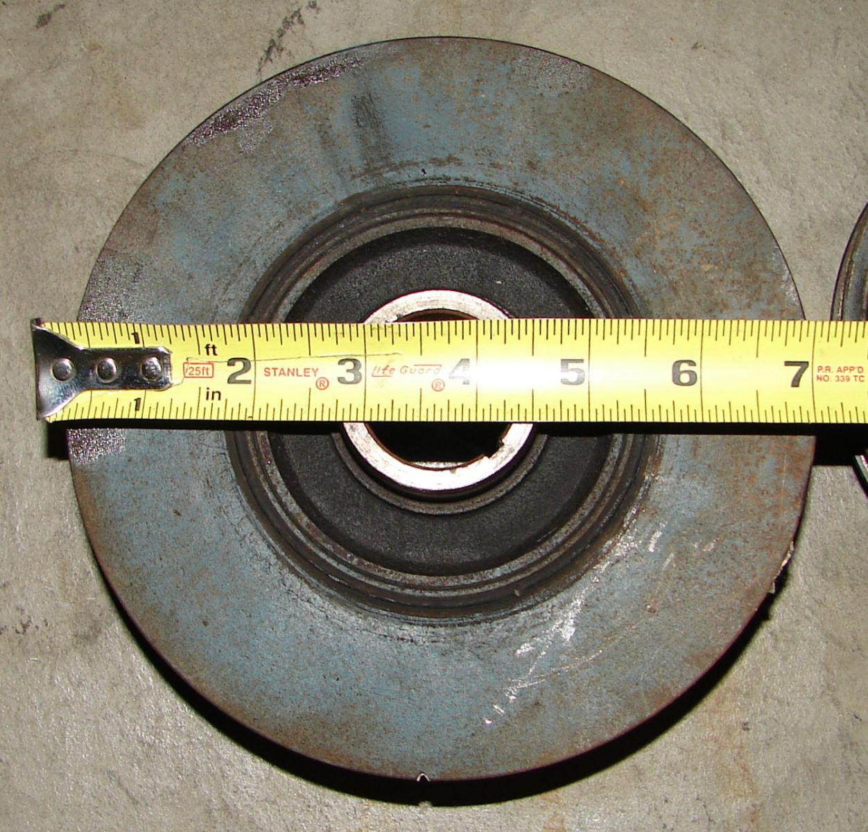

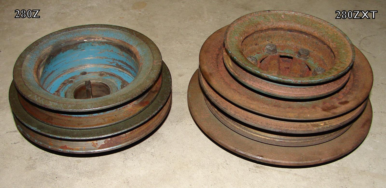

Has anyone researched using a 240z - 280z lighter & smaller crank pulley for the L28ET? I still need to weigh them & measure circumference to see how big of a difference there really is, but as you can see in the pics, it's quite a bit. I am also thinking of using the n/a flywheel & clutch to save more weight on rotating mass. I've read several threads on HBZ stating that the stock S30 crank pulleys don't hold up past 7k rpm... which is fine for any stock L-Series motor.

huh you know, if you take the metal behind the back belt off and the top belt off and flip the thing over, it'd be the same.

the out side pully is for power stearing. so if you swap. that goes unless you modify the rest of the belt system, and move the pump back a few inches.
Old Mar 5, 2009 | 07:02 AM
You can't just "take the metal off". It's bonded on w/ the rubber for harmonic balancing. And just by looking at them, I can tell the individual pulleys are sized diff than the L28ET ones... though I am going to measure to make sure.
This L28ET is going in my 280z, so no power steering pulley needed... just water pump / alternator.

i know you cant take it off i wa just noticing if you took the top pully off the ZX and the base plate off of it its nearly the same on the remaining 2.
flip the Z one over and look at em

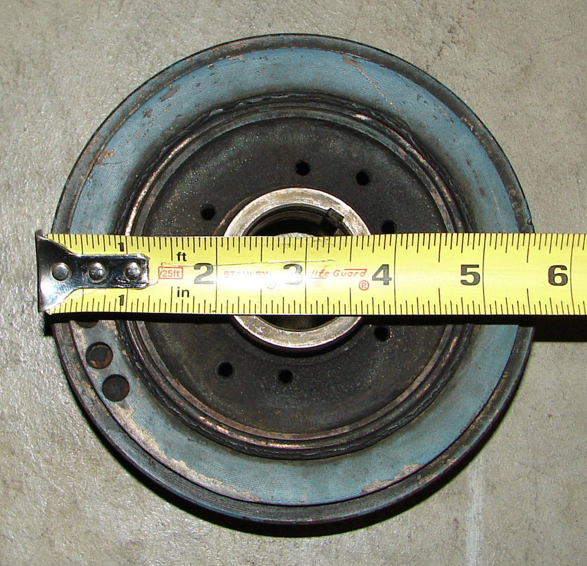

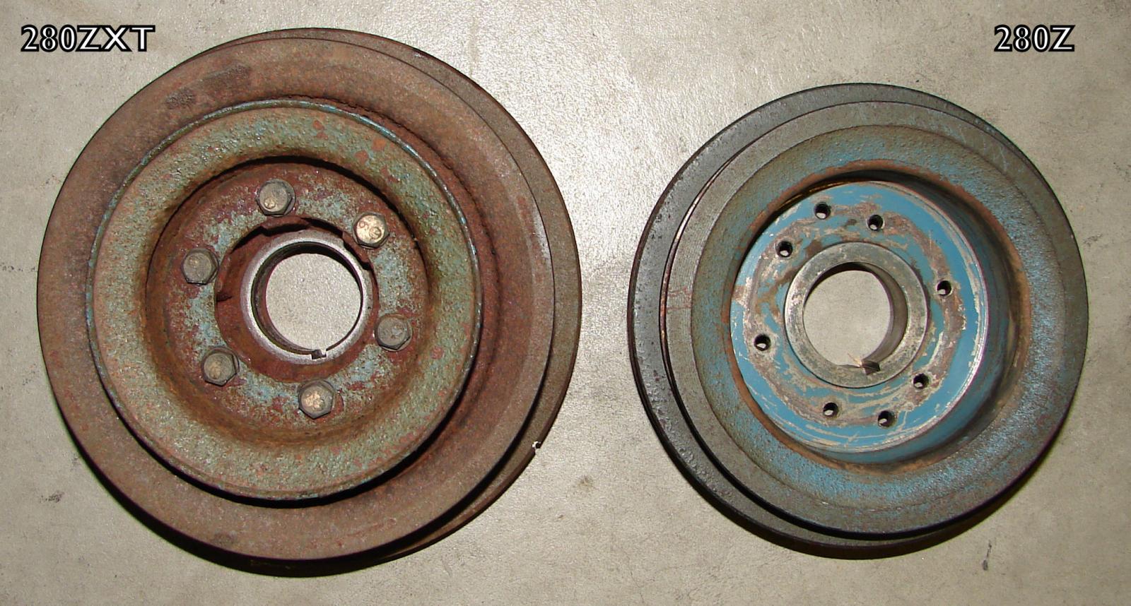

So the S30 pulley is ~3lbs lighter. The alternator / water pump pulley circ is the same, and the a/c pulley is smaller. I'm going to try the S30 pulley on this setup.

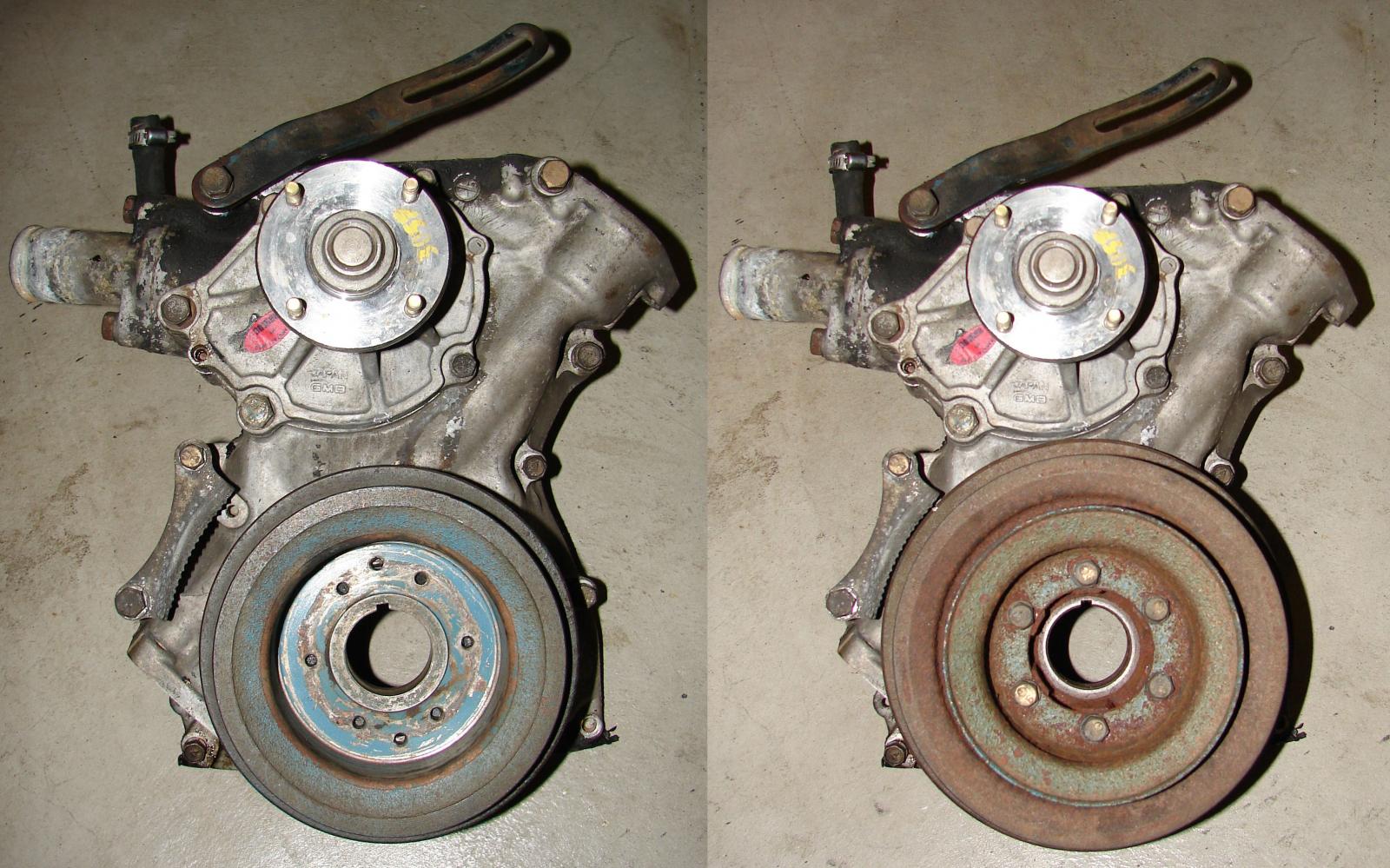

Comparison of the two on the timing cover.

you just blew my mind, i've NEVER seen a crank pulley infront of a Z's timing cover before, i might just puke from the anxiety of seeing that.

You cannot remove the power steering pulley from the 1981 280zx turbo pulley.
You can only remove the tone wheel because the bolts come in from the back.
