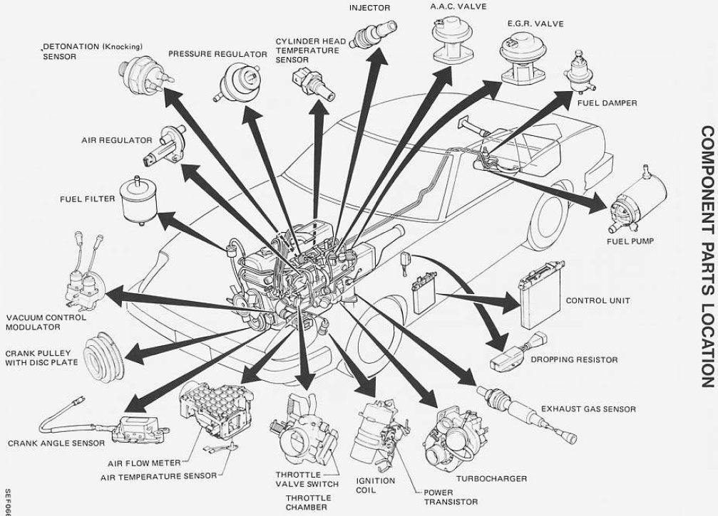

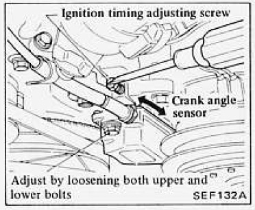

can someone send me a link to a pic of where the crank sensor on a 81 turbo is? also am i suppost to have one on the pully and the distributer or what? please help and thank you

shady 280 is a know nothingl. the 81 CAS on the turbo cars is mounted on the front of the engine. the 82,83 had it in the dizzy.

jturbo06... here are two scans from the FSM. You can also download the full FSM at www.xenons130.com/reference
Attached Thumbnails crank sensor help please-81cas.jpg   crank sensor help please-81cas-2-.jpg
