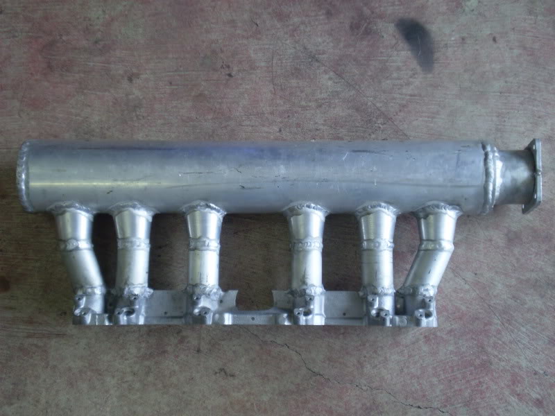

Hmm. Think it would be worth it to cut off the stock plenum off the intake and port out the runners then weld a bigger tube onto the runners? I have a spare intake laying around...Along with a good sized metal tube (kinda like the lonewolf ones look like)
Old Aug 14, 2009 | 11:53 AM
  #189
skib's Avatar
This facepalm's for you!
Joined: Aug 2008
Posts: 1,175
From: The Interwebs
I have a Log style intake in the works, Ill put up some pics a little later.
if your going to go threw the trouble of welding a new plenum on then you should hack the runners off and make new ones too. Ill go into some more detail when I have pics up for visual reference

So the intake plenum is for mixing the air/gas under pressure before it goes through the runners into the intake, right?
I've noticed a lot of plenums are square, would a rounded plenum not be better pressure-wise?
Old Aug 14, 2009 | 02:07 PM
  #192
skib's Avatar
Joined: Aug 2008
Posts: 1,175
From: The Interwebs
no
yes and no, a square plenum isnt as efficient, but theres nothing to do with pressure.

a buddy of mine started making this and Im gonna finish it and mod it to work on the turbo car.
gonna change the TB plate. smooth out all the welds, and port all the runners.
and I might have to angle the mouth out at an angle to squeeze the IC piping in

Damn, Compared to that Mines going to look a little half assed ^^" As the only thing I have to weld with for that is a brazer. That and Im probably keeping the runners thats already on it. Maybe. I just dont want to have to fabricate a new throttle linkage
Old Aug 14, 2009 | 09:13 PM
  #197
skib's Avatar
Joined: Aug 2008
Posts: 1,175
From: The Interwebs
lol a brazer is not gonna fly for an aluminum intake
what are you having to make new linkage for?

And If I cut it like you did I would have to reweld the linkage back on which may be a pain.
