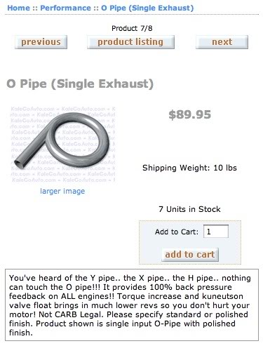

Well, you know KaleCo sells such a device! Proven to work!
http://kalecoauto.com/index.php?main_page=index
Check it yo…
Buy it here;
http://kalecoauto.com/index.php?main...&products_id=3
I strongly recommend also going with their new adjustable powerband! Just read the reviews…
http://kalecoauto.com/index.php?main...products_id=30

Just bought my 3 lbs. Brass ***** last week and I love 'em!

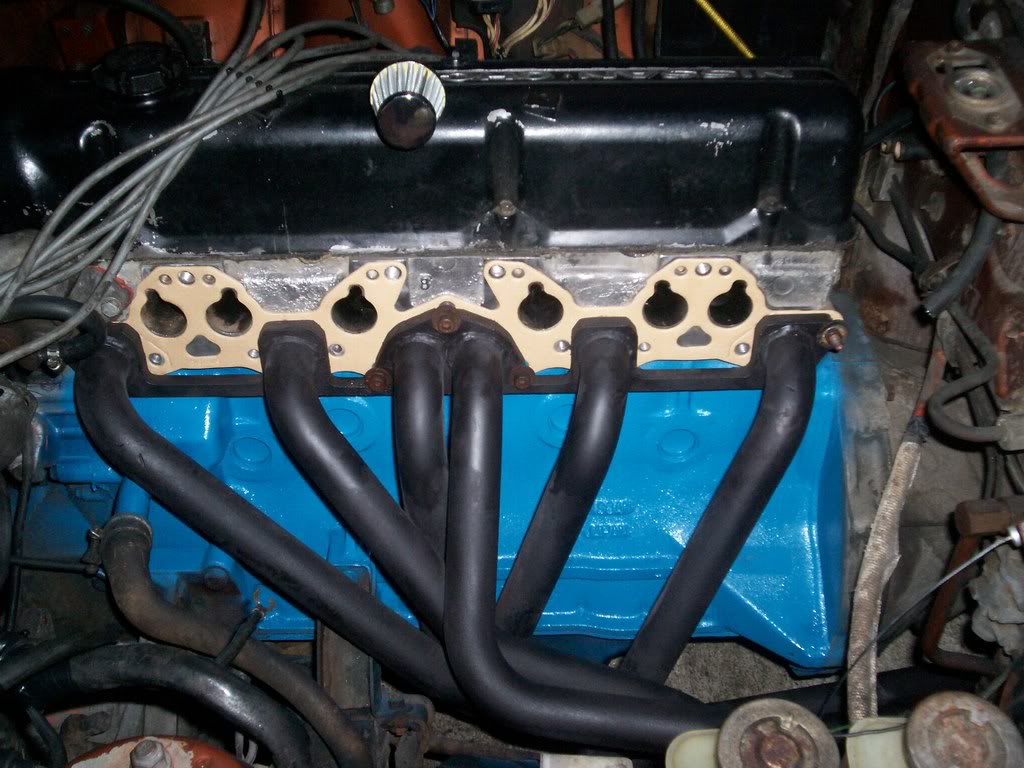

My turbo L28ET Manifold:
Stock N/A L28 Manifold:
My N/A 6-1 Header: [Just for good measure ]
Which one do you think, after looking at the N/A and Turbo, flows better?
You're getting ragged on because you're making assumptions on things you've heard on the interwebz that are false. It's all ricer math. Bigger TB = Moar pwr!!!

Because he didn't say to use it on an N/A car, he was talking about it flowing plenty for a turbo car :facepalm:
Even a 6-1 header like I posted above doesn't give any HP gains without a bigger cam and EFI upgrade.
You are being lazy and not looking for answers yourself, you're going off people's passing comments. Keep doing that and be prepared to spend alot of money on worthless parts.

My car had a 6-1 Header on it when I bought it.
Alright. Do you know WHY a 6-1 Header has really long equal length tubes?
Better flow, less turns, favorable back pressure. Good for N/A applications.
Do you know why a turbo exhaust manifold only has one outlet right out of the head? Turbos use the heat from exhaust gases [which are hottest right after exiting the head] as well as the pressure of the gases leaving the head to spin the turbine in the hot side of the turbo. The 'opening' is a 'T3' port that will accept most turbos with a T3 flange.
AFTER the exhaust gases exit the hot side of the turbo, the less back pressure the better. If there is a lot of back pressure it can slow the turbine wheel down.
You are talking about two completely different things here and you're trying to make an argument over something that you MISREAD.
You need to do some research on basic motor functions before you go off modding your car.
