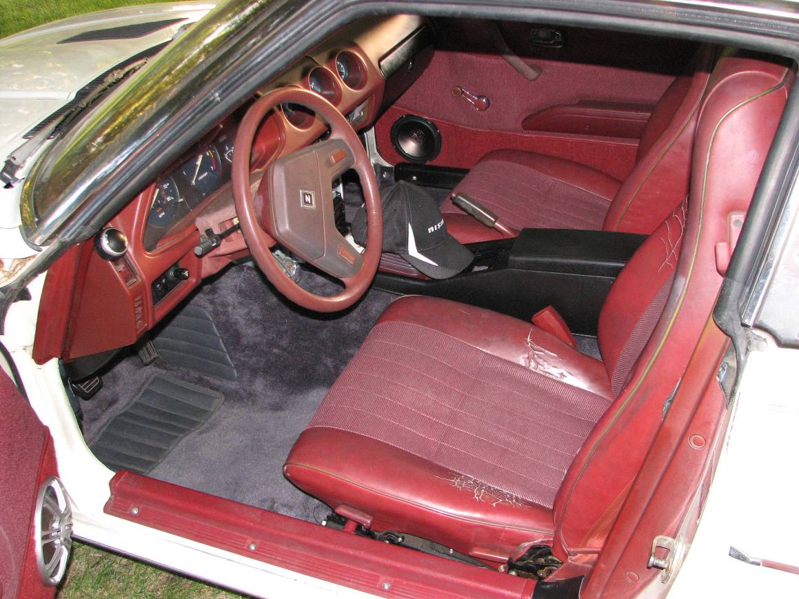

Installed the carpet and center console from an 86 300zx, for the most part I only had to do minor trimming. The holes for the seats lined right up, the placement of the hatch release was different, but worked out perfect. I still haven't got all the trim the same color yet. I had to shorten the console an inch or two, off the front end, to get it to fit under my stereo, the holes lined up almost perfect for the console too, just a bit narrower.

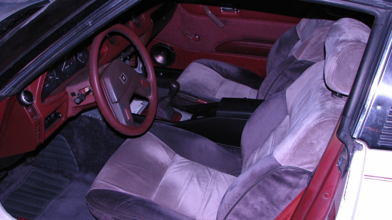

I put my velour seats from my 84 z31 into my 81 280zx, wasn't exactly a direct bolt in. The passenger side was pretty easy, just had to widen the bolt holes in the track. The drivers side tracks are completely different and makes the seat sit **** eyed. I put the rails from the 81 on the seats but they won't bolt up to the side ways mounted brackets, so I bent them over and drilled holes approx where they actually needed to be, the seat bolts are about 14 3/4 inches center to center on the s130 and about 15 1/8 on the z31's, close but some cutting required. I also had to remove the air pump gizmo, but I might be able to use it in a hidden location, ill see.

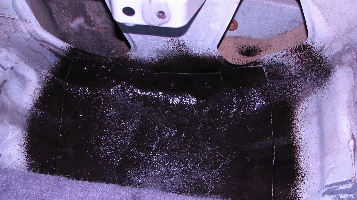

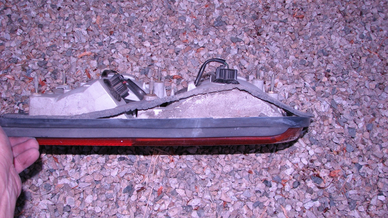

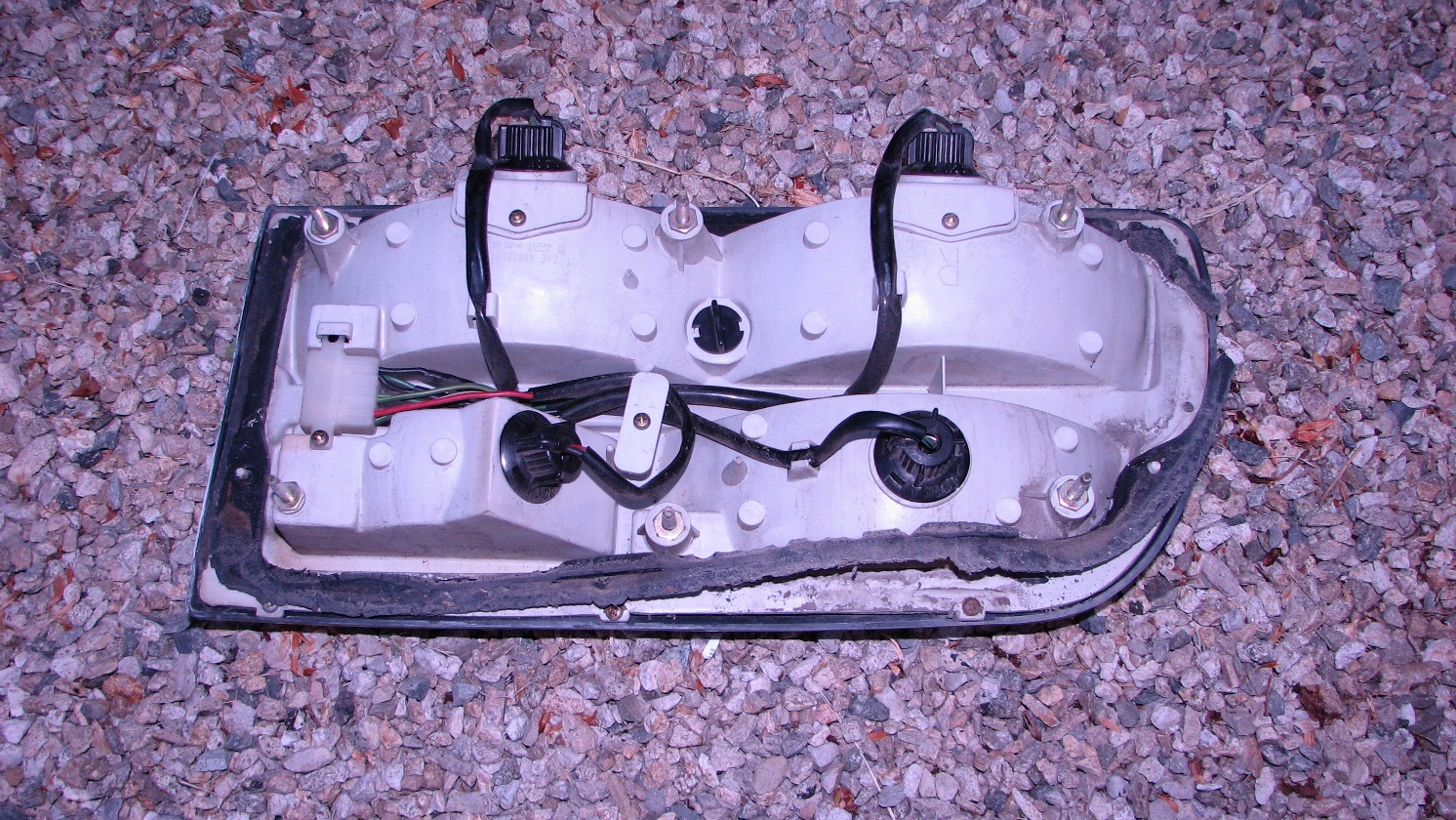

I cut out a big rust spot and hammered out a piece to fit from a scrap z31 fender, sealed it with Black RTV, then screwed it down all around and undercoated it. I also replaced the rotten seals on my tail lights, I used a rubberized foam tape, from Lowes. Between the hole in the wheel well and the tail lights leaking, I shouldn't be getting any exhaust and gas smells in the car anymore, hopefully !
Attached Thumbnails 81 getting road worthy-rust-spot.jpg   81 getting road worthy-spare-tire-well-underneath-2.jpg   81 getting road worthy-spare-tire-well-underneath.jpg   81 getting road worthy-spare-tire-well-undercoated-above.jpg   81 getting road worthy-rotten-seal-tail-light.jpg
81 getting road worthy-rotten-seal-tail-light-2.jpg   81 getting road worthy-new-seal-tail-light.jpg

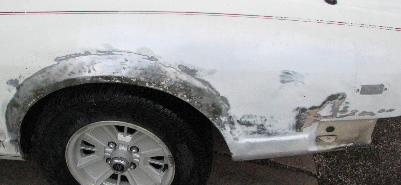

Since my interior is basically done, I have moved to the Body, for the most part I have 3 problem area, passenger door, tip of the hood, and the drivers rear quarter. I managed to get to most of the door from inside, with a few custom rods I made I worked out a lot of the dent, at worst in one spot its about 1/4 inch deep. The hood I was able to cut some of the supporting metal behind to get to the back of the dent, was larger that I had 1st thought, and still isn't perfect. The wheel well is another story, so much filler, I ground at it for an hour or so before I got rid of most of it, went from the rear bumper to the door. I am using the fiber glass bondo, it is extremely hard once it cures, putting it on to thick can mean lots of extra sanding or grinding

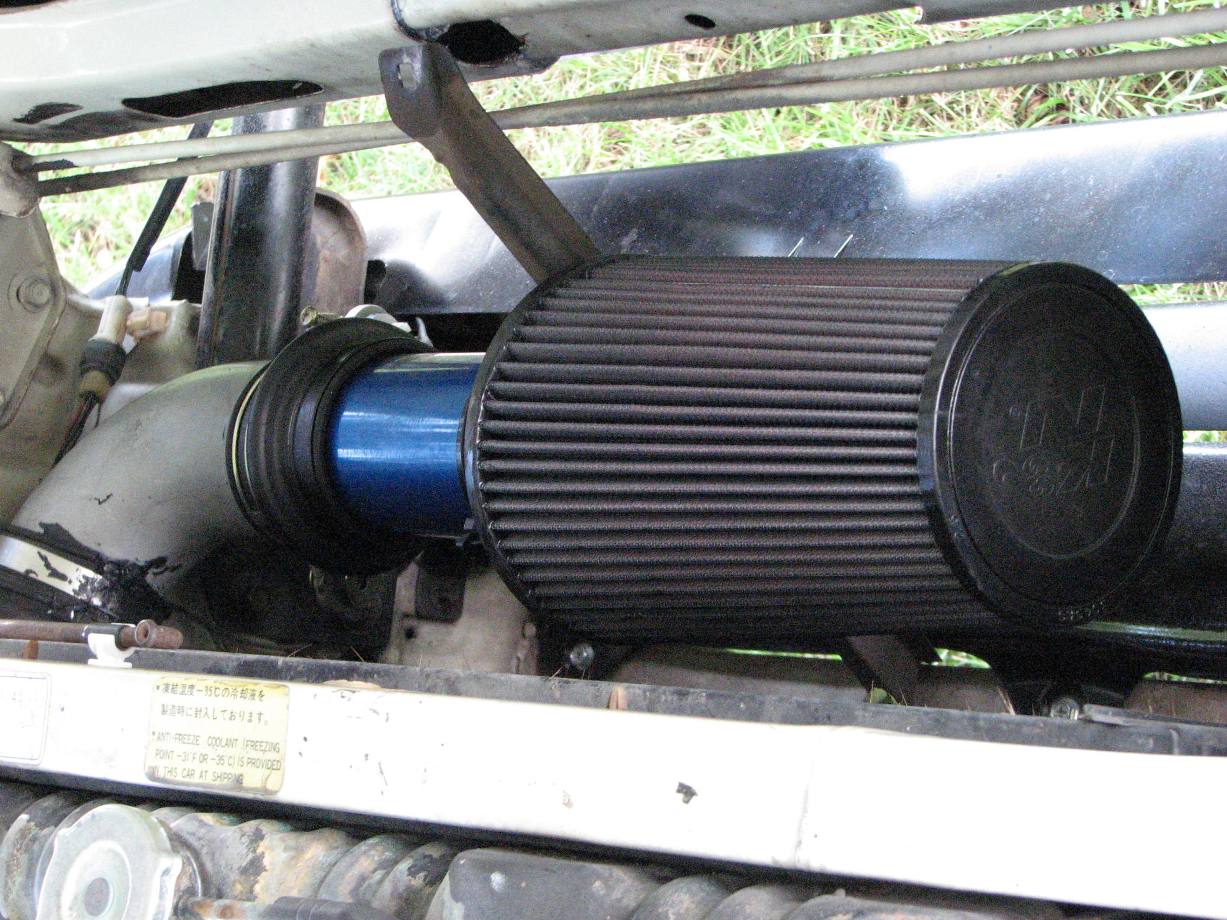

I was messing around today, I managed to get my air filter/ cold air setup into my zx. I tried to pull max revs in 2nd gear, she was pulling really hard up to about 5800 rpm, which was about 78 in 2nd gear, I am pretty sure I was experiencing either valve float or just intake restriction, I backed off and got back to a legal speed. I was pretty happy with almost 80 mph in 2nd gear, that works out pretty good for short races.. not that I think I would win any, but you never know. Next time the local drag strip is open I'm going to get a time slip, Firebird raceway is about 30 miles outside of town, then I can post my numbers, since we have that ability on the site, and I am very curious to see how she will do. I was getting the faint smell of clutch after a few of those hard shifts, to my surprise It won't break, or hasn't yet. Don't get me wrong, I am not thrashing on it all the time, I just do little tests like that to see what her limits are.
