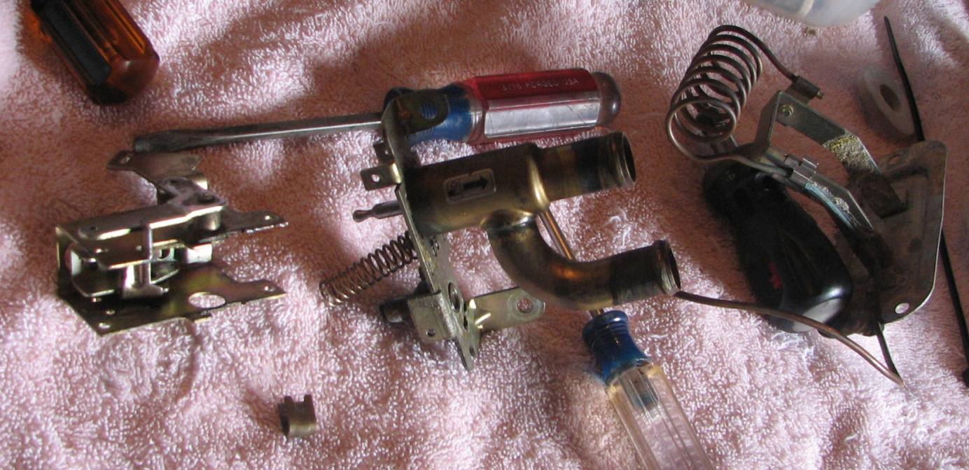

Refurbished Control
I took apart the heater control valve, the part that leaks is a plastic plunger in a brass tube that's crimped to the main bracket for the control. Inside the plastic plunger is a shaft that has an O ring, it can leak at the O ring, or where the plastic plunger housing presses into the brass tube. You can partially disassemble the plunger to get to the O ring, the rings seat was dirty and gritty, but the little O ring seemed in good shape. After cleaning it and putting it back together, I used JB Weld around the edge where the plastic and brass seat/seal together, and most likely place to leak. I reassembled it all and it works great and does not leak.
I worked on the thermostat and the sensor housing below it, there was a broken bolt and it was a pain to fix. Tomorrow I am replacing all the manifold plumbing rubber, coolant and fuel lines. I have all new clamps to, so it should clean up the engine a lot.
The last 2 pictures show the plunger and the end cap that conceals the O-ring
I am also going to replace all the Fuel Injection connectors, TPS and MAF, all from a kit I got from Fricfrac.
Attached Thumbnails 81 getting road worthy-control1.jpg   81 getting road worthy-control2.jpg   81 getting road worthy-cap-1.jpg   81 getting road worthy-cap2.jpg

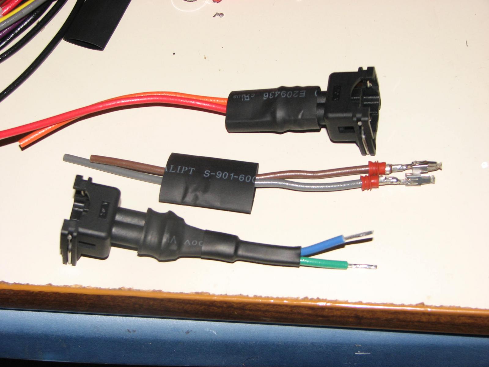

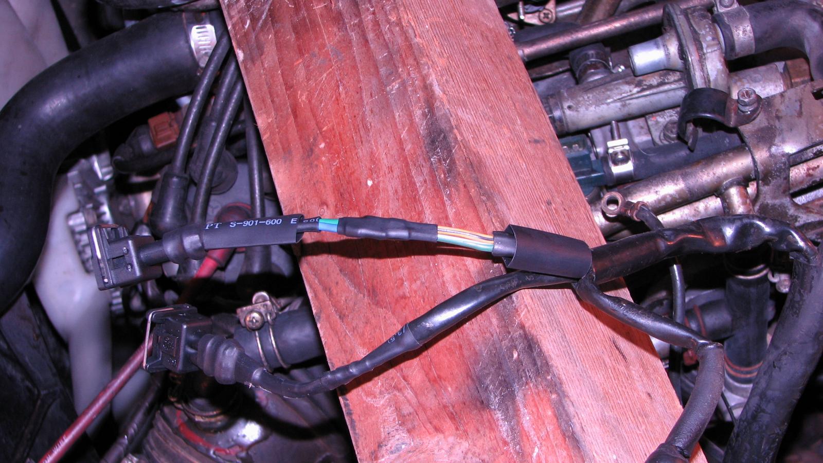

Pig Tails
Worked on my EFI harness today, got all my connectors wired and shrink tubed, just need to cut out the old ones and start soldering under the hood, took me a couple hours to get them all made up.
These are from fricfracs kit. The rubber on my stock old connectors was dry and brittle, a lot of the connectors were cracked or broken, and a few were tie wrapped to hold in place, so for me this was an essential upgrade to just make sure I have solid engine electrical. I am going to do some extra grounds also.
Attached Thumbnails 81 getting road worthy-pig-tail-1.jpg   81 getting road worthy-pig-tails.jpg

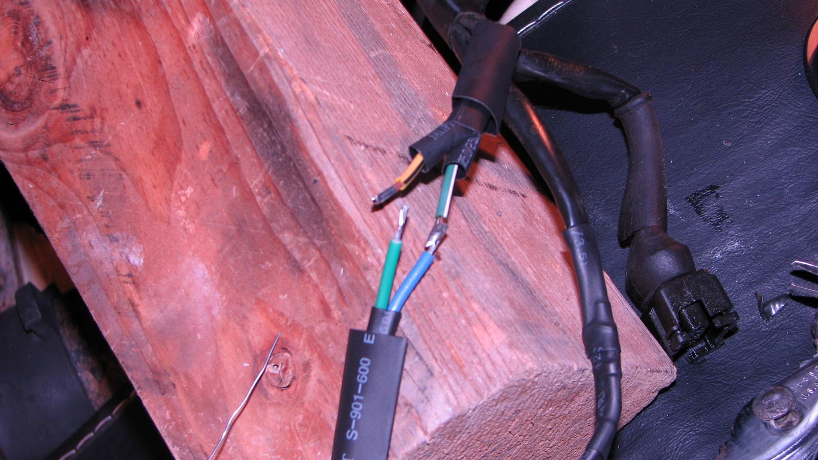

EFI done
I replaced all the EFI and sensor connectors, still need to do the AFM connector, have it stripped back, but its time for march madness. The AFM is missing 2 wires on one end, I had already pinned them so I just cut it off flush with the connector. The cold start injector was a tight squeeze to get on, around the manifold coolant hose above it. I included a few pics to show the steps I used to finish them, lots of heat shrink.
Attached Thumbnails 81 getting road worthy-efi-harness-01.jpg   81 getting road worthy-efi-harness-02.jpg   81 getting road worthy-efi-harness-03.jpg   81 getting road worthy-efi-harness-04.jpg   81 getting road worthy-efi-harness-05.jpg

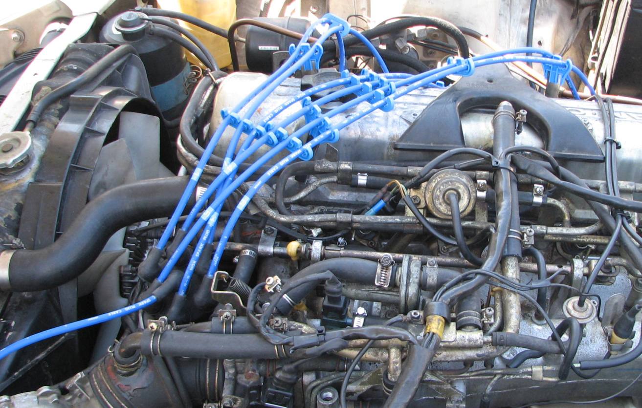

Plugs and wires
New NKG Platinum plugs and NKG wires and some moroso wire loom kits help keep things in place and dresses up my piggie engine bay just a bit. This would be lipstick on my pig you might say. Runs a lot better with the new plugs, I still have not done a cylinder pressure test yet, but when I pulled the plugs they all looked good exactly alike,just like they should, which is always a good sign. Out of the box the plugs were gaped just a little to wide and the electrode on these is pretty small, took a bit of fiddling to get them all as close to exactly the same as I could. Wire loom kits might be over kill, I had extra pieces, so I just kept adding them on, hehe !
Attached Thumbnails 81 getting road worthy-nkg-morroso0008.jpg   81 getting road worthy-nkg-morroso0005.jpg

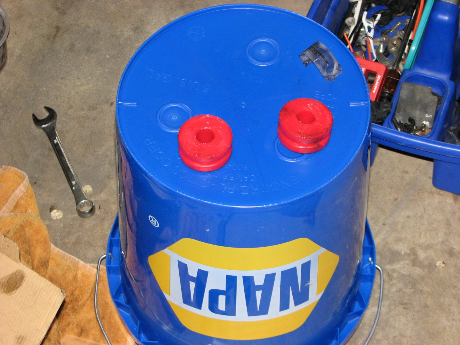

front Poly Bushs
I got all of the front bushings changed, with one wheel off it made it a tad more difficult because the side hanging down was putting a nice twist on the stabilizer bar, which I had to correct by jacking that lower arm up a bit to compress the spring. I got some spring compressors, but it seems like you can only get a hold of the bottom 1/2 of the spring at best because of the shock tower is pretty narrow inside. is there a trick I missed ? I didn't need to remove the springs, I don't have new ones yet, but it got me thinking about how to do it, I'll have to do some reading to figure it out. I made the mistake of putting one of the end links on the stabilizer upside down, with the nut facing down. bad idea, it will hit the tension Rod, or at least come really close, so I flipped it over, I have pics of it done both ways. The red looks nice. The grease supplied with the bushings is very sticky, almost like silicon RTV.
Napa has a nice sale, they were the only ones locally that had the inside seals for the front hubs, so I went there, if you buy a bucket, $3.50, everything you can fit inside is 20% off, it ends up being cheaper no matter what you get, the bucket really ends up being free plus you still get it a few bucks cheaper , Mine was ruffly $34 without , $27 with the bucket.
Attached Thumbnails 81 getting road worthy-wrong.jpg   81 getting road worthy-right2.jpg   81 getting road worthy-napa.jpg

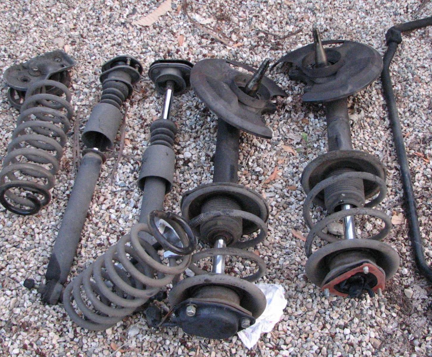

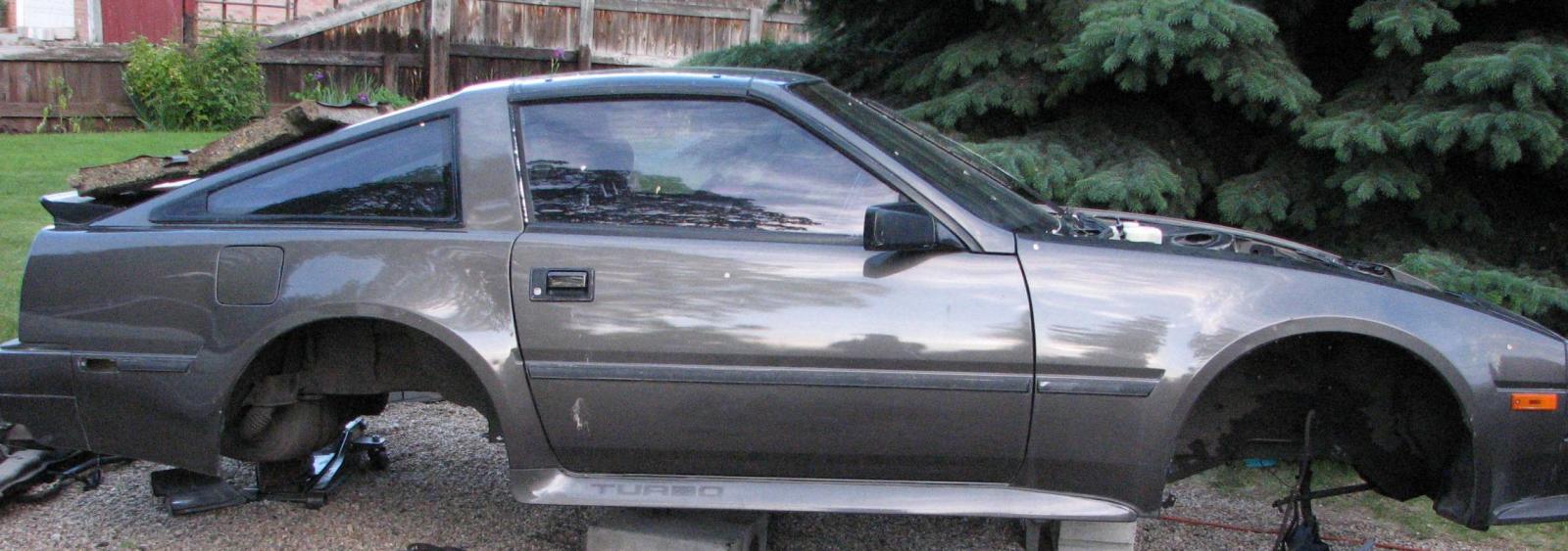

Busy Day
had a busy day, got the entire suspension off the 86 Donor car I have. Cleaned up the steering it looks pretty good. Next step is to start swapping parts to the 81
Attached Thumbnails 81 getting road worthy-86-rear-susp.jpg   81 getting road worthy-86-shell.jpg   81 getting road worthy-adjust-susp-shocks-struts.jpg   81 getting road worthy-b4.jpg   81 getting road worthy-after.jpg

Have you thought about replacing those springs with new? My original '86na springs are a little tired at this point... I have looked into replacing them with new... Seems to me they sag a bit around sharp corners Not that I have stressed them out over the years. I'm a conservative driver. I think that they just get tired after a while... What are your options?

Coilovers
Ya, all new springs with coil overs, I might try and build them from the 86 adjustable s , I am going to split the control and wiring out of the harness and make it stand alone harness for it. Would make a unique feature on an s130 if I pull it off. So far it's down to 2 kits Ground Control and Techno toys. rear coil overs seem to be the trickier piece, but doable.

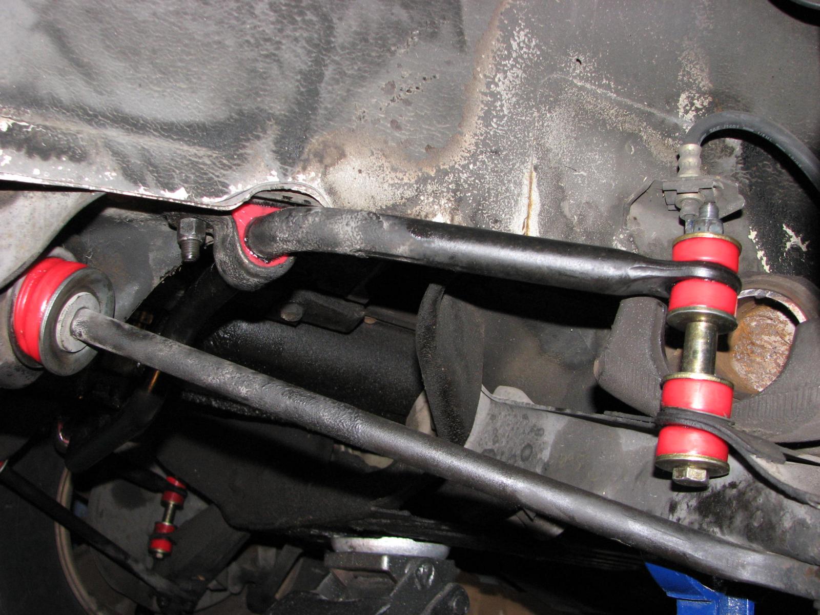

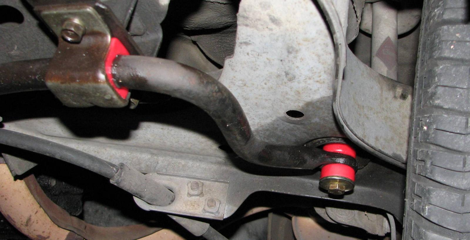

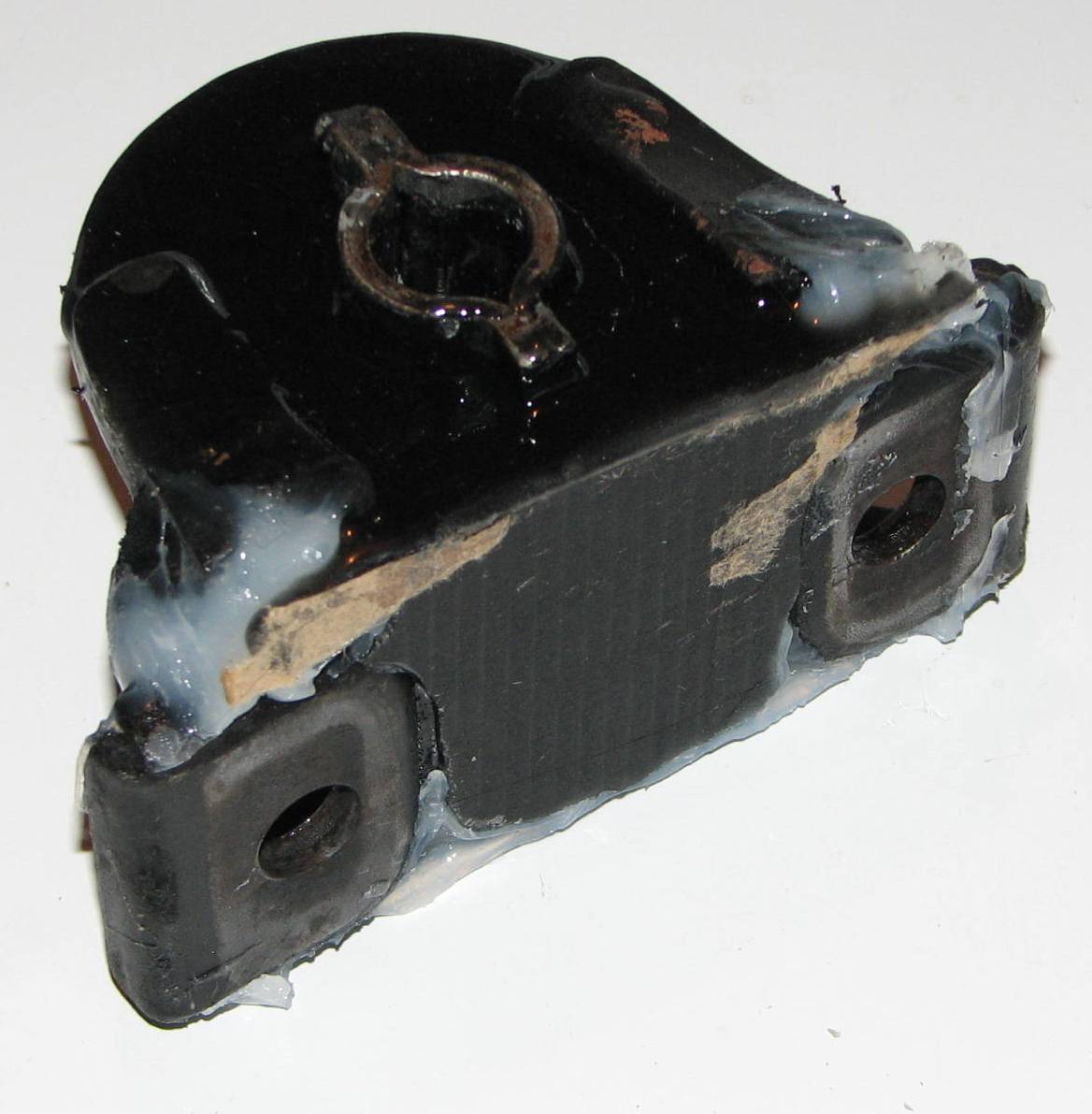

Rear Diff insulator
I used my liquid Polyurethane Kit today, to rebuild my rear Differential Insulator Bushing. It turned out pretty good, but it took almost 2 hours for it to start setting up, the instructions say it will start to harden in 4 minutes, not so, and confirmed by the guys at Aftermarket Suspension Parts - A Warehouse Distributor of Aftermarket Suspension Parts (Prothane, Energy, etc.), they did offer to send me a free replacement if it failed to harden. But eventually it set up. I will install it tomorrow.
I also installed my Poly Bushes in the rear sway bar / end links. I still have all the bushings for the control arms to do, but saving that for my coil-over install.
Also pulled the front and side aprons and radiator grill off, hammered on the aprons, and did some fiberglass work on the radiator grill, it had a few cracks.
Also found a nice crack about 6 inches long on the underside of my passenger side headlight bucket, opened up the crack so it wasn't binding and glassed it back in.
You can see in the second photo, some clear silicon on the sides, after wrapping it with a piece of cardboard and taping it, I had to seal up the edges with the silicon, or it would just run out. You can also see a bit of cardboard still stuck to the back.
Attached Thumbnails 81 getting road worthy-b4.jpg   81 getting road worthy-diff-insulator-rebuild.jpg

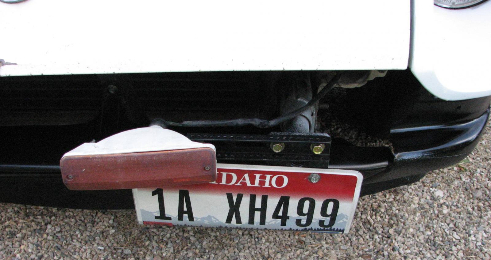

Finishing Touches
Got her all back together, nice thing taking apart my 84 & 86 I have a lot of pristine hardware that was on the interior, I have been using them instead of any of the corroded gross looking screws and such.
The new bushings really have firmed everything back up, the rear end is solid, she just zips around corners np.
Had to make a temp turn signal bracket / license plate bracket. Painted the lower front sheet metal black, looks pretty good, at least its a lot closer to square up front.
And I picked some fresh strawberries out of my meager garden.
Attached Thumbnails 81 getting road worthy-blnkr-plate-brkt.jpg   81 getting road worthy-drvr-drk-frnt.jpg   81 getting road worthy-pass-side-drk-frnt.jpg   81 getting road worthy-img_9858.jpg
