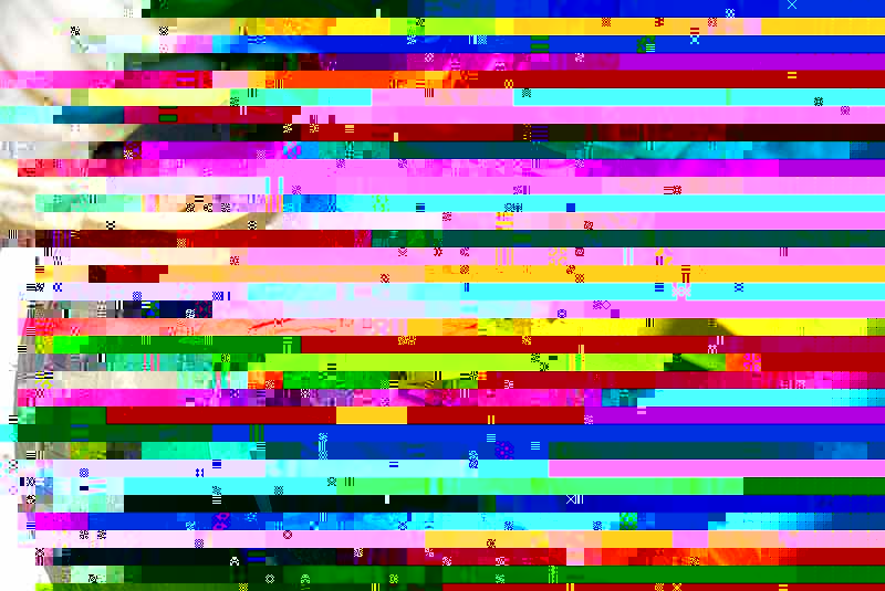

Just got back from Chicago with my new 72 240. Car was rustproofed when new by Ziebart but they obviously can't stop everything. I didn't put this car on a rack before getting it home, so please no criticism Here's what I found at the right front swaybar mount. Looks like I need to have a new box section fabricated and welded in place. Also whoever does the work will need to build in sway bar mounting points.
Should this go to a body shop or a frame shop?
I'm going to contact the seller about "sharing" the cost, hopefully he's as upstanding as he seemed. I really don't believe he knew about this damage as he swapped some home remodeling for the car 3 months ago.

Wow! That is pretty major... too bad you didnt' just look under the car a little while it sat on the ground. How else would you even know if it had a major oil leak? Anyway, good luck on the repairs.
Buyer beware

Contact Charlie Osborne at Zedfindings (www.zedfindings.com). He sells new frame rails and then you just have to get a shop to do the work, no fabricating involved.

I agree with texasz ! If the frame rail is this weak to fail to that level , the entire section must be replaced and at least strengthend. The sheet metal looks so thin that there is not much to weld to. Find a good certified welder to do the work if at all possable.
