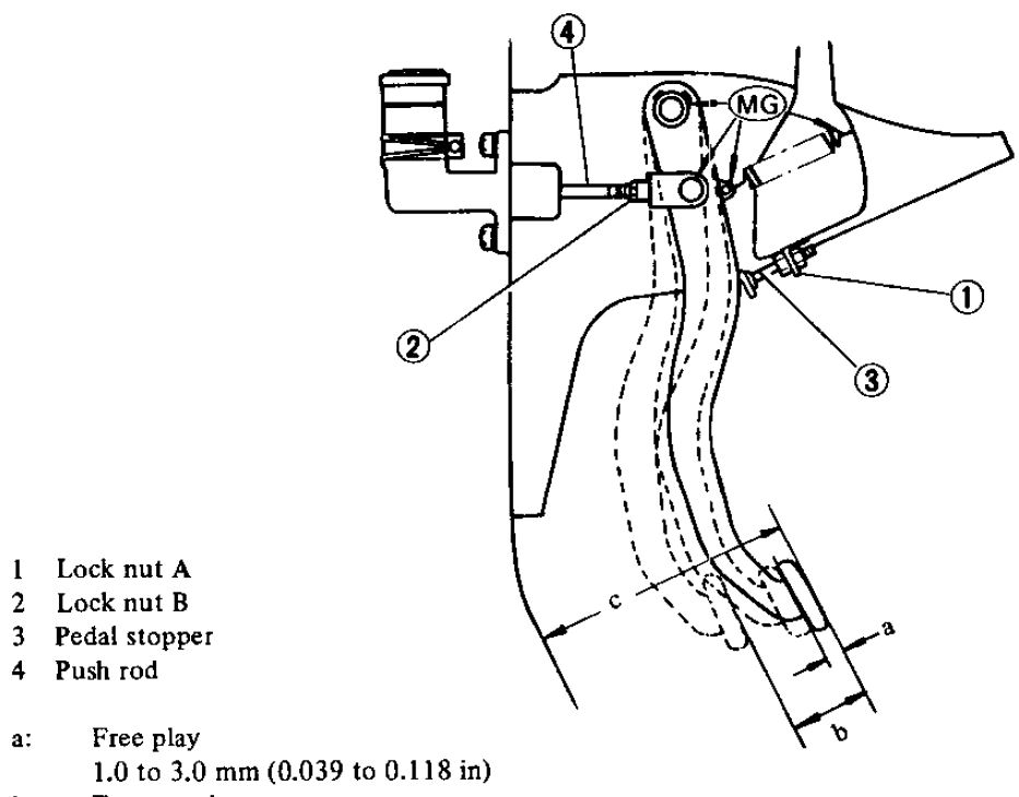

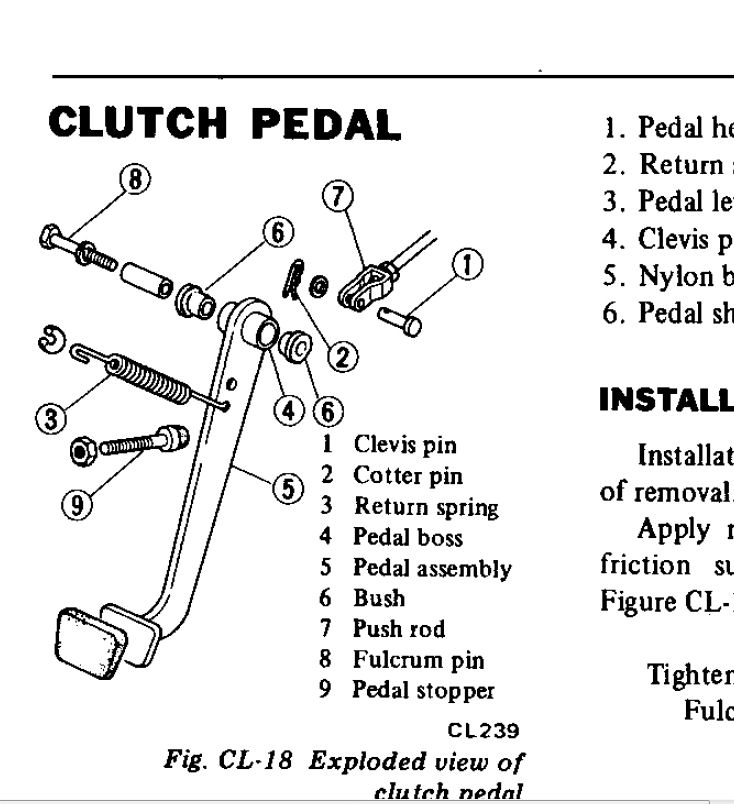

How to you get the clutch pedal out of an S30? And is it an assembly like the S130 has?
I'm realllllly hoping I dont have to pull the dash out! I'll be at the junkyard half the day if thats the case...
Old Mar 26, 2013 | 08:21 PM
I've never looked at the pedals of an auto S30 before... but hop under there and look to see if there is a location to add a clutch pedal. I'm looking in the 76 FSM (XenonS30) and it just shows that it's held in by a pivot pin. Remember to grab the brake pedal too (it's a lot skinnier than the auto brake pedal).
Attached Thumbnails Pedals Swap Qs?-s30-cpedal1.jpg   Pedals Swap Qs?-s30-cpedal2.jpg

Oh good! I don't have to rip the entire dash apart then! I'm downloading the 78 FSM right now but I figured I'd ask to see if anyone had any first hand experience.
Now I have to head back out the Pick N Pull to get everything.
