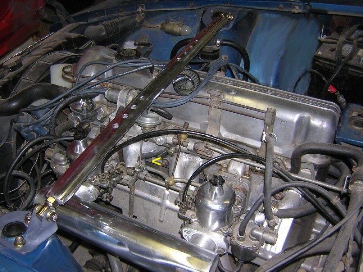

I posted this about 3 years ago, the MSA 6-2-1 header comes very close to the front intake manifold (1/16"). I changed to a N36 intake and it gave a little more room. I checked the temp with a digital thermometer and the rear manifold was 240 deg, the front was 270, on the top! The paint was coming off right out of the box, I think they use radiator paint. If I had it to do over I would get it ceramic coated and wrap the first 6 inches of it. The ceramic should keep it from burning out. I painted the header with high heat silver- two coats. The second coat is peeling off but the first is still good. You can see by the arrow, #2 exhaust to close at #3 intake.

I was told that MSA recently redesigned their headers for better fitment, can anyone verify this?
Old Mar 19, 2008 | 12:21 AM
  #46
mine was still pretty close. the manifold flanges that is they were stock so close together i barely got my intake mani on. the headers are a bit close to the intake runners though themselve, thats why i want to heat wrap them at least part ways.

I have the MSA 6:1 header, one of the first of the new re-design (just lucky timing when I ordered it), and their premium exhaust package. The main difference is the flange is much thicker, matching nicely with the intake manifold's height for the studs, convex washers, and nuts. It also makes it stiffer, so it stays straighter and less prone to leaking. I installed mine to torque, started and drove it some, and thought I had a leak. I was concerned, as everyone used to complain about that. Turned out it was just the rear-most hardware was loose. I re-torqued it and it's been fine since. Note that I have only about 2 hours of time on the engine, and a lot of that is just in run-in and tuning in the driveway. So, it's not like I can vouch for any sort of hard-use testing yet. Hopefully that'll be this summer.
