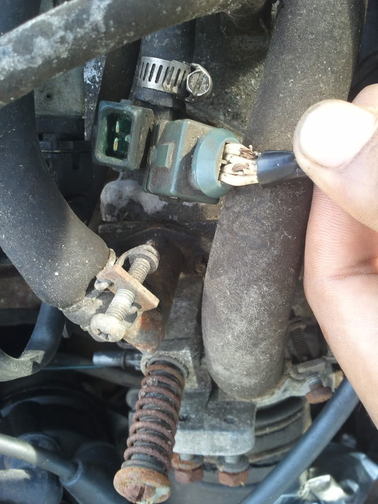

heres the pics, you're right about the valve but it has 4 wires to it
is there any way to test it before i go and spend 60 bucks on a motor that ima swap out here in a while?
Old May 8, 2012 | 08:25 PM
Notice there are only two prongs... so there should only be two wires. I imagine the two each side are connected as one. Been about 10 years since I've looked at n/a wiring in detail.
Anyway... why not clean it up instead of buying a new one? Dip the tip that goes inside the intake in brake cleaner or lacquer thinner, dip the top connector prongs in LimeAway or CLR. Done.

nice tip, my fuel injector pigtail were corroded as well, but i just snatched some good ones from the junk yard, gotta order a fuel pump and pray soldering new injector pigtails and cleaning the cold start valve do the trick
