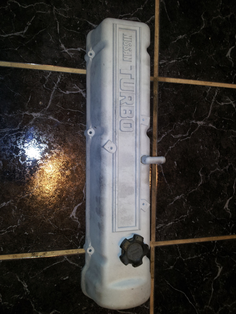

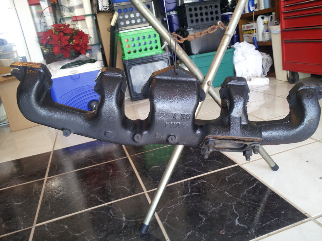

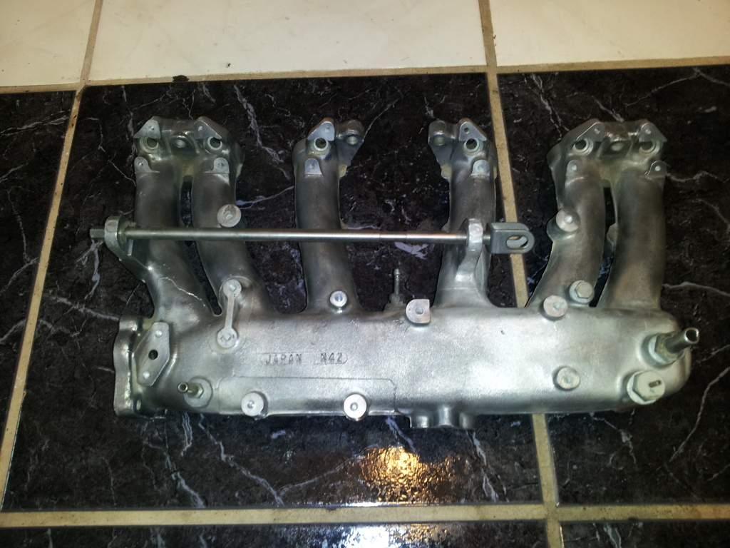

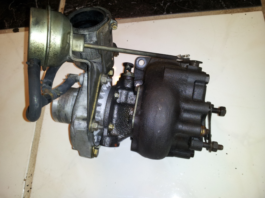

Here are some pics of parts collected.
Attached Thumbnails Get Started-20121220_135213.jpg   Get Started-20121230_150348.jpg   Get Started-20121230_145953.jpg   Get Started-20121230_145936.jpg
