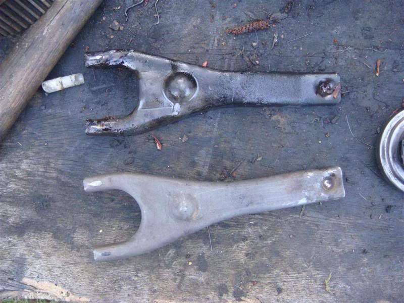

another thing im having trouble figuring out is this clutch pushplate where the slave cylinder rod bumps up and pushes the plate.. my plate has a hole in it , the rod just passes through and just floats there.. without pushing the plate.. is the hole in the plate factory, or am i missing parts or?
anyways, i put a bolt through with a flat head on it where it makes the entire pushplate flat and the slave cylinder rod just bumps it.
Old Jun 3, 2013 | 10:12 PM
Are you talking about the fork? It should not have a hole in it...

another thing is if that plate in the picture is what the slave cylinder is suppose to push, im officially scared cuz mine is very different and i cant push it by hand.

if you have the old type clutch fork with the hole in it.. your going to need the slave with the threaded end that has that tappered end on it..

thankyou.. i have the old type clutch fork, that makes much more sence to me now with those pictures.. i have the newer type slave on there and it doesnt make sence/ or work, so im going to remove it and put the correct one on, and replace the master aswell because i still got no pressure.
