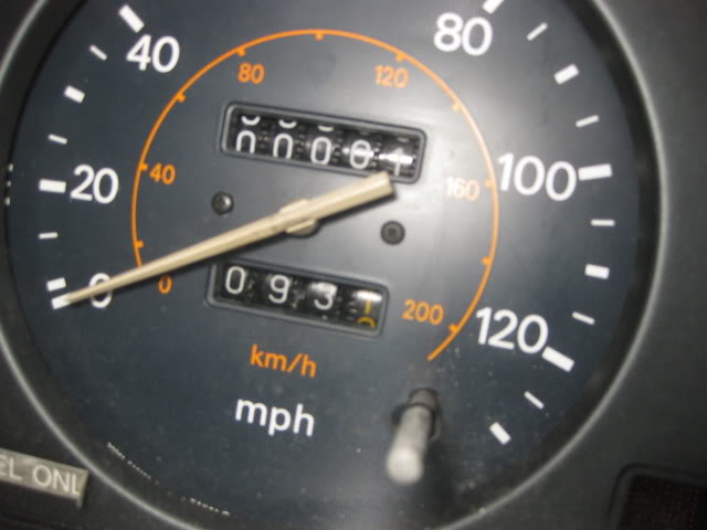

I want to pull my clock out and replace it with something useful... maybe I can get my A/F gauge in there
Odometer rolled over today...
Now I can pretend that I'm driving a brand new car... that leaks oil... and had a worn out interior...

I wouldnt mind a A/F Gauge. sense they help set the AFM a little better
EDIT: Where did you get a 120MPH Speedometer audiofreak?

It's a speedo out of a 79' 280ZX. Note it has 5 digits instead of 6. Hence why's it's at 0. I believe cruise control also does not work with the 79 speedos?

What he said and I got it on eBay. My old one would just spin when driving down the road, it was pretty cool but I had to replace it.

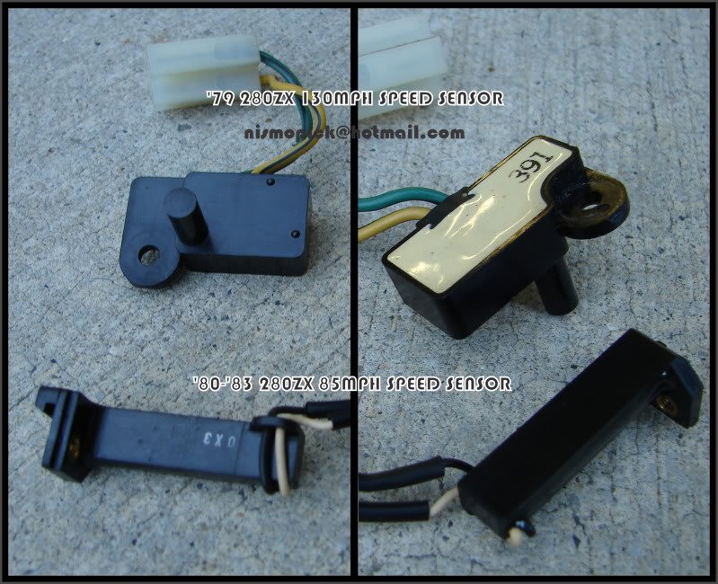

Old Aug 7, 2009 | 11:23 AM
  #8659
It does when you swap speed sensors (the 79 speed sensor isn't compatible w/ the 80-89). Now my MAF does the burn off cycle on it's own now too...
