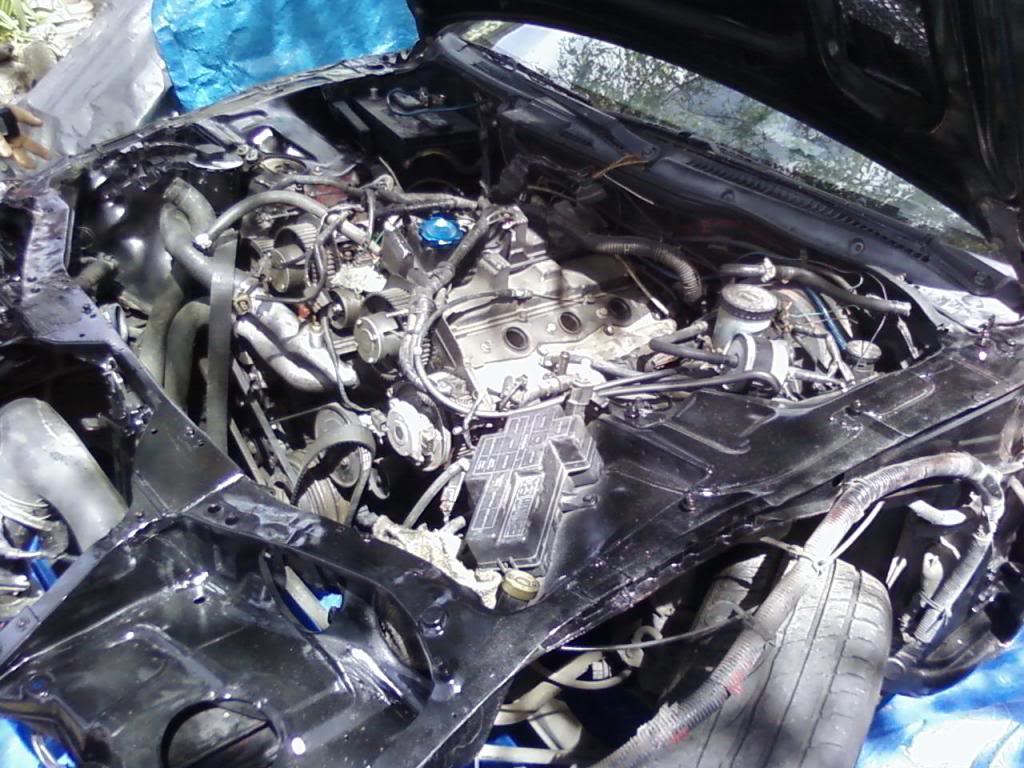

here is how it rests now. timing belt tension bolt snapped and took some valves along with it:

its been abused, but we're bringing it back to life....

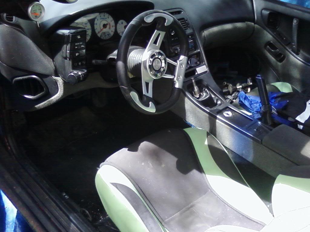

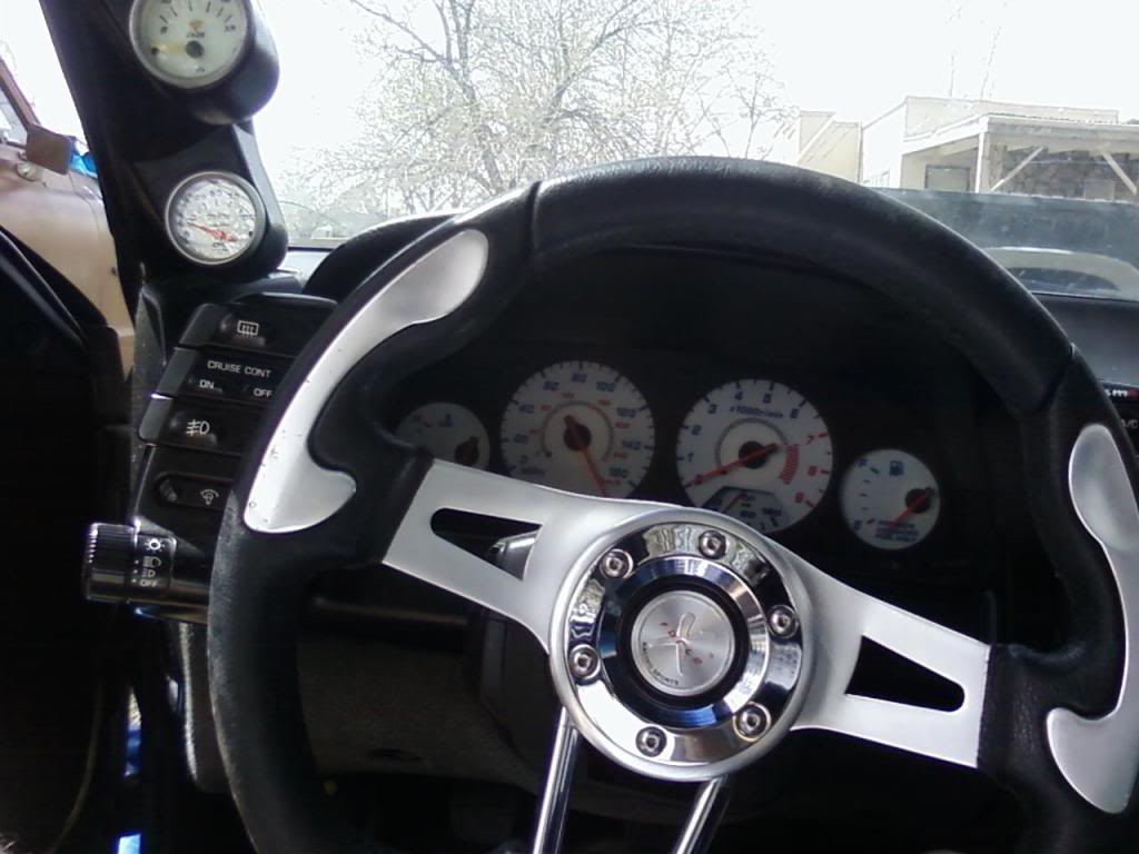

I question more the ability of an NA motor since they just aren't that strong, more so than the other things you are doing. TO single turbo a car with dual throttle boddies seems to be contradictory but hey go for it, the REALLL thing on my mind is does your friend have ANY TASTE at all? holy hell is that car hideaous. steering wheel is crap, the seats are crap and that two tone paint of vinyl is hoooorrid.

I said it was abused....you guys must not be able to read as well. the Specs on the hx52 we are using is 66/71/11. It flows close to a 42r. Well, all you guys talk about is that it isn't possible, so I figured (correctly) that none of you have ANY experience turboing an N/A motor.....just opinions and "he said, she said".
