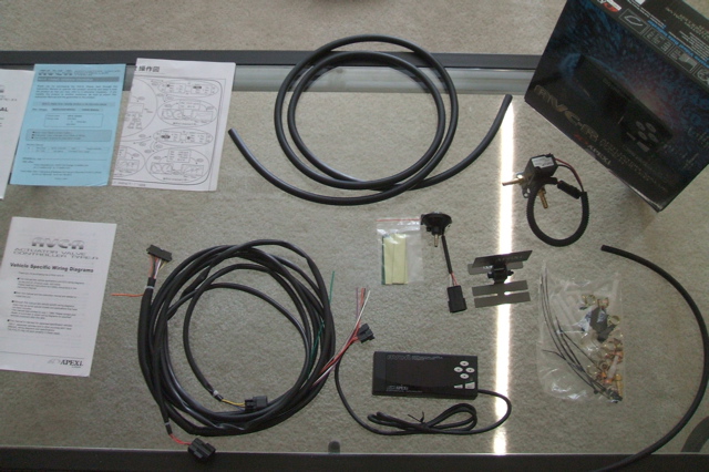

ok, this is what i got
I also chose the Apexi and this is the pic of its parts, I got to wait till after the sun goes down and the garage cools a bit before I go out there, it's like Africa hot out there today.
Hey Zlover if you got a pic or two of locations of your install I sure would appreciate it. Did you install the scramble option? If so where did you put the button?

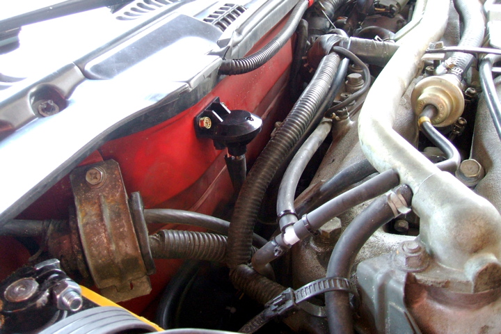

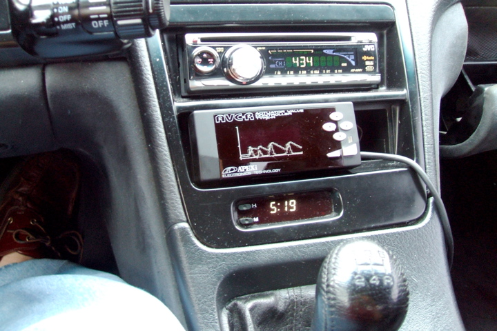

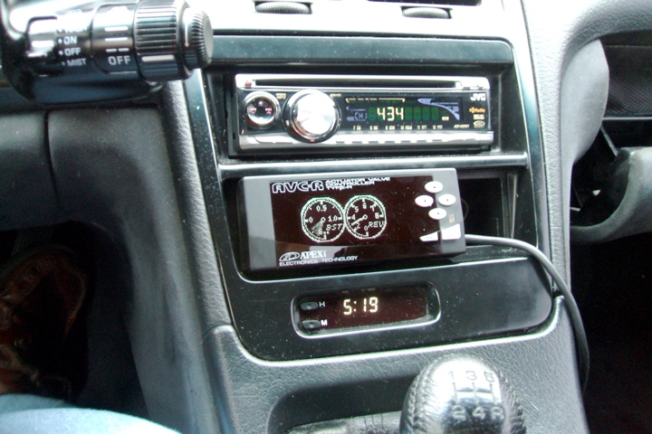

Well, I put it in, took the front right (passenger) fender off and put the solenoid inside the wheel well (frame) ran the hoses in front of the battery into that cutout and the wire into the main wire harness grommet. I didn't take any more pictures because I couldn't get the camera to work with the flash with my batteries being so low. The display sits nicely in the glove box. The pressure sensor hangs on the firewall behind the engine. Really looks stock unless you notice the two tee splices right near the battery for the vacuum lines. Ill test it out tomorrow when the sun's up.

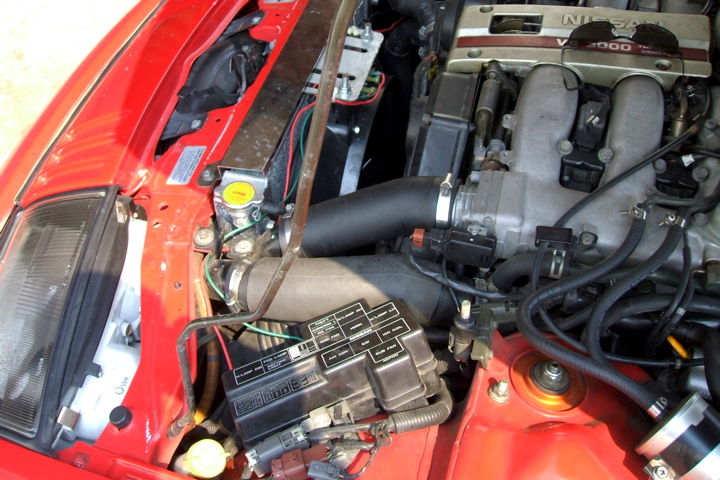

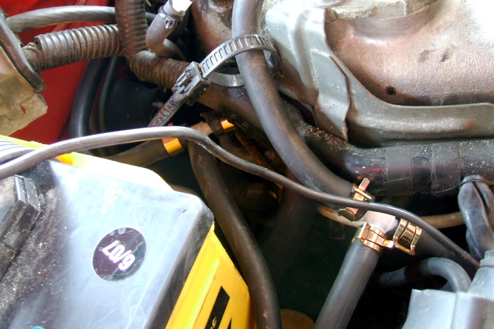

ok here are a couple pics as promised.
1. Pressure sensor
2. T-splices Vacuum lines
3. Tracking line graph display
4. Analog display
5. My electric cooling fan set up...just cause
Attached Thumbnails Boost Controllers-pressure-sensor.jpg   Boost Controllers-t-splices.jpg   Boost Controllers-reving-engine.jpg   Boost Controllers-analog-display.jpg   Boost Controllers-electriccooling.jpg

you should loom the wires with electrical tape to clean it up a bit and clean that bracket lol, its rusty. other than that, lookin good
Old Jun 18, 2007 | 08:18 AM
b300z's Avatar
caught the z fever
Joined: Jun 2004
Posts: 2,518
From: Lafayette, IN
dont use electrical tape. get some cable sleeves or some heat shrink wrap
and hide that wire
Old Jun 18, 2007 | 11:01 AM
idk about heat shrink wrap (you know the whole heat around wires thing to shrink it) but yeah cable sleeves are better....
