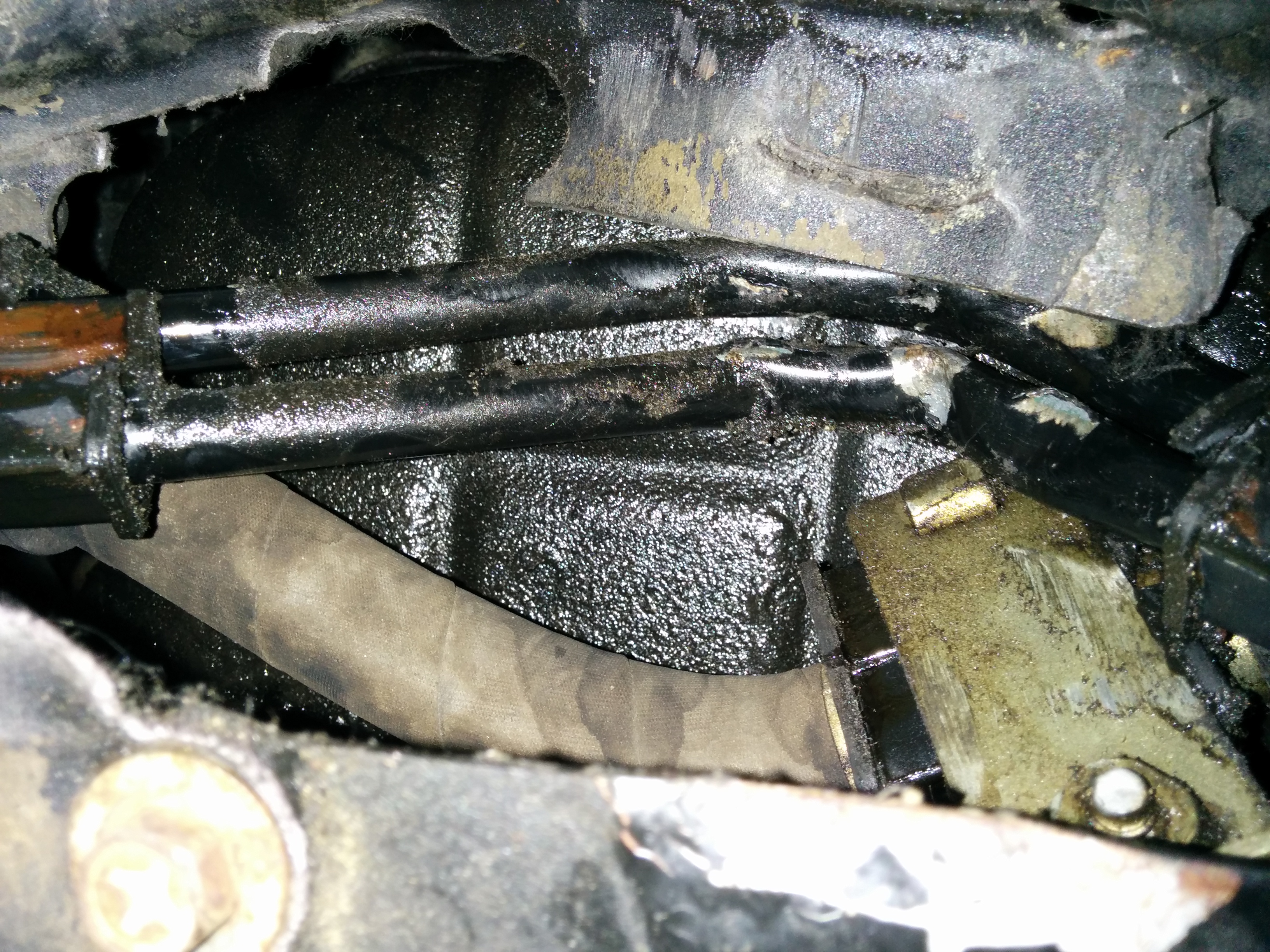

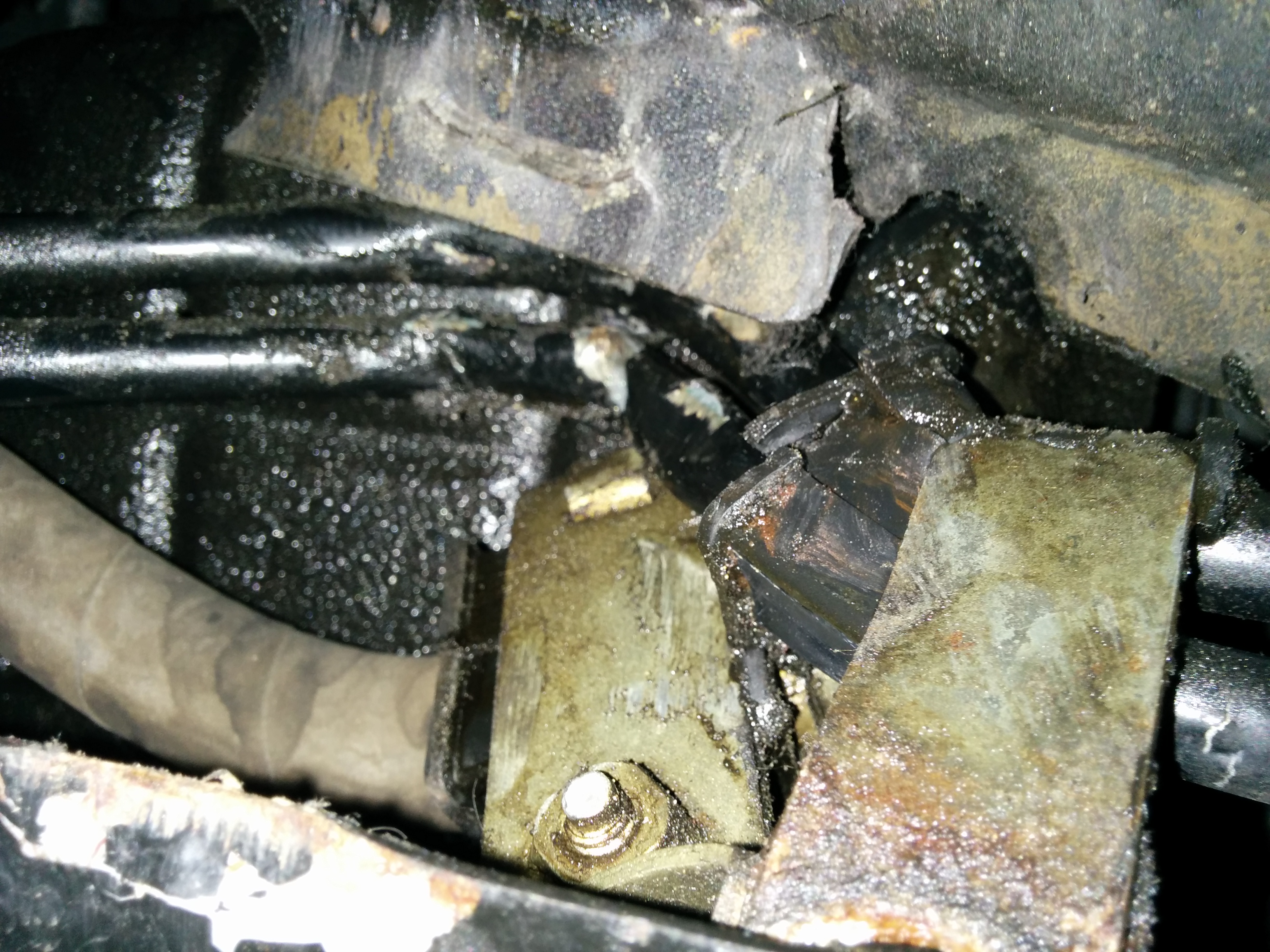

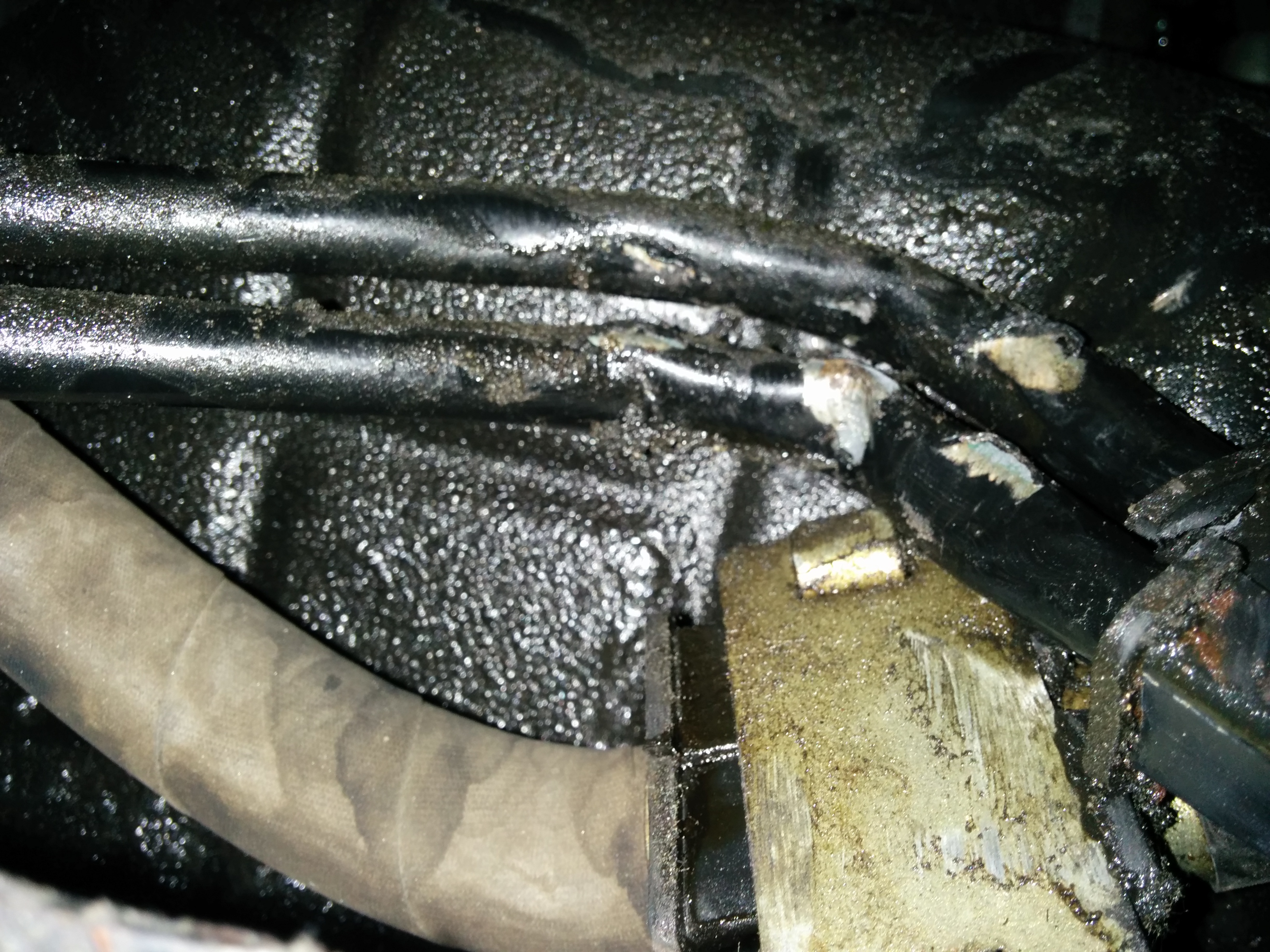

Well, I was an idiot and bent some lines (at a minimum) jacking up my car. I was jacking it up by the center mounting point and it must have slipped off the point and when I looked under the car the jack had slipped to the front of the mounting point and was pushing through the plastic shield.
I let it down and jacked it back up to see what I had done and sure enough, at a minimum, bent a couple of metal lines that are right in front of the jack point, bent enough that I don't trust they are not damaged or constricting.
Can anyone tell me what these lines are, and if they are reasonable to replace? OEM or aftermarket?

Some pics here:
http://www.techav.com/misc/300zx/bent1.jpg
http://www.techav.com/misc/300zx/bent2.jpg
http://www.techav.com/misc/300zx/bent3.jpg

most likely power steering follow them and see where they go. Really bad closeups of some bent pipes aren't much good for diagnosing.
I know, sorry...
If they are power steering any idea what I should expect in regards to the repair?

Some zoomed-out pics with the area in question circled would help a lot with identifying the lines that are bused.

Shop confirms it is the power steering lines. Says they look like a bitch to replace, lots of labor to get to where they connect, so he's suggesting he cut and replace the bent/broken portion of the lines with compression fittings. Seems confident they will last and said that's what he'd do if it was his car. Seems like the way to go.

if you like being led down the garden path by some silver tongued devil go for it. but sounds like someone who is full of **** and not a real mechanic. Find out the price of the hoses from NAPA. get a quote from the shade tree mechanic you talked to (better yet go elsewhere). get a quote to juryrig with compression fittings and a quote to replace with new lines. Get a warranty in writing as to who pays when the compression fittings leak (they might well). pressure hose listed by Oreilly at around 150 bucks
Another problem might be the HICAS system is involved if your car has that feature. My 96 was electronic so not the same as earlier models. you might ask down at the dealer might get lucky and find an old timer that knows something. I might also post a query about hicas and how it works. someone may have worked on that and could steer you right. there is a way I am told to lock it out. do you have the fsm? if not download from xenon and look at the steering section. I would start the car up move the steering wheel back and forth and see if anything is leaking

Fluid is definitely leaking.
He got back to me and said he doesn't feel comfortable with the quick fix because the lines were not the size he expected, so looks like we're ordering up the proper lines.
I do feel comfortable with this guy, he's a solid shop around here that a lot of people recommend. Not a Z shop, but a good repair shop.
He did mention they were for the rear power steering, so I do believe that's HICAS if I understand correctly.

Just wanted to close this thread. Everything seems to be good after replacing those lines. Ended up being a ~$600 "oil change" after expedited shipping of the lines (from CA), labor, etc.
