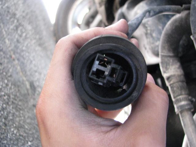

I found it! Thanks for the help. It turns out that (at least part of) the problem is the connector for the OPSU is missing a wire and female insert completely. I guess I'll have to dig around to trace back the missing wire and replace the connector.

The sensor has 2 connections, but it only uses 1 wire/connection.

So is it supposed to look like this? Looks pretty lacking to me.
I put in a new sending unit anyway, seems to work! Thanks.
