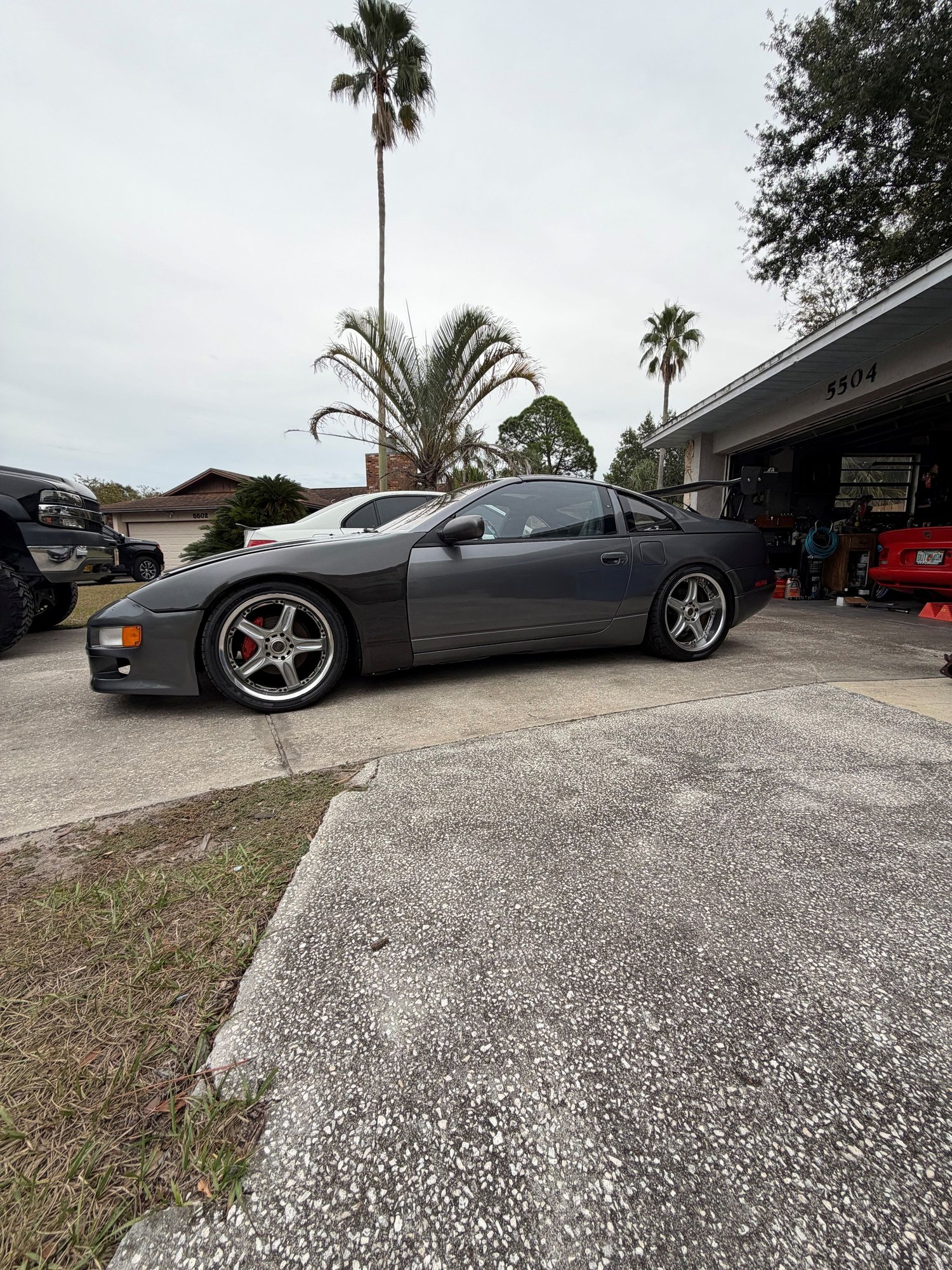

Hello all! New member to the forum. 1990 Z32TT. The car has had a very rough life, but I am slowly trying to get it back in shape! Very slowly I might add...
Car has an intermittent no crank/start issue. Sometimes it fires right up. Sometimes you turn the key on, everything lights up, you can hear the fuel pump, and when you go to start...nothing. Not a sound. Mess with it for a while, and it fires right up.
Starter is new, starter relay is new, battery is new, clutch switch is new. What's next? Ignition switch?
