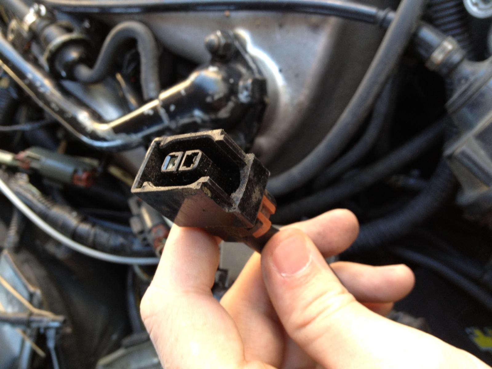

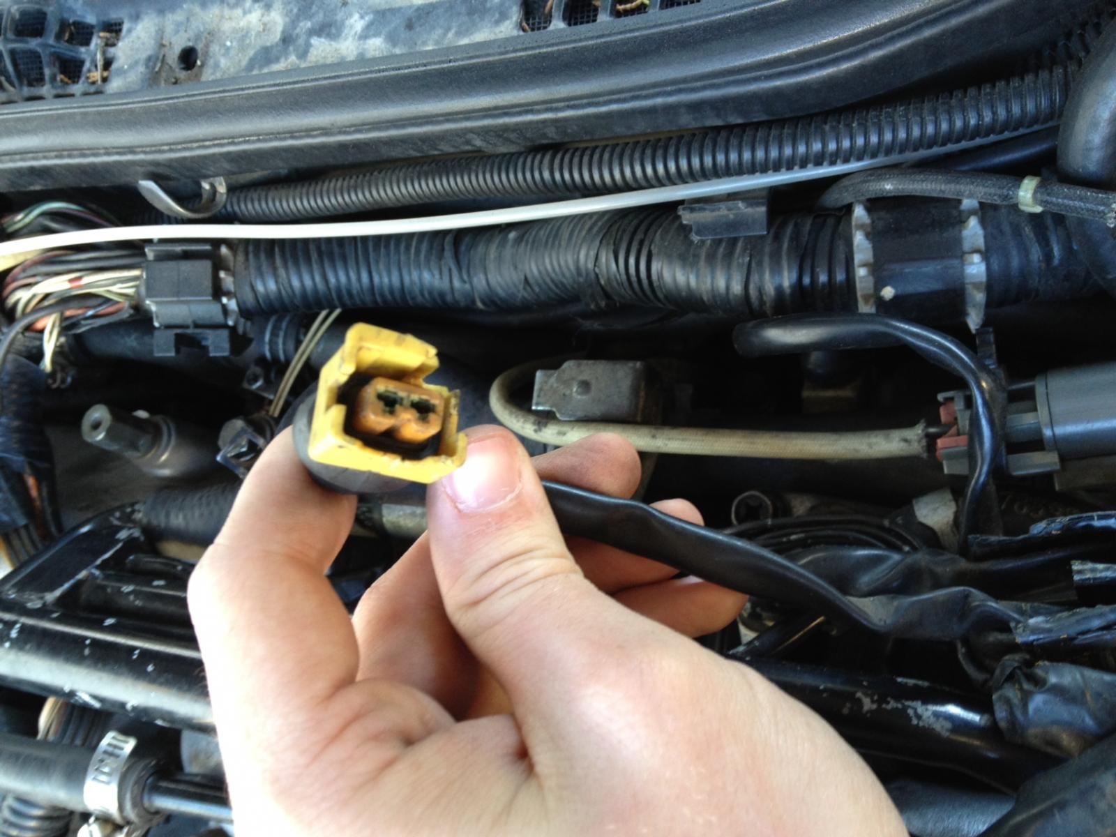

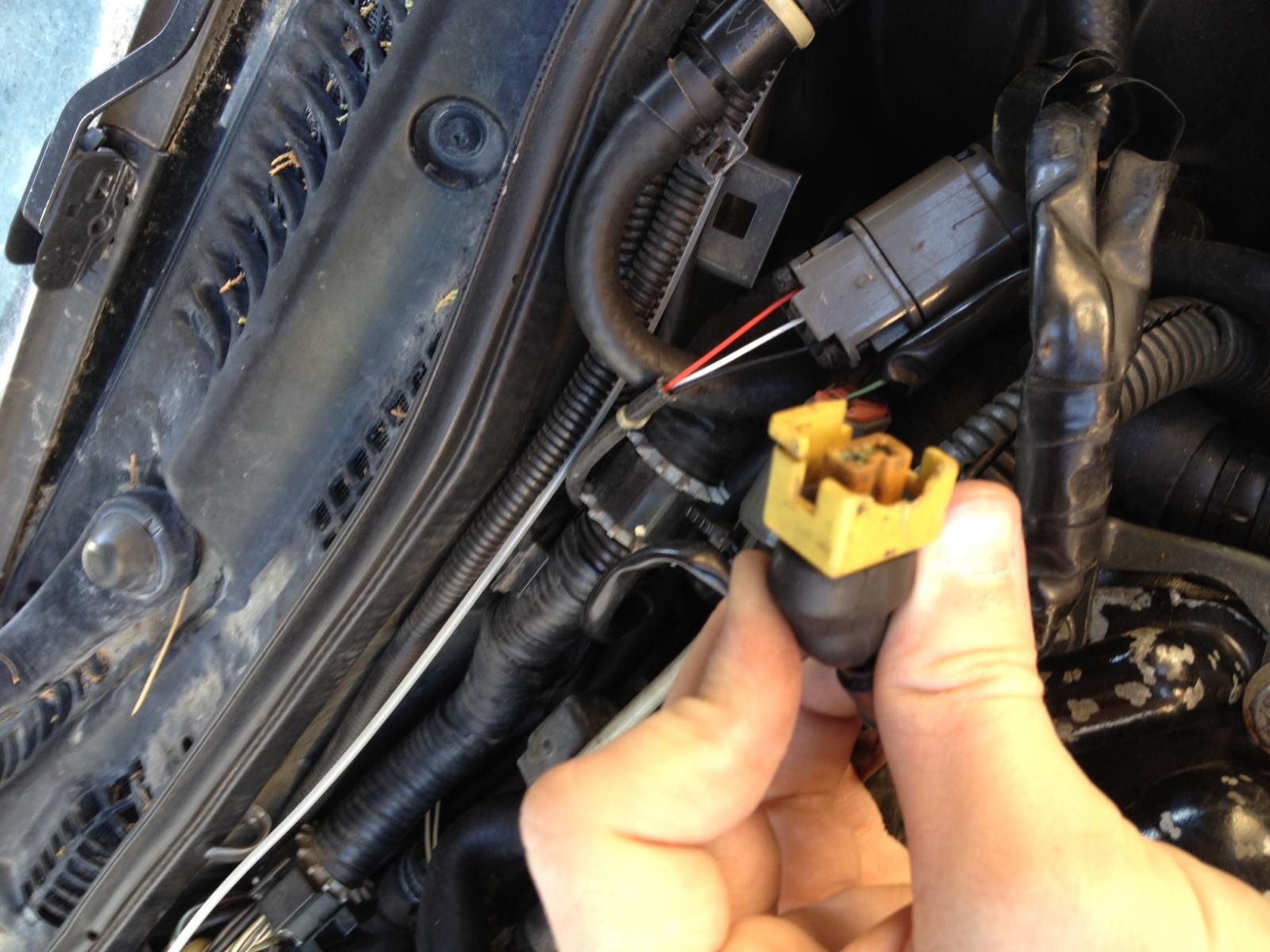

The engine had to be pulled when the turbos were replaced so I'm not sure if maybe something was not hooked back up right or not. There are 2 wires that are not connected to anything (from the wiring harness). Here are a couple pictures of them attached, if someone could help me identify what they are and where they should go I would greatly appreciate it.

PS> Pictures 1 and 3 are of the 1 disconnected wire on the driver side, picture 2 is the disconnected wire on the passenger side
