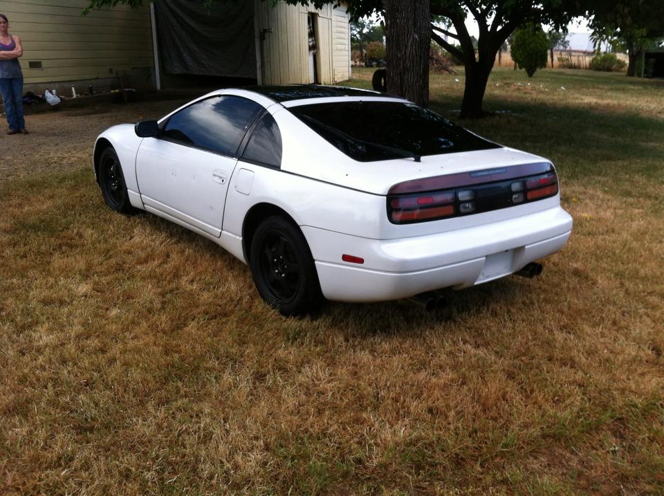

here is the car, its rough and whoever owned it before me deffinetley had the vision but not the funds or the perfectionist attitude. everything done to the car is like a 6/10 effort ha
ill post more later, it is not my dd so it will end up being my money pit that i take my time on
