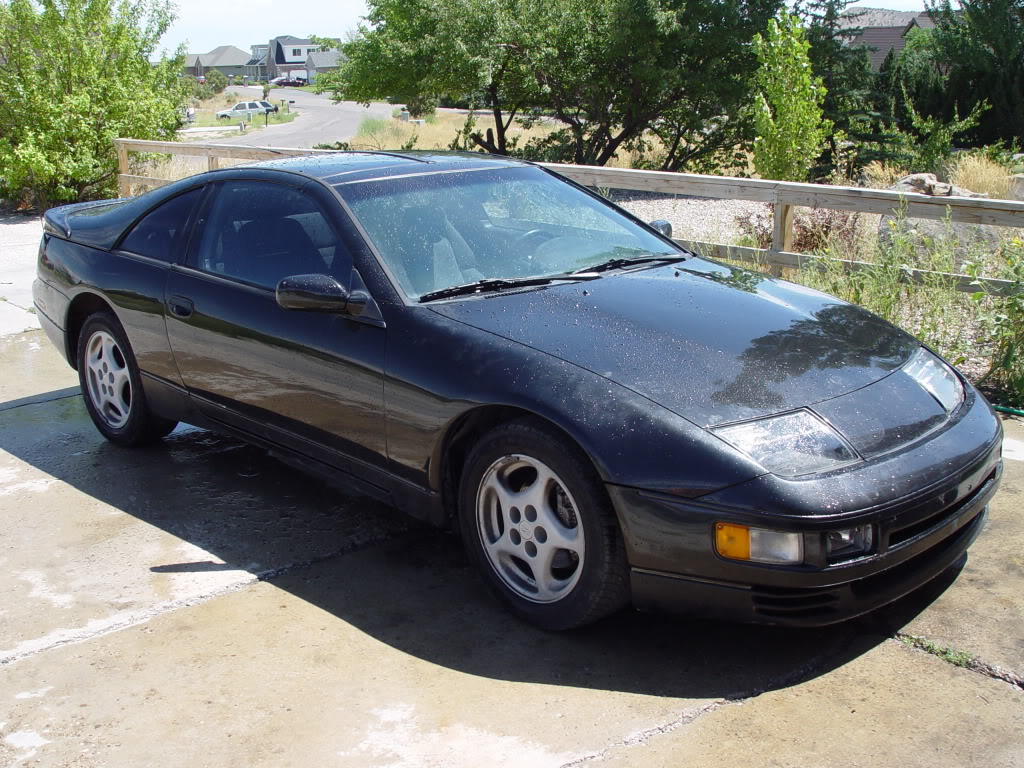

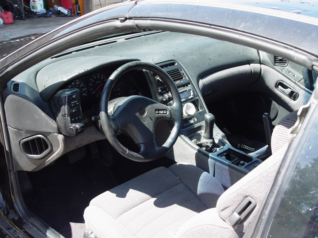

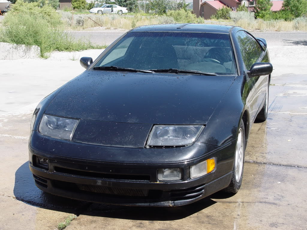

1990 300ZXTT 2+2 with a 93 AutoTT Engine tho its a 5 speed now.
$750 and he let me have it. now to fix the blown TT in it.

Start from the ground up. It'll need it. lol
At least you can do it as you want it, though, and are not bound to the former owner's bullshit.
P.S. The front wheels are on backwards.
I noticed that after I took the pics and I didnt feel like changing them for new pics lol
And yes Nismo, that is the car from hell, and now I do own it. I'm asking myself "WTF AM I DOING!?" But I think it might turn out ok lol

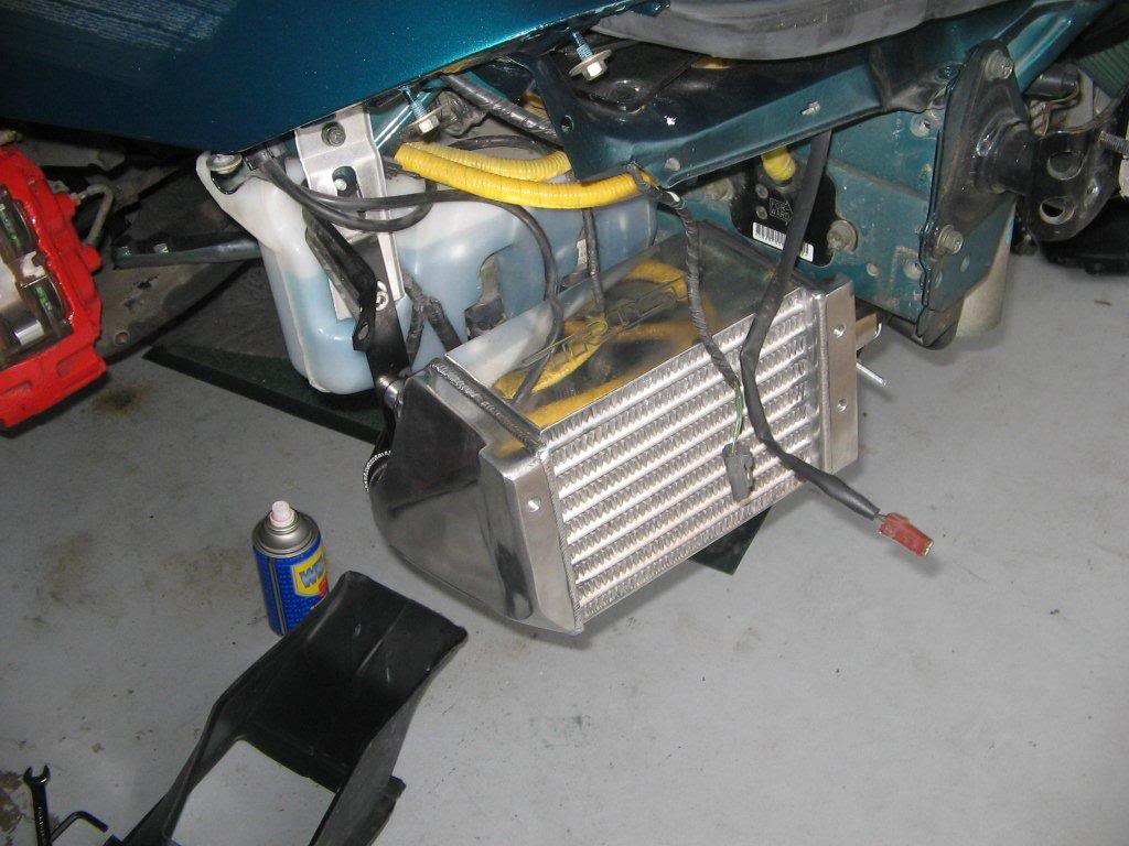

Well I went down and talked to my machinist friend about the engine and to see what would need to be done with it. We wont know till we tear into it to know what will need to be done but the engine kit for it was close to a grand. so I'm looking around $2K Then we will rebuild the turbos or send them off to be rebuilt as well. I'm also looking for a new proper FMIC and piping instead of this shitty one and crush bent exhaust pipes.
I also want to get a new EFI harness too, where do you guys get those things at? I'm assuming the dealership.
Not to sure what else I should change as I think that covers all the bases engine wise. Maybe a turbo timer. And maybe an EBC.

There's really no such thing as a "proper FMIC." There are SMICs, and the TDM Works FMIC (which isn't bad, but will still block airflow for no benefit), and then other FMICs which don't perform as well as SMICs.

You can see the FMIC in the pictures and its hangs a bit to low and the angle of the pipes coming out are horrible. I'd put SMICs in if I could. but I honestly have no idea how they would mount...to me it looks like theres to much stuff where they would go.
... Tho I dont know how big the SMICs are...

Judging from what I can see, the FMIC on that doesn't look like your typical ebay trash. If you want to get froggy you can always make an airbox and seal the radiator to the core support. I noticed a 25 degree drop in temps by sealing the radiator to the core support and by sealing the shroud of the electric fan to the edges of the radiator.
I'm about to build an air box for my sisters TT so I should have dimensions and pics up in a week or so.

ya its not an ebay IC And that sounds interesting. Tho I just want to run new IC pipes but the angle the pipes come out of the core are kind odd. most of the pipes have a U bend at lest once in them because of it.

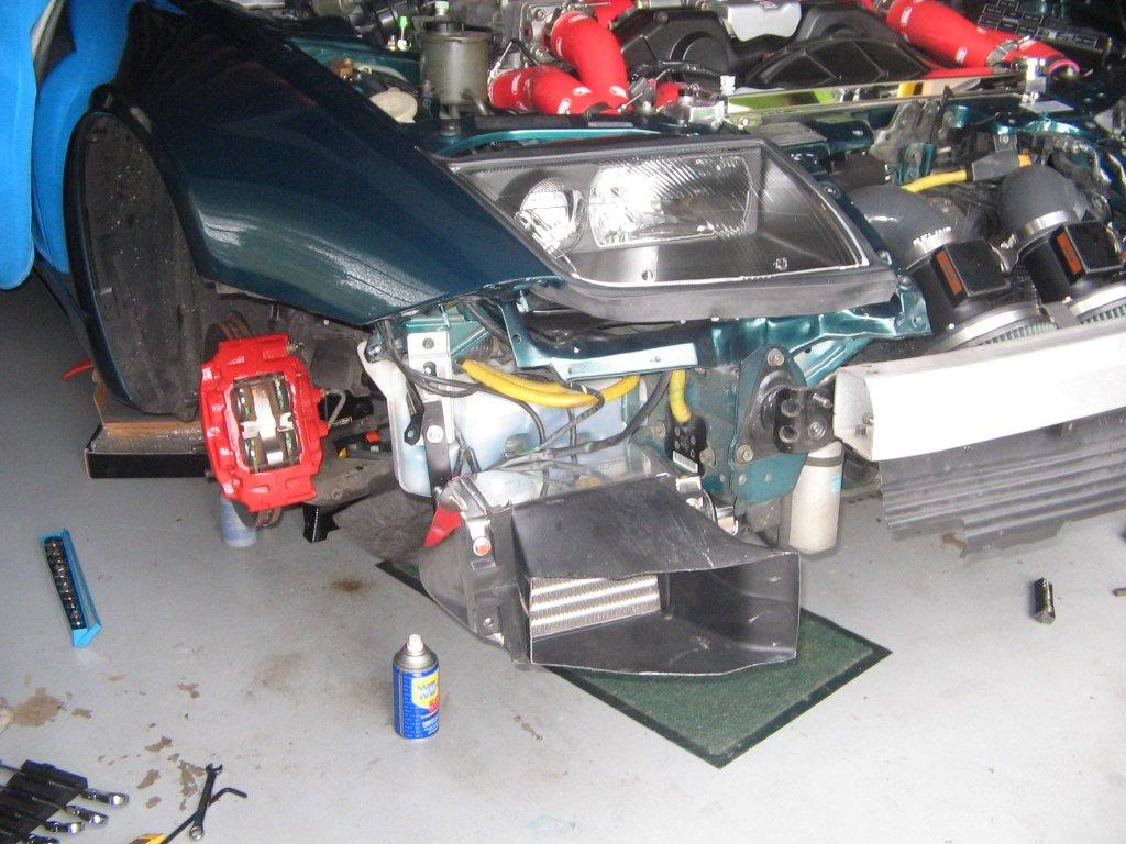

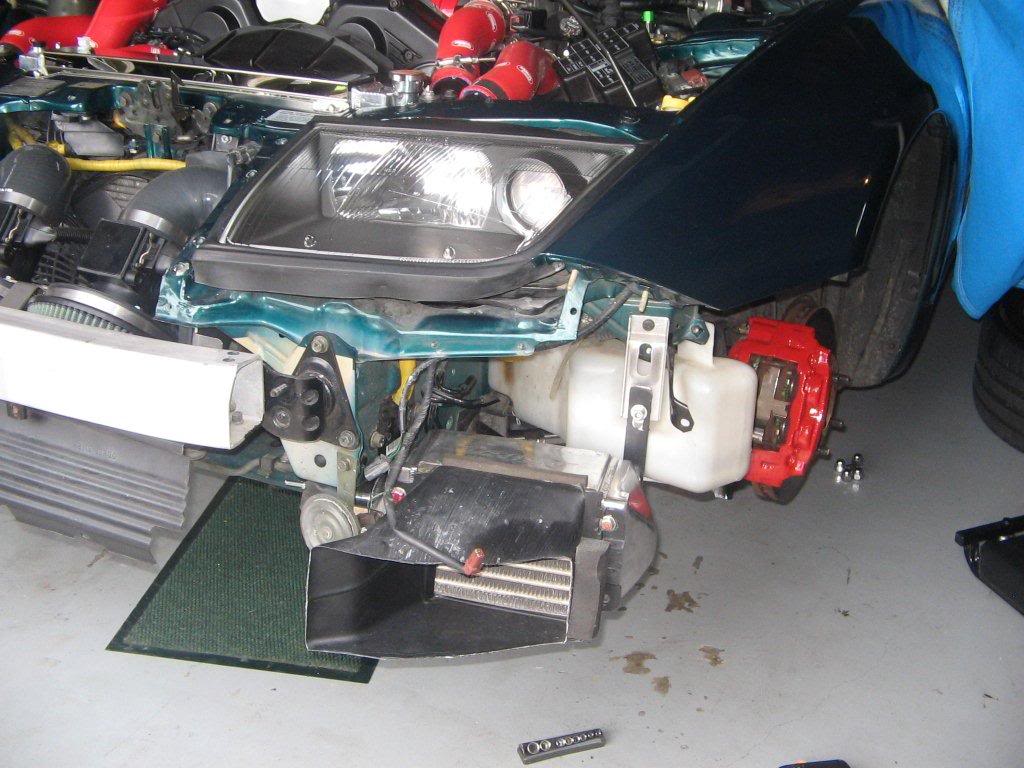

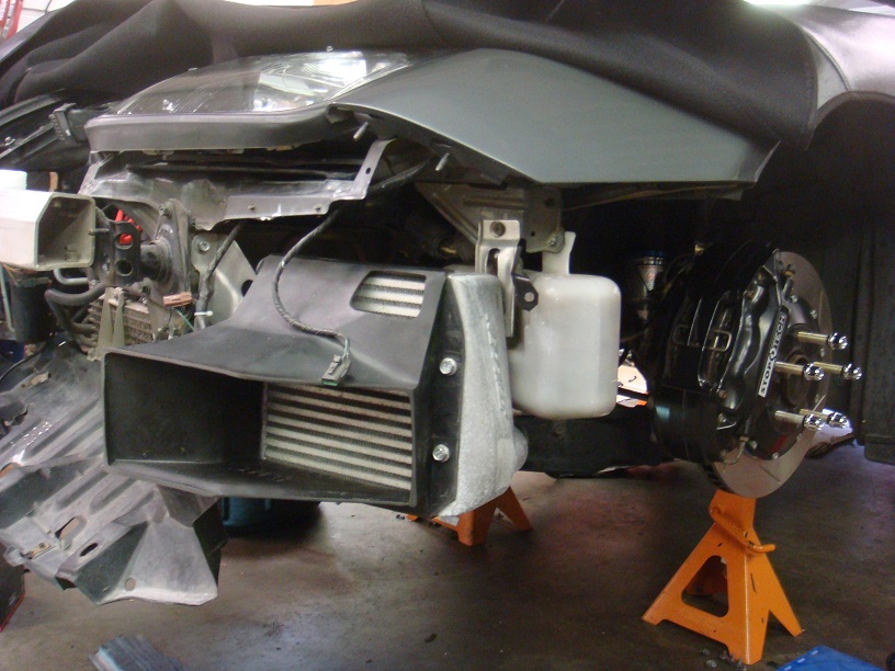

With the exception of TDM Works' FMIC, SMICs > FMICs. Less pressure drop with just as much volume, charge face, and ambient air face, all without blocking any airflow to anything that needs airflow. Consider the people who built that car... do you really think they had performance in mind when they put that intercooler in? In general, the smart money goes to SMICs.

Old Aug 19, 2010 | 05:57 PM
BlueKitsune's Avatar
Intrawebz Wizard
Joined: Feb 2009
Posts: 3,176
From: Vernal, UT
I see! I like that! Much cleaner looking too I wonder if I can find a junked TT and get the IC pipes and side mount hardware. I'm not looking for high performance, just enough to get this Z back on the road reliably.
