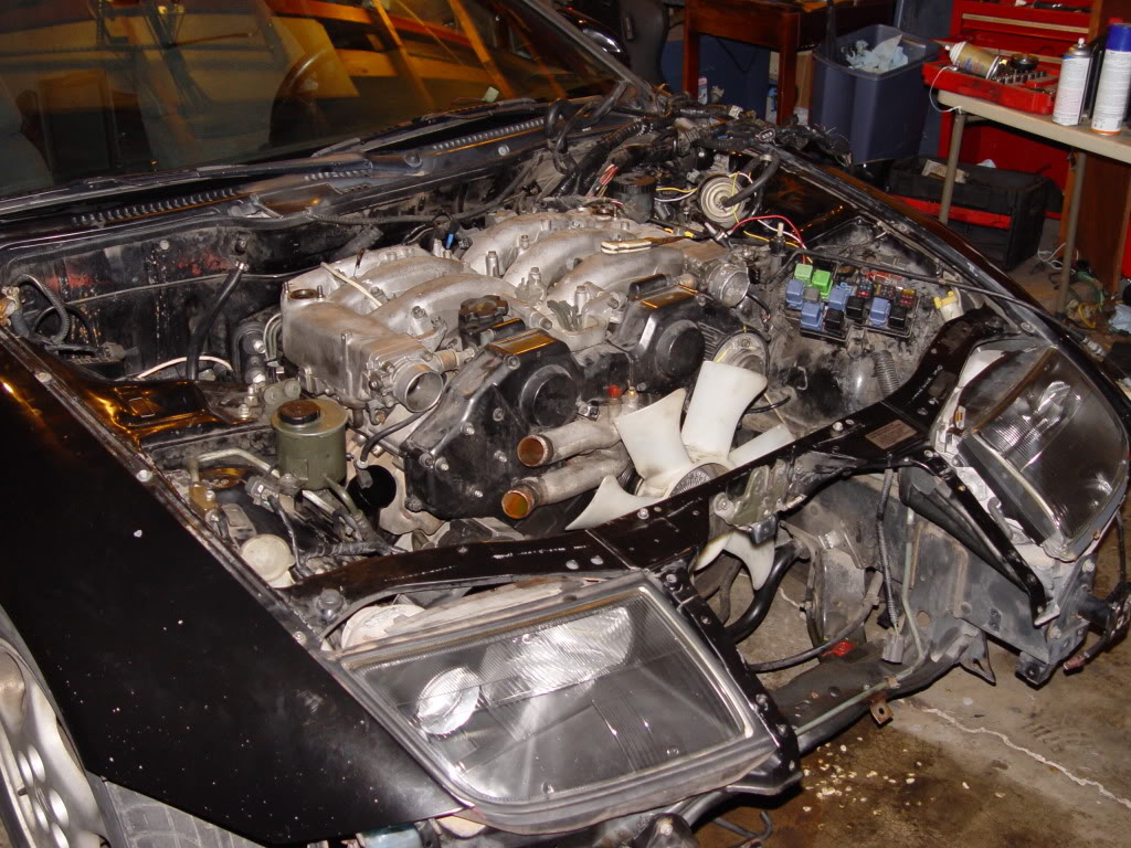

Well heres the current state of that Z

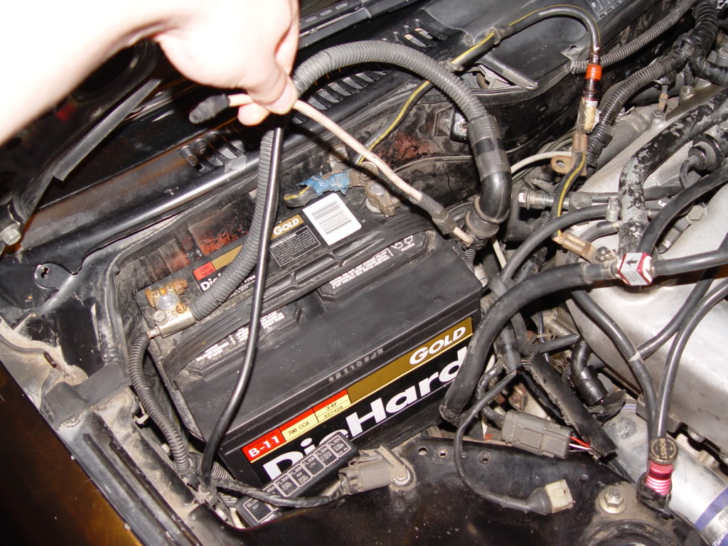

And here is this white wire that I can NOT find where it goes. but I "think" it has something to do with why my interior lights and radio doesnt work at all. The part thats going down just goes right to the starter no where else.

I'm think that white wire goes directly to the battery + terminal, but the length makes me worry... I'll think about it and post back if I come up with an answer. You could always try it, though... it's a white wire, it's definitely supposed to be hot, rather than a ground. Connect it and see if that solves your problem. (The reason I can't recall for sure, by the way, is that I relocated my battery to the hatch and simplified all the wiring.)
And your intake ducting makes me want to cry. Get some real intake piping in there, please.

Actually the line is of of the battery, look at the black cable cover its going into, so its actually a hot wire(hence the tape on the head so it doesnt ground out and fry something) and idk where it goes....
And I know its really horrible thats why I'm looking for the stock SMIC hardpipes and an aftermarket set of silicone pipes.

I thought it was just sharing that sheathing with the positive cable... it is connected to the positive cable, though? (You tested with a multimeter?)

Yes thats how I know its a live wire. 12v same as the battery and I have pulled that entire cable out to make sure it only goes to the starter to that wire and to the battery, no where else.

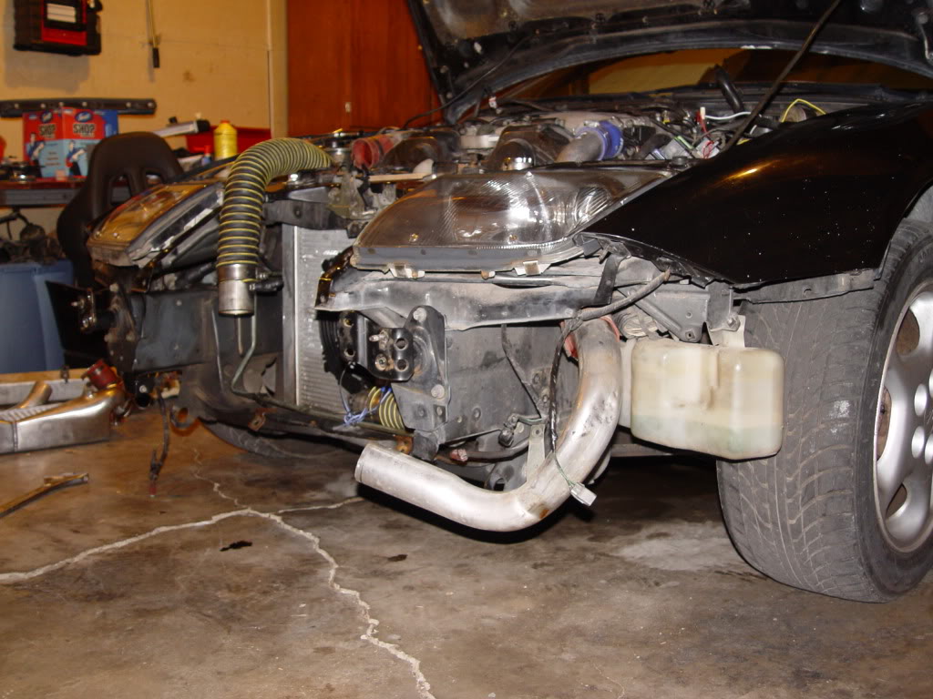

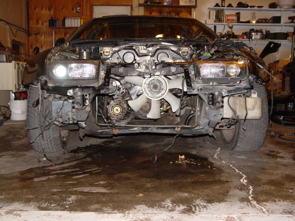

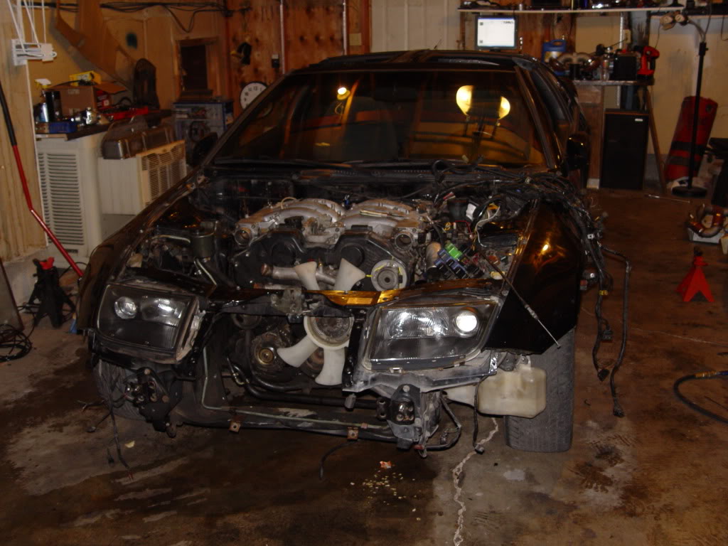

Starting to prep the motor to be pulled. I got a jack that might work to hold the trans so I dont have to bull them both at once. idk which will be easier.

I never pull the trans with the motor, but you can't just leave it in its normal place (you'll never get the trans stabbed when you put the motor back in). Lower the trans to the floor.

... I didnt even THINK of just leaving the trans alone and unbolting it and leaving it in there! And I can take the trans out at a later date to stab it back in seeing as I wont get the motor ready to go back in for months probably.
