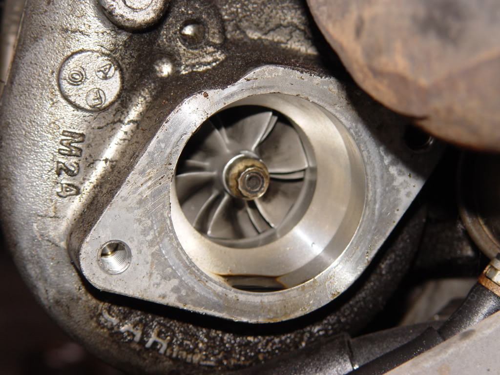

How much are the stock Turbos worth? Their still barely within there wear limit by the looks of it. Oh and thats with the manifolds and heat shields and such.

Used stock turbos with pre-cats are worth about $600... not sure what the rest are worth (I only know that because I had to sell my stock turbos). Search classifieds to see what people are asking for them.

This JDM engine doesn't have precats oddly. You can look inside the downpipes but theres not even a hint there was catalytic converter stuff inside.

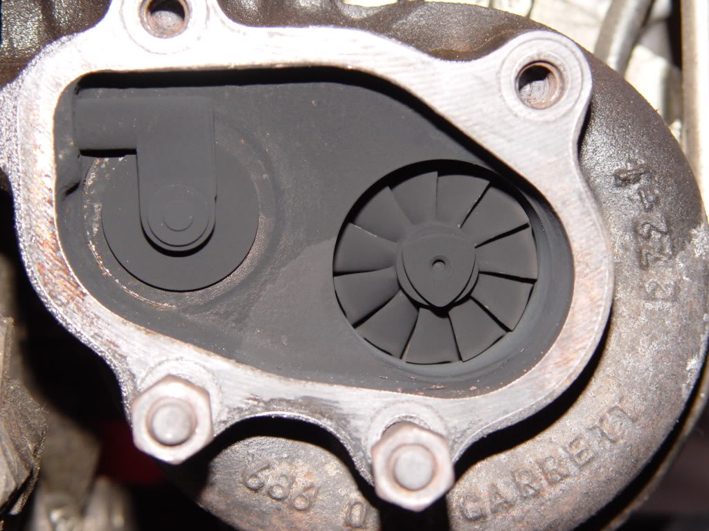

Ok I want to make sure of this before I sell the trubos off then find I still need something off of them.
I plan to buy these https://specialtyz.com/shop/300zx/jwt-sport-550s.html
And the AMS Manifolds too. http://www.z1motorsports.com/product...oducts_id=3696
So I'm wondering if I need to save anything of the stock turbos before I sell them. the only thing I can think of is the oil/coolant lines.

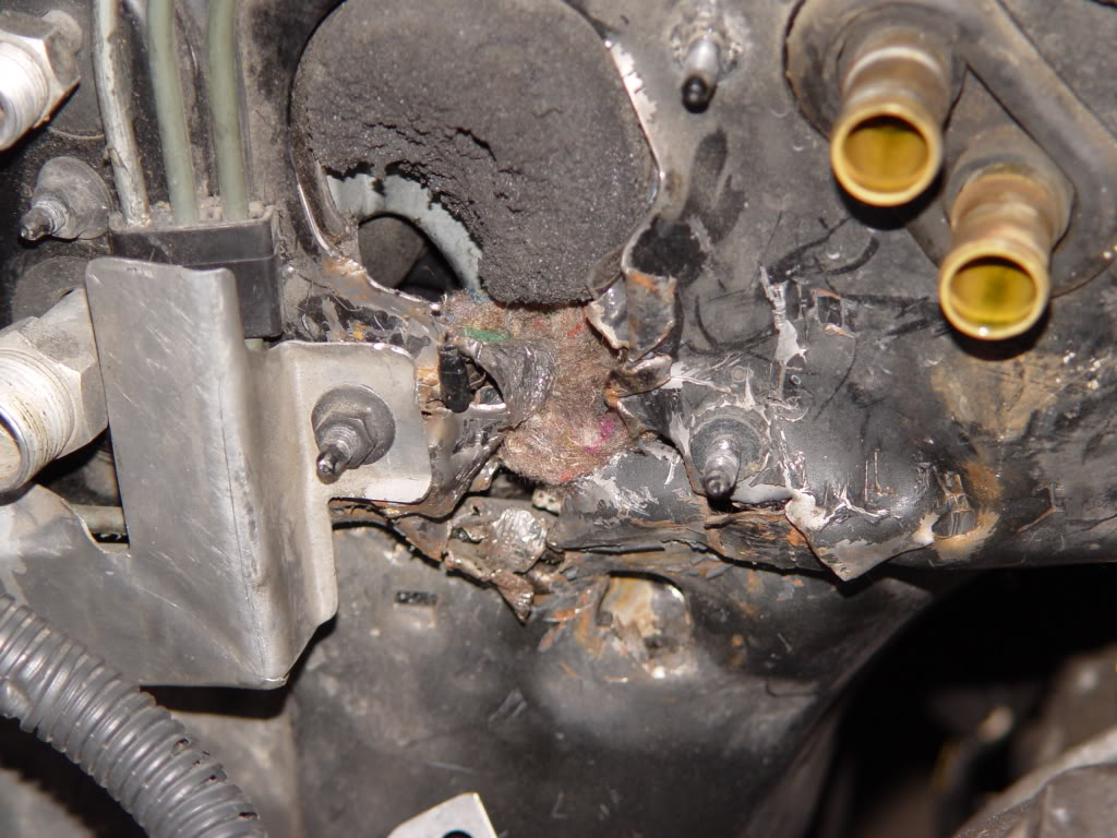

The hole I was talking about.

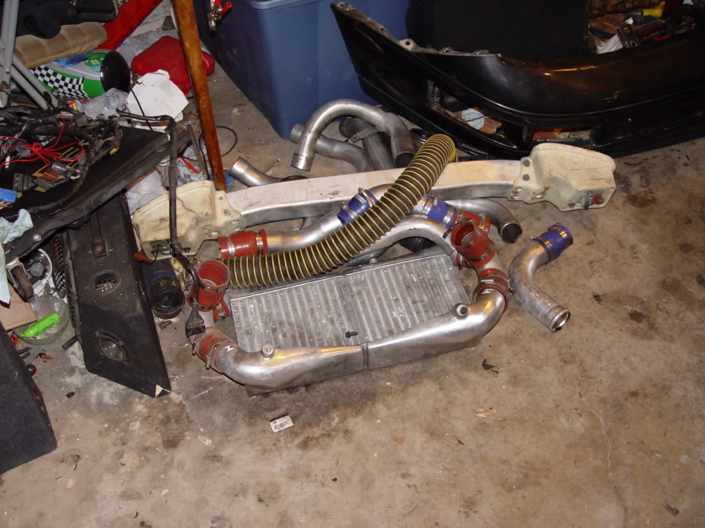

ALL the old IC stuff
Passanger turbo

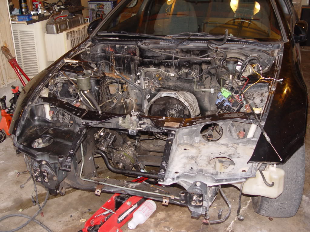

And the Z as it sits right now

You do NOT need the oil lines from the stock turbos. In fact, you should absolutely not use stock lines with ball bearing turbos - you'll destroy them.
The turbos should come with their own restricted oil lines, and if they don't, get these.
Thrust bearing turbos require substantially more oil than ball bearing turbos, so the original lines don't have the proper oil flow rates.
You may need the coolant lines, if the new turbo kit doesn't include them.

JDM motors have interesting parts on the outside. I think I need a new remote filter bracket thing sense the oil pressure sender was on the turbo hardline on the drivers side. instead of next to the oil filter. Also it has no precats. the JDM downpipes are much different then their US Pre-cat counter parts. theres no cat material on the inside at all, and their shaped a little smoother. I'll more then likely end up selling those with the turbos as well.
Old Sep 1, 2010 | 10:55 PM
  #89
ZLover4Life's Avatar
Encyclopedic Knowledge
Posts: 3,316
From: Naperville, IL
They're called quarter pipes and they actually use NA cats to bolt up to the TT system. Nobody in the US will have any use for them, really.

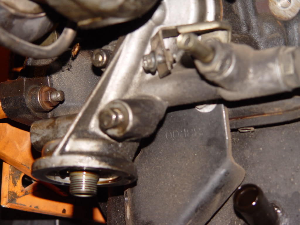

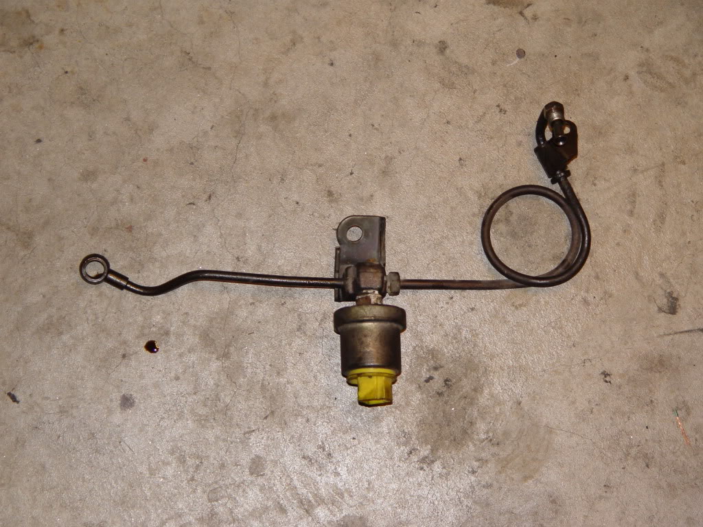

And what do you mean the oil pressure sender was on the turbo hardline? Pics please.

photofailure is offline so I'll upload pics later. and ZDriver just keep saying it failed.
And I was wondering if they had a name... Thanks
EDIT: There we go. PhotofailureBucket is working

wtf were the people who worked on that car thinking?
That's not even a good place to get an oil pressure reading from. The turbos are high up on the food chain when it comes to oil delivery, so you could have a problem after the turbos and never know it with a setup like that.

As far as I know thats a stock system. I dont think the idiots that put this motor into the car have that kinda skill to make something like that lol
So I guess I need to add an oil filter bracket onto my parts list too. Theres no way to mount and oil pressure sensor that wont hit something with that stock one.

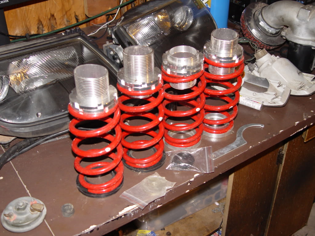

Oh my friend gave me these yesterday. He said their for this 300ZX but he never got the chance to install them.
Ebay junk?
And yes. the back of that turn signal casing has been cut off. so it would clear the old FMIC piping.... I didnt do it.

Yes to ebay junk. They're knock-offs of Ground Control Coilovers. If you want to drop the car without spending bookoo bucks on coilovers, check out www.ground-control.com for adjustable height coilovers that mount to stock of aftermarket struts.
And before you install those, I've seen the aluminum collars spread and begin to split after use. Last thing you want to happen is an aluminum collar sheer off and allow the strut to bottom out with no support as you drive.

I never said I was going to install them. Their actually just gonna get tossed in a box and sit on my shelf till I feel like finding a use for them. That or if someone wants to buy them or something idk. I already decided on eibach springs and KYB shocks.

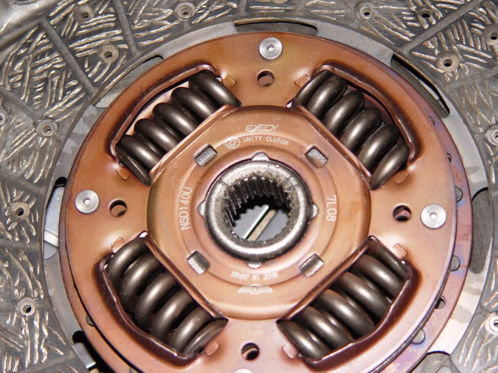

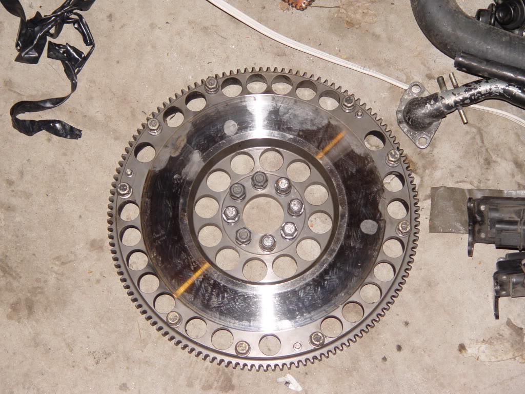

Oh ya, about 10 miles ago (yes thats how far this car has gone sense I did the trans swap) I put these in. Idk what kinda flywheel that is its but its cool looking lol
Think only after 10 miles their still safe to reuse?

Of course the clutch and flywheel are fine after 10 miles.
