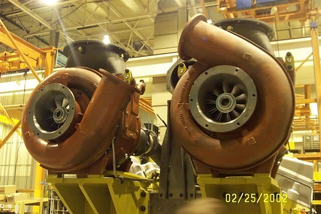

Spot on! These are the turbos for a VG33:
