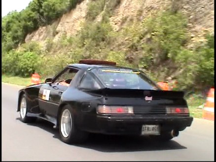

PS: Here is a picture of my ride
Attached Thumbnails Stand Alone ECM using stock distributor and coil question-team-marios-ride-4.jpg
