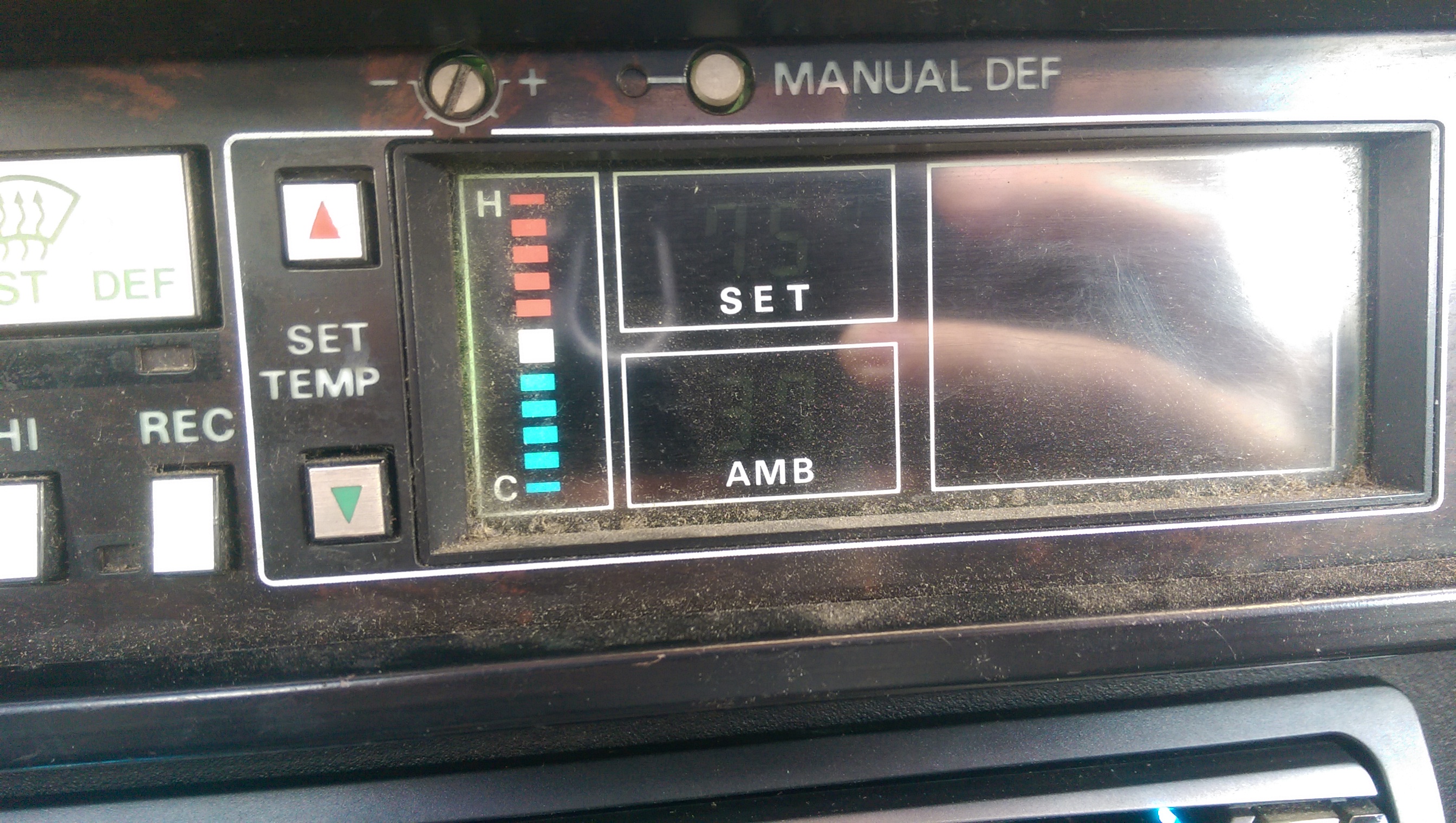

My digital dash went out on my 1984 2+2 NA. The outline of things still lights up and my dimmer works to dim those lights, but all data such as RPM, Gas, MPH, Temp etc are all gone. It went out a while ago and a day later came back on for 10 min and now it is out for good. I pulled the Power Supply Unit and re-soldered the connections, but that did not help. I also tried wiggling the connection and nothing.
If anyone happens to be in UT with a similar car and would not mind helping me test it with a working Power Supply Unit so I can verify if that is shot would be fantastic. Switching to analog is a bit daunting especially since I don't know a ton about cars, but can follow directions
I do recall a few years back when going through puddles of water, it seemed to cause issues with the the cars electronics. I avoid puddles now. Anyway, if there is anything else I can test such as a fuse or anything else.

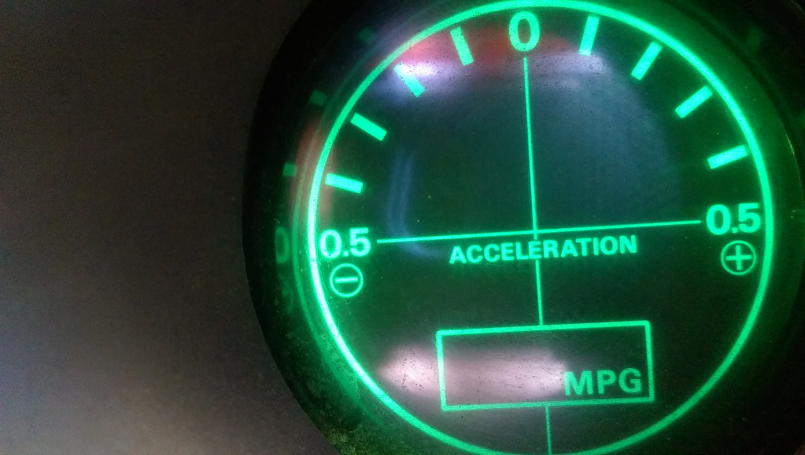

My MPG and compass are also out. The surroundings of it still light up, just no data on them. Those also used to work and went out before my dash. I did see a bulb laying in the back of the dash so maybe that just fell down and that was used to light them up?

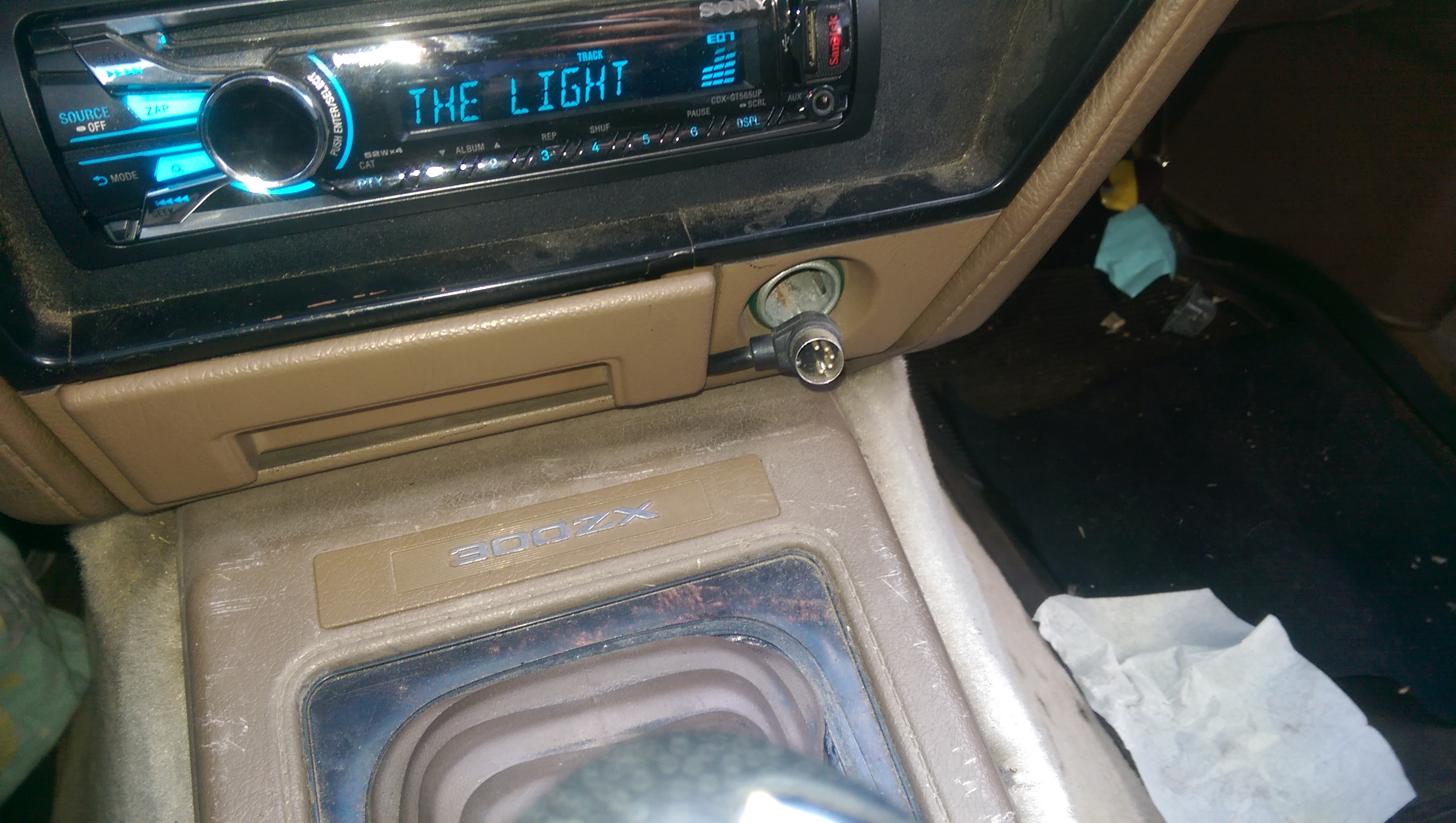

Lastly, while I am thinking about it, there was a wire I found behind my coin tray / ash tray that had a connector with several pins in it. Unsure if this goes to the cig lighter or not.... never used it before so I am not sure if it even works. Any help / advise is welcome.
Edit: added pics. The bulb might be for my temp display that is laying in my dash...

I had to buy a old\new unit..there's a guy on Ebay that sells them refurbed..good guy to work with. a real PITA to change out though..but with determination all is possible.

My dash was winking in and out for a while. Then it finally went dark like yours. At first the tach was going all crazy...then if memory serves me, it went dead. I tried soldering the P\S but that did not work so I went for the dash. You'll get to know your car intimately when you have it all apart. To my knowledge there is no way to change it out other than pulling the whole dash board out. If you get someone to assist you in lifting it out it makes it a lot easier. But once you get it done, you'll be very proud of yourself.
