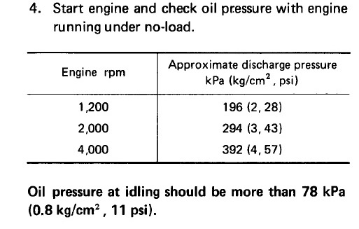

So I'm deciding what route I should go when I change the oil. The previous owner put in 10w-30 and on an engine that will have about 160k miles when I do the change (and in Northern California summer/early fall), I have to wonder if maybe that's a little thin.
The manual says the pressure gauge should read between 30 and 60psi. Assuming it's even reading correctly, it's typically maxxed at 30psi when it's cold first thing in the morning (and has never gone below what I'd estimate is 15psi). Plenty of oil in the engine, etc. Just wonder if maybe I ought to go with a 20w-40 or 20w-50. Thoughts without stirring up a firestorm?

10w-30 should work just fine for the environment you in. I would only use a thicker viscosity if the car was driven under harsher conditions like crossing Death Valley every day or persistently getting jamb up on the LA freeway. If I remember right, northern CA is fairly temperate.
If you are truly concerned about oil pump pressure, the only sure way to test the situation is to remove the oil pressure sending unit on the passenger side of the engine and plumb in a temporary mechanical gauge. The attached file contains the oil pump discharge pressures at specific RPMs on a warm engine from the FSM. At 153K on my car, the actual values were damn close to the published one. If I remember right, at idle the spec calls for only 11 or so psi. Again, I see no reason to switch from 10W-30 oil.
Attached Thumbnails I Might be Getting a Z31. What Should I Expect?-oil_pressure_chart.jpg
