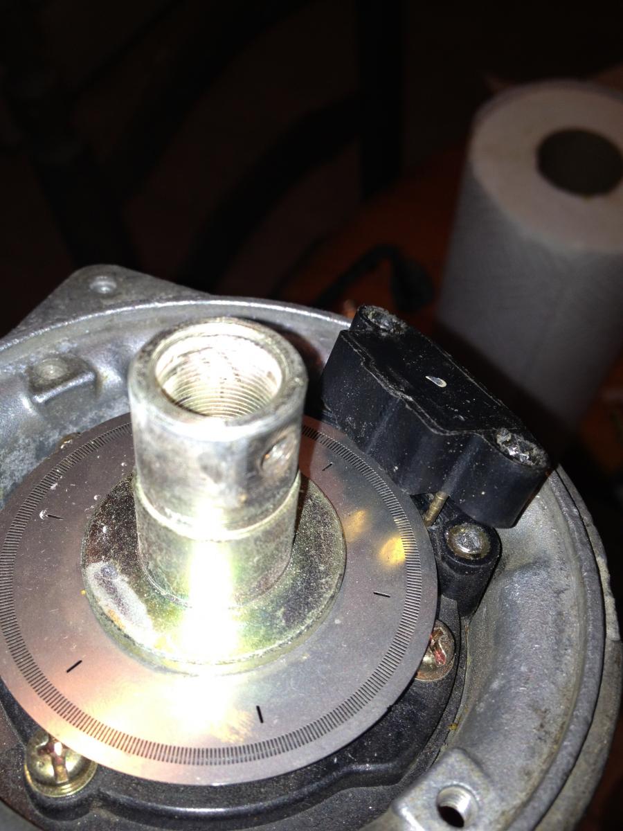

I had a problem similar to this several months ago and it was my distributor/crank angle sensor. The distributor has 2 UV LEDs inside with 2 UV led receptors and one of my leds would not work consistently. There is a metallic disc inbetween the 2 sets of LEDs that have slots cut in it (picture) which tells the ECU when to send a spark, I'm not sure what the smaller ones on the outside are for but the larger inside slots are for the spark plugs. If it was my car, id be swapping the distributor.
Good Luck!

rogerz...Thanks for the clarification. I was 99% sure that was what the part was so I got a used one last night from a wreck and swapped it out. Same issue.
After talking to a mechanic friend of mine, I am also leaning toward the distributor now. I am just trying to decide whether to go new/re-manufactured or grab a used one from Steve a 300zxpartsforyou.com.

Great call Monkies! I replaced the distributor last night and all seems to be going great. I ran her in the drive way for about 50 minutes last night and then about a 20 minute road test with no issues. Started her up this morning and drove to work. No cut off, smoother/lower idle and bit more power it seems.
Swap out was easy as well. I got lucky and the rotor was pointing at the corner of the plenum cover so I had a great point of reference to line up with. Thanks for the advice!
