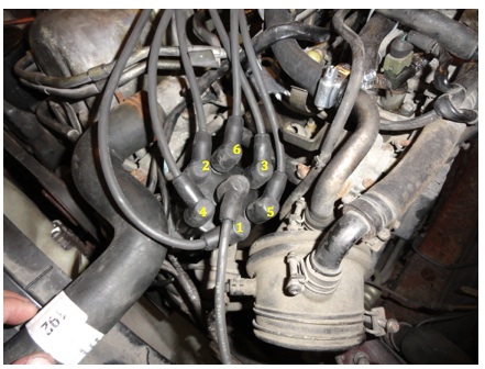

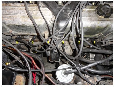

Photos of Spark Plug assembly
This is what it looks like from the distributor Cap to the spark plugs.

your #4 wire is where #1 should be. pull the valve cover jack the engine around until the first two lobes of the cam shaft are pointing up and out kinda like rabbit ears. that is TDC for #1 cylinder and that is where the rotor should be pointing towards the front of the engine and that is where the #1 plug wire goes.

On the distributor cap right? Because i look on the cap and there is a #1 symbol on it. I got confused because all literature says other wise.
And by moving the #4 to begin #1 everything moves also right?

Thank you everybody for all your help!!! It started less than 5 min ago. I am so stoked! Once again thank you!
