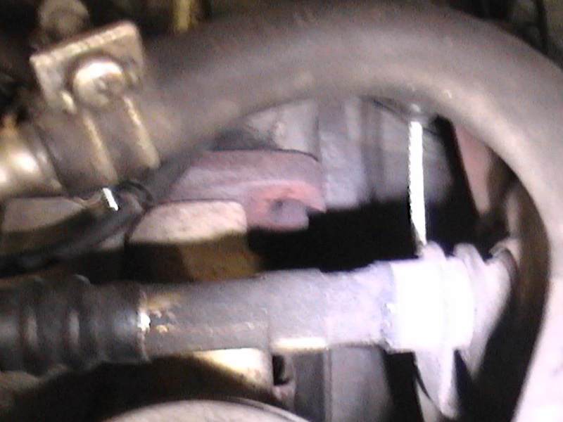

Sorry about this really crappy picture, but I was looking at my Turbo. And this is around the area where at least part of the leak is. This is from my 2+2 by the way, but there's like a little open ended piece of metal that looks like it's the exhaust manifold attached to the head. There isn't anything sticking out of it, and there isn't a nut. I look in there and it looks like maybe a stud, but like there's no way to get at it? It looks the same on both my Turbo and my Non-Turbo. Is this correct? Also I know the Haynes says there are 8 bolts and 2 nuts attatching the manifold to the head. Are the other bolts not visible from the top? If anyone could give me locations that'd be appreciated.
all the bolts are located under the intake manifold. Some are shared by both the intake and exhaust manifolds. If you remove the little access plate on the top of the intake manifold you'll have access to one of the exhaust manifold bolts and be able to see 2 more. Both the turbo and non turbo exhaust manifolds bolt to the head in the exact same way. The two studs are at either end of the exhaust manifold.
and uh...that must be a really crappy picture cause I dont see a picture at all
But the studs are visible and above that plate? Oh and I updated the picture. I'll see if I can find a camera to get a better one.

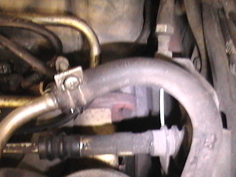

Here's some pictures of what I'm talking about, they're kind of crappy, the camera isn't great, and there wasn't much light. Like I said I can't get at a good angle to tell, but I would think this is where a stud or something would be. There appears to be nothing sticking out as I can stick my finger in there and I don't feel anything sticking out. Like I said this is the same on both cars. One of the bolts, maybe some more felt kinda loose towards the front of the head. I'm just really hoping I don't have a broken bolt or stud. If so I think that might be the only thing I take this car to a shop for. I'm really not the type to start dealing with drilling broken studs or bolts. Oh and even having a slight exhaust leak. Is that something that would effect performance or anything? Or would this just more than likely be something that's just there and annoying to know I have it?
And here's a pic of my Turbo Z(my brother took this one).
EDIT: Well I was searching and found thxone's post about his exhaust manifold. Looks like what I've been looking at is the famous rear broken stud. I'll have to ask the mechanic that we know for help with that one.
