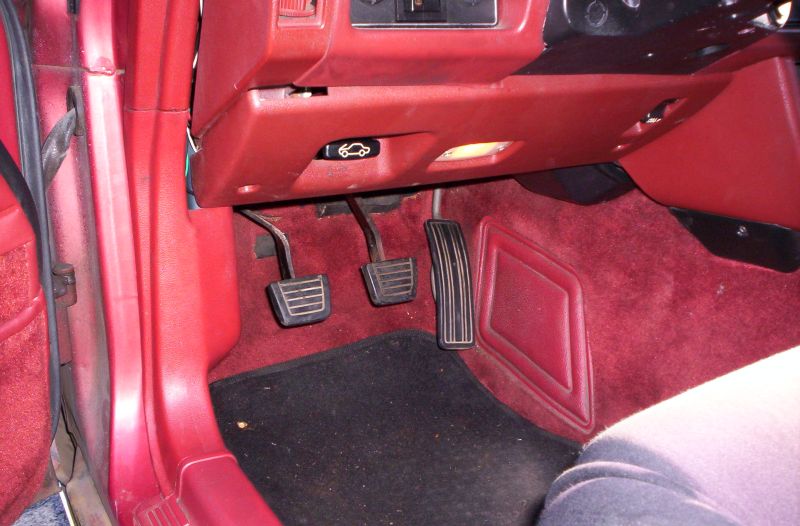

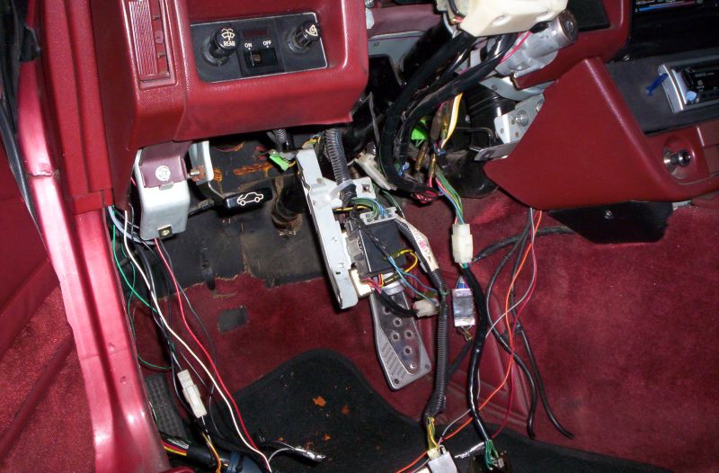

Old Jun 27, 2006 | 06:04 PM
  #30
81 Black L28E's Avatar
Posts: 1,046
From: squwamton
yes yes yes
so stoked 5 speed pedals and clutch master are installed .....
for anyone that is thinking of doing this swap ........do it!!!!! but be ready for it to be the biggest bitch that you ever tryed doing ......yES BLEACH YOU HAvE TO SWAP PEDAL HOUSINGS ...SO freaking hard but its done now.....
on to the clutch line and trany its self ....will i need to swap drive lines? i can i just dont want to if i dont have to .......

Old Jun 27, 2006 | 09:17 PM
  #33
Driveline: I dunno... I'm just a noob
Clutch: I always say just to use a stock clutch or a stock 'turbo' clutch if you want more grab. You have to get a 2+2 or turbo 240mm flywheel but those grab good and are just as cheap
Old Jun 27, 2006 | 09:25 PM
  #34
lww's Avatar
lww
Head Muckraker
Posts: 9,221
From: Bay Area
Yes, you'll need a drive shaft from a Nissan 5-speed.
Old Jun 27, 2006 | 10:21 PM
  #35
Posts: 1,046
From: squwamton
ok i will pull that drive line in the morning .....
now that clutch? iam using the 79 stock flywheel and 5 speed trany so i should get the 79 stock clutch ??????...
mabe this week sometime i dont know i still need a little cash .......
dam it on that drive inline. i hate getting under that brown piece of **** !!!!!
Old Jun 27, 2006 | 11:00 PM
  #36
lww's Avatar
lww
Head Muckraker
Posts: 9,221
From: Bay Area
Don't sweat it. With the tranny already out, it's only the bolts on the diff that need to come out.
Old Jun 28, 2006 | 03:34 AM
  #37
Yes and there are only 4 bolts and nuts holding the driveline to the rear end. You have 4 bolts with a flat space towards the middle. (assuming the drivelines are the same bolted on the rear end) So they don't turn, when you loosen the nuts on the backside of the driveshaft. The nuts are 12 mm, and you put it where you have access for using a hand wrench. And as you take the nuts off, turn the shaft, so you can get to the other ones. Just be careful, you don't drop the nuts, I did, and they were a pain to find. Otherwise, after that, it drops right out of the rear end, and under the car. And then to install the 5 speed one, just do it the opposite way, and bolt it back together, and you are golden brother. Pretty soon, here, I am taking the driveshaft out of my '81. It is so friggin' simple, except for the fact of catching my gear oil out of my tranny.
As for the '79 clutch, yeah it should work fine, just make sure it is still good. Like the disc, throwout bearing and such. If you have any doubts replace the parts you feel, need it. So you don't do more work than you need to. As for my clutch setup. I have the Centerforce clutch plate, and Duralast disc, and throwout bearing. And it shifts without any slip, pretty sweet.
