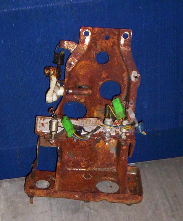

yes young jedi ...i have now almost gatherd all of the parts needed for my 5 speed swap ....i still need to buy a tight clutch ..anyone out there have any good ideas on a realy good one then post me a link o have two clutch slaves that look ok.... if one works i will be golden ..if not i will have to buy one of thoughts two ...everything is layed out so almost time ....bleach any last thoughts ..i lost that email you sent with the pics...could you mabe send me them again and a little info ..i dont was to mess this swap up ....i will pm you my email ...
Old Jun 26, 2006 | 08:30 PM
I dont' have the pic of the clutch line anymore. Its not too difficult. I just made two gentle bends in it. Hold it up near your firewall and see how it might unfold to reach across. Let the force be your guide.
You are going to need more than just the clutch and brake pedals. I heard you need the whole manual tranny pedal assembly as your auto won't have the brackets for the clutch pedal. I'll send my droid to fetch the parts from my junkyard.
Old Jun 26, 2006 | 08:49 PM
Here it is, the assembly above the pedals that holds the pedals. Your parts car may have this but if you don't have it anymore, I can send you this one.
Old Jun 26, 2006 | 08:54 PM
man that part is nasty, and has no pedals, i got one too dude, 15 bucks. no rust either!!! you will need that swing arm assy. the auto one has no provisions for a clutch pedal
Old Jun 26, 2006 | 09:33 PM
he already has the pedals from this 'nasty' part, and this part is free... delivered. that is, if he needs to use this rust bucket.

looking under there in the moring but i think it has the the backet under there already ...i dont know for sure but i was under there befor and it looked like it had it already if not the one that is in my parts car is good i just took the springs and bolt out of it today.....i will let you know tomarrow when i start digging around under the dash....my plain is to install the pedals frist then move on to the the other stuff .....
