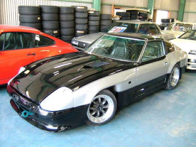

Didnt want to start a new thread. Just a quick question? What body kit/style is this.
There used to be a red one featured on Overboost.com ... looks like that website is no more. Though HBZ posted pics of it: http://forums.hybridz.org/index.php?...t-racing-team/
