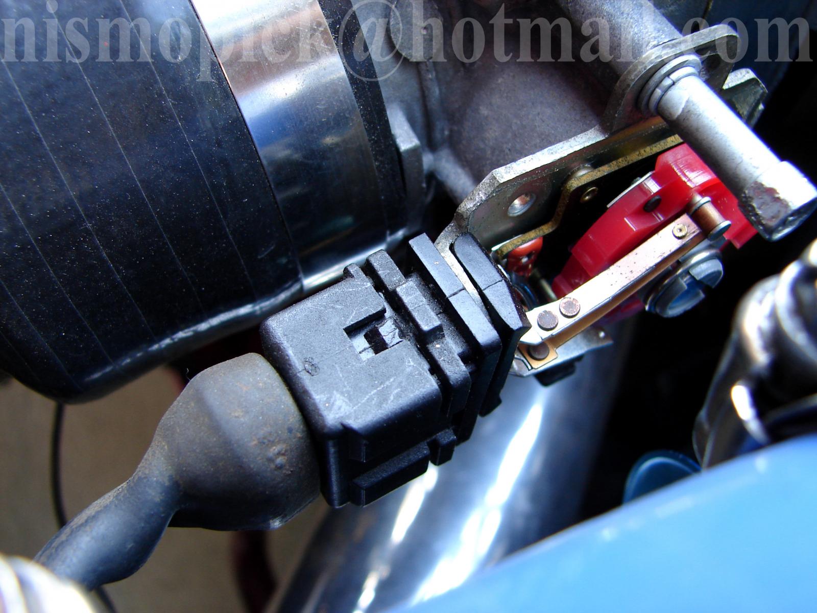

Before you blow your money on a new tps and have it not be the problem (I doubt it is), why not try adjusting the tps first? You can remove the black cover and check the contact points for corrosion. Then you can re-set the tps to the correct contact point... Pics from this thread:
https://www.zdriver.com/forums/280zx-s130-forums-77/240sx-throttle-body-hook-up-29240/

Got the case off and found that a tab was broken. If you look at the pic nismo posted the red part of the tps with the two tabs sticking out was the broken part on mine. so im going to try to get that tab back on there and see if it works.And one last question well statement, my tps look a tad different than the one in the pick
Old Sep 2, 2010 | 07:24 PM
Yeah, that TPS in my pic is actually from a KA24DE (240sx). It does the same thing mechanically, but it's newer, and easier to use w/ my 60mm TB.
By chance did you take a pic of your broken TPS?
