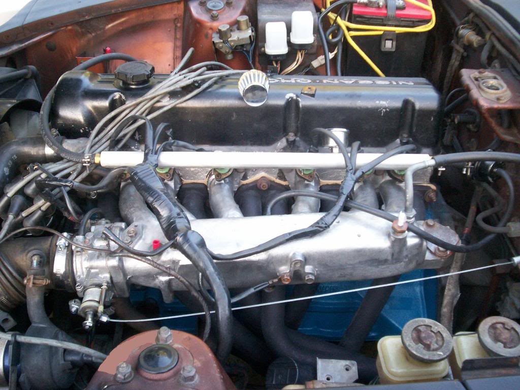

Hey guys the manual KA24 240sx TBs have ONLY the sensor, not the sensor and the switch like the auto cars. [So it only has the "oblong grey thing" not the Datsun 3 Pin EV1-looking rectangular connector]
How do I know this? I have one sitting in my garage.

Uh... okay
This is my KA24DE TB on my shaved 75 intake: [Notice both the TPS and TP Switch]
100_2449.jpg?t=1251472314
This is not my TB but you can see where the switch should be, but it's not there:
So it ONLY has the Throttle Position Sensor coming out, and you need the Throttle position SWITCH for the stock Z EFI. Hope this helps!
Just a little FYI - I did the swap for Cable linkage because I hate the stock mechanical linkage, and I knew I was going with MegaSquirt later on, which I am running on Flat Black now.

Also, please please don't forget to port out the manifold to match the TB opening, otherwise the throttle response will be really really choppy. I had to take it off again because I didn't do it the first time and the airflow is horrible when the 60mm opening hits the 50mm intake hole.
Here is my setup with cable linkage:
This is a very very old picture haha - my battery is in the hatch, I have a new motor, I converted the fusible links to Scoche fuse blocks, the engine bay is Flat Black now, and I'm running MS1 V3.0 MSnSE on a NA > T

where did you source that fuel rail from?
Old Aug 28, 2009 | 12:05 PM
flatblack's Avatar
Joined: Jul 2009
Posts: 121
From: Arkansas
Went to Pete's house and picked it up
It's a Pallnet rail with a Summit fuel pressure gauge.
