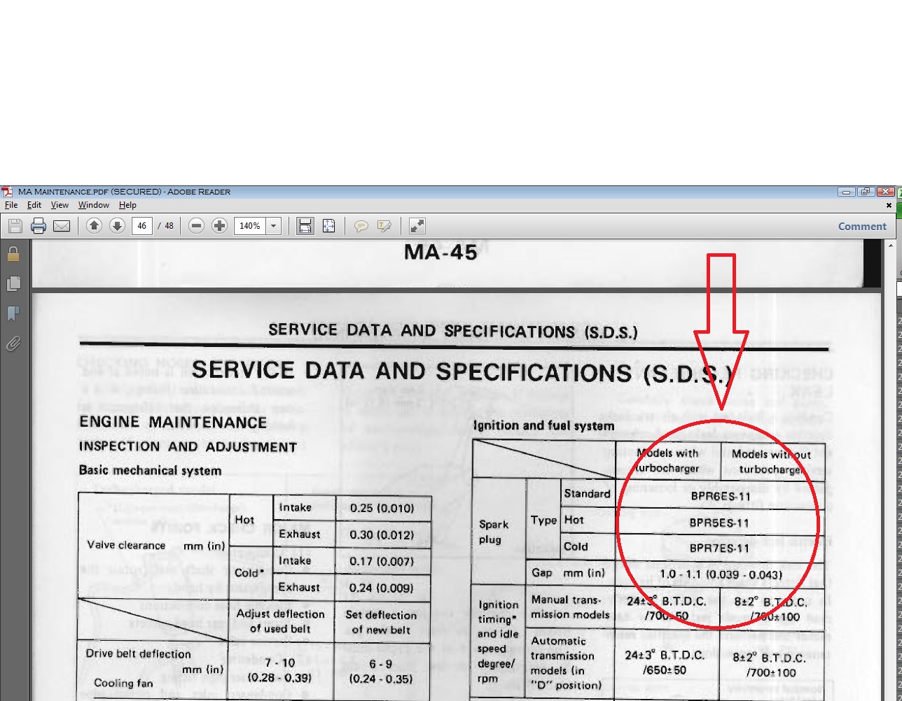

Just recently bought a 1983 280zx and was wondering what would be the best spark plug to put in this would like to put the recommended plug in it been seeing ngk is preferred plug if so what number should I get ? any suggestions appreciated....

Please download the free FSM from XenonS130 - S130 Reference as outlined in my Welcome PM.
Also see my FSM screenshot for you:

Turbo or NA? Typically you'll want to run the BPRE6ES-11 although switching to a 7 can help with detonation for the turbo cars.
Oddly enough of all the different spark plugs out there and after 40 years of many people playing with these engines the best plug for the L28E/ET is the one it says to use in the manual....
