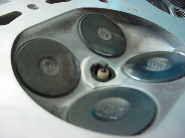

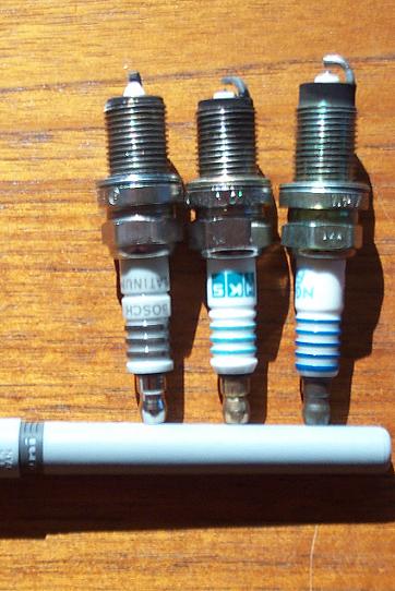

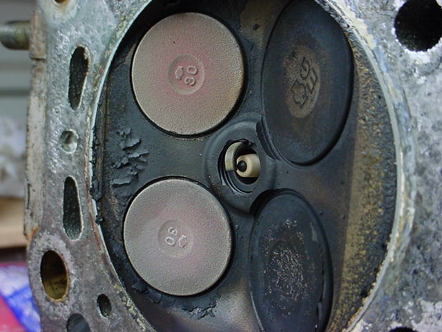

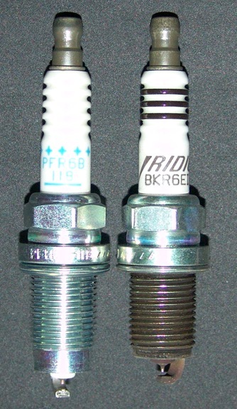

If I haven't posted this before, this would most likely be a good time to do so.
Have a look at the difference between the Stock Nissan NGK Plugs and all the others.
This is the reason why stock plugs should be used.
Enjoy.
EDIT:These plugs are are the NGK PFR6G-11B. For the TT's, the NA plugs DO NOT have the added length.
