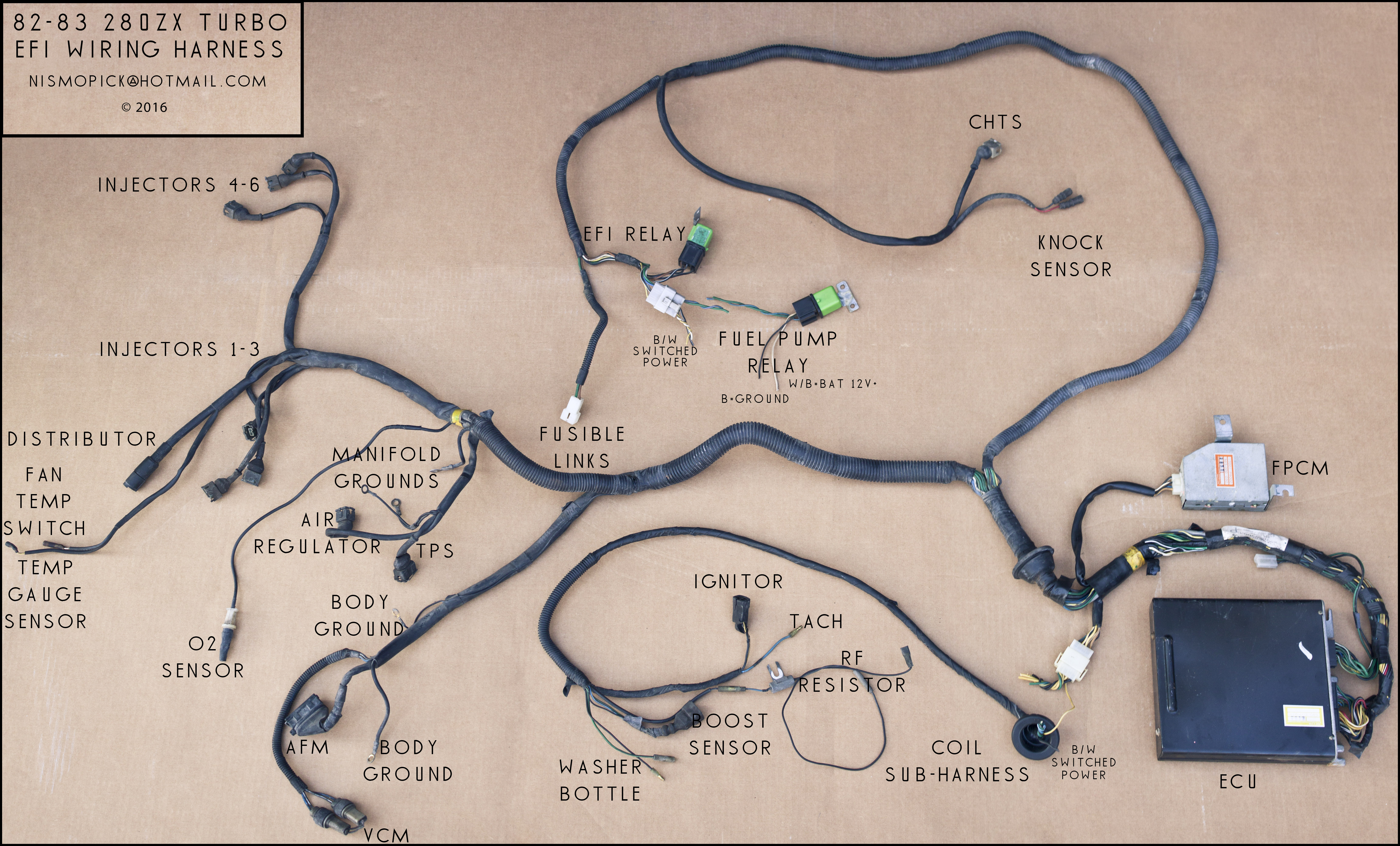

So you used a 81 280ZX Turbo harness? Pics would be helpful... And I can't imagine anyone doing an engine swap without the associated FSM, so please download it here: XenonZcar.com S130 Factory Service manuals
I've attached wiring diagrams.
Attached Thumbnails Someone with a 1981 280zx turbo please help.-81t-ecu-wiring.jpg   Someone with a 1981 280zx turbo please help.-82-83t-ecu-wiring.jpg   Someone with a 1981 280zx turbo please help.-pano-1-sized.jpg
